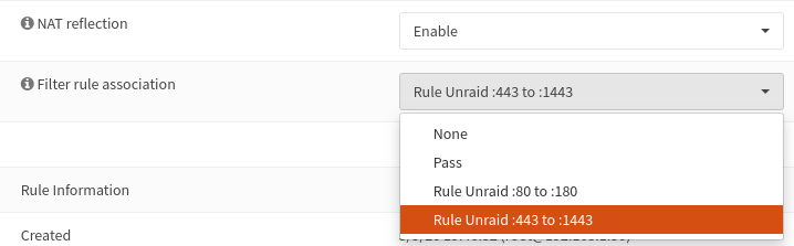

  9. Looks like this is a known thing with OpnSense. Implementing the changes recommended here appears to get things working. Basically in OpnSense, Firewall > Settings > Advanced enable: Reflection for port forwarding 1: 1 reflection Automatic outbound NAT for reflection NAT Then add your NAT Redirection rules, Firewall > NAT > Port Forwarding: WAN TCP * * WAN address 443 (HTTPS) <<UNRAID SERVER IP>> 1443 (HTTPS) Name WAN TCP * * WAN address 80 (HTTP) <<UNRAID SERVER IP>> 180 (HTTP) Name
  10. So far everything seems to be working. LetEncrypt has the certs all setup. Routing from my subdomain through to Nginx seems to all work. However, when accessing from inside my network I cannot access the subdomain -- the browser never loads the page. When I access outside the network, the login page loads. If I then switch back to access from inside the network, the login page is displayed. To me this suggests that some part of the login page is not available from inside my network, but is subsequently cached in the browser when accessed from outside the network. Which then allows internal access to function. I'm using OpnSense as my firewall, and have NAT Reflection turned on for both port forwarding rules. However, OpnSense options here are a little different to pfSense, so perhaps an alternate option is required? Particular OpnSense auto creates a Filter Rule association. Anyone have any suggestions for enabling access from within my internal network?
