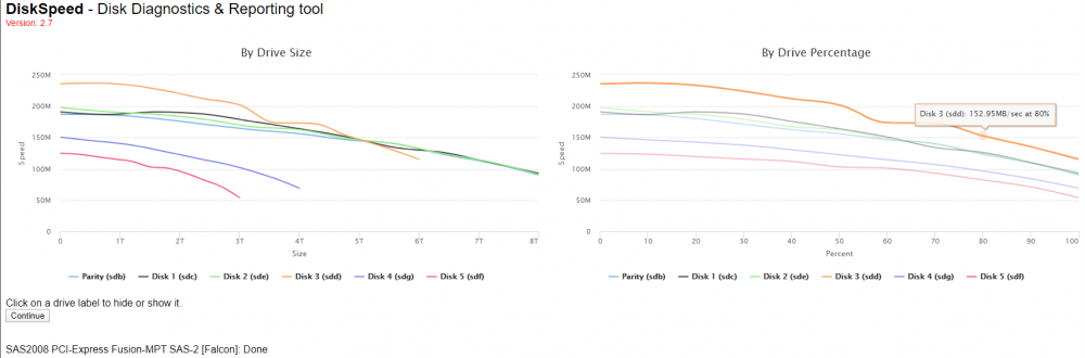

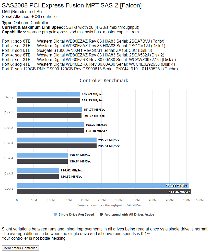

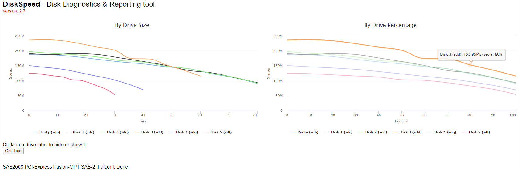

First I benchmarked the disks, which doesn't show anything special to my knowledge. No controller induced bottle-neck.
20-04-11.thumb.PNG.0663448b2eac165150aece9409c91207.PNG1024199119_20-04-11-controller.thumb.PNG.d23e5bff9c4117e30e1f4bca3e3945b4.PNG
The 2 old WD Green drives are obviously slower, so I though that maybe reconstruct write for the parity wasn't optimal, since any write on the array makes the other disks read. Switching to read/modify/write made no difference, so I went back.

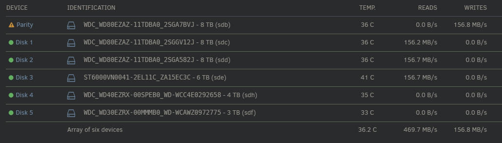

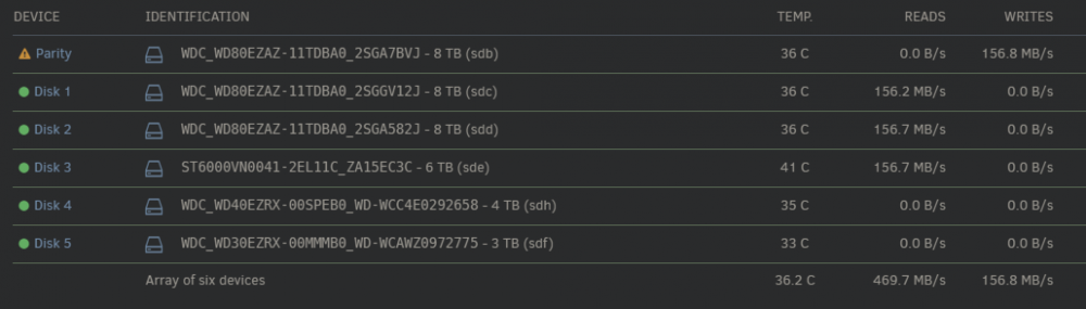

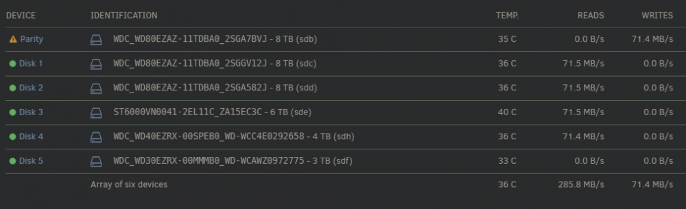

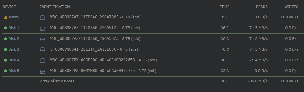

I just installed Dynamix stats, so there's not much data to inspect right now. But I took a closer look at the parity sync (still running). It just went over 50% (4TB) while I was watching, which is where WD Greens are not used anymore, and only the Reds and the Ironwolf are left. The speed instantly went from 70MB/s to 160MB/s. During the first hours, the speed was around 110-120MB/s. The last time I made a parity sync, it ended with a 120MB/s average speed. So everything looks normal and coherent with the Diskspeed results so far, regarding parity sync at least.
Before :
After :
However, writing from a Red disk to another, using read/modify/write mode so the Greens don't slow everything done, shouldn't I get better performance than 40-60MB/s ? It didn't seem to make any difference when I tried yesterday. I did quite a bunch of tests with disk to disk transfers before removing the parity, I doubt they where all impacted with the WD Green end of platter speeds.

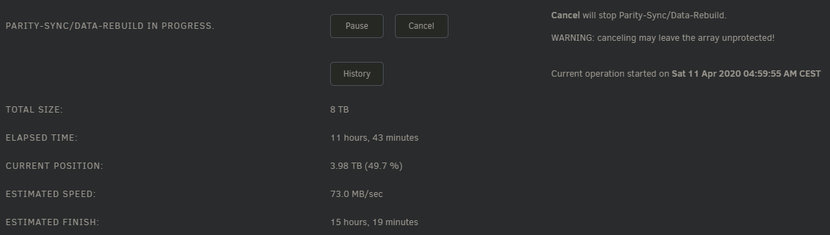

As the parity is done rebuilding and the array is protected once again, I checked various things :
- Reads to the array from ethernet are stable at 120MB/s (which is pretty nice).
- Writes from ethernet to cached shares on the array are stable at 80MB/s.
- Writes from ethernet to non cached shares on the array are stable at 80MB/s.
- Disk to disk transfers within the array start around 120MB/S and slowly stabilize around 50MB/s.
I've double checked, the files indeed land on /mnt/cache/ or /mnt/diskX/ as they're supposed to. I'm not sure how to simulate the varying speed of parity reconstructing writes, depending on the disks reading data and the position of the data on the platters.
That makes me wonder : are my array disks too fast to allow my cache (SSD) to make any difference on array writes ? The wiki page might be a little outdated on that subject, since mentioned speed and sizes are those of 2011 hardware.
