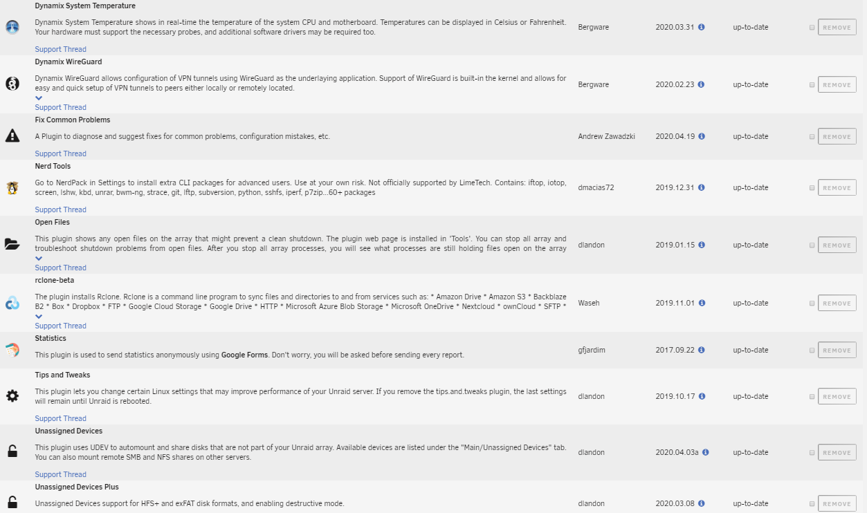

I have removed unbalance and a couple of others I am not using but still the same.  here is a list of the other plugins I still have installed, nothing that I would have thought required constant array access?

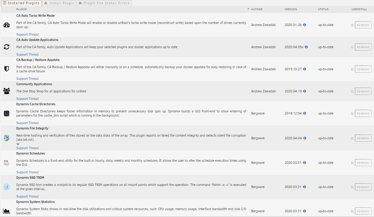

Cache dirs constantly reads drives. If you don't have enough RAM to keep the entries cached, it keeps the drives spun and reading.
Is this spec not enough to keep the entries cached?
Depends on the number of file entries. Remove it and see if the activity stops.
I am really sorry but remove what?
I know it is 2.am here but I am so sorry, I do not know what you want me to remove? in my head a cache dir is setting a share to use cache drive?
It's a plugin. Click on the checkbox then the remove button on the Dynamix Cache Directories entry on the Installed Plugin page that you posted a screenshot.
ok, sorry about that!

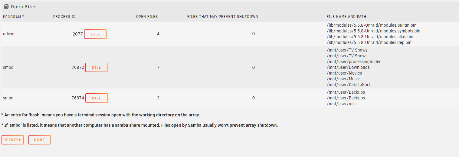

What shows up on the Tools, Open Files page?
UNRAIDSERVER_OpenFiles.pdf

Stop them and get the open files list.
According to that screenshot set, you have client(s) accessing the shares and files from across the network.

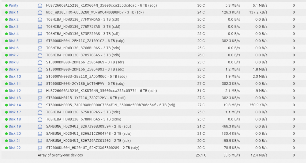

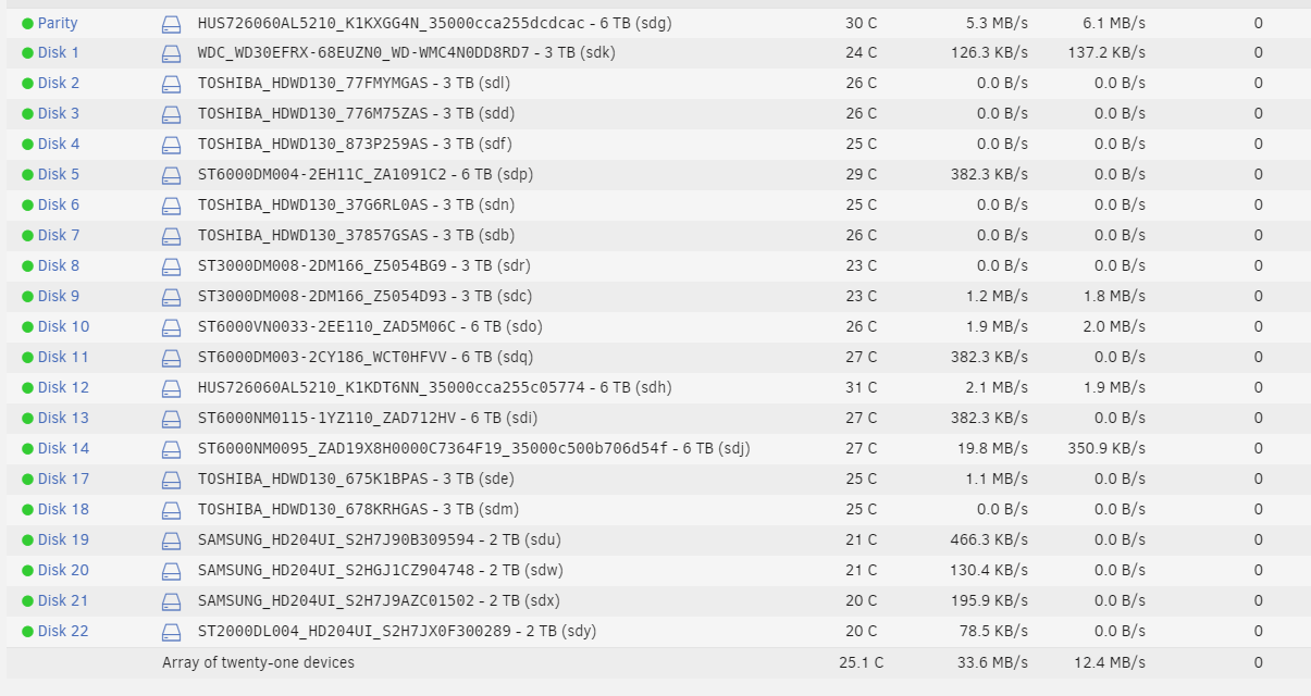

just seen a large spike and managed to capture it! what can be reading ALL of the disks??
Can you access the Unraid GUI from another device temporarily and disconnect the network from your main PC?

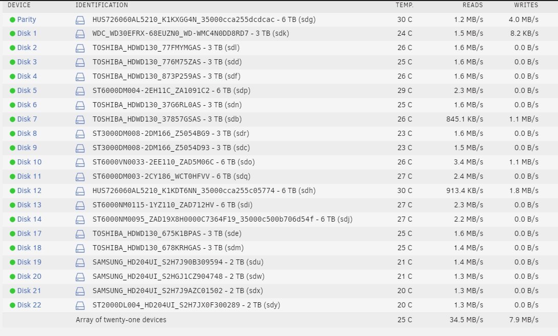

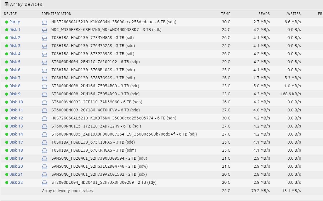

This is with the router switched off for 1 minute, nearly 80mb/s !
Edited by mbc0
