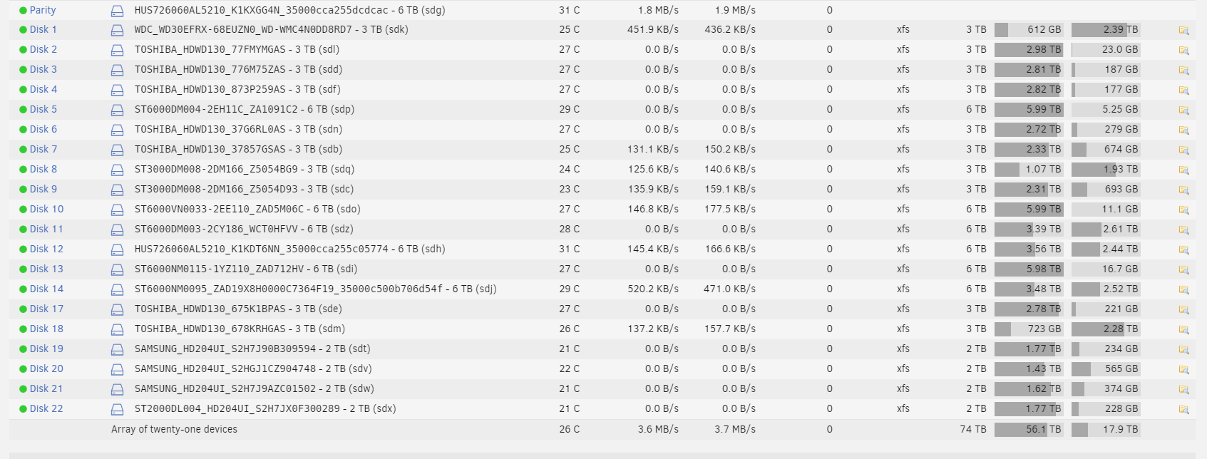

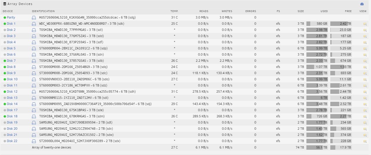

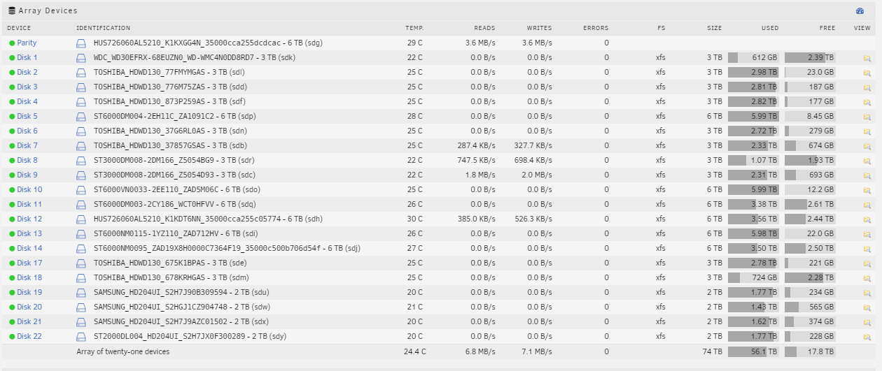

Hi @johnnie.black
I have really put everything into this but cannot work out what is writing to my disks?
I have stopped VM's
all my shares are set to use the cache
but still something(s) are writing to my array?
This is with the mover running.  it is moving a large mkv file from an Samsung Pro NVME to disk 1 on the array at 1.9mb/s surely there is something wrong with my setup? The other disk activity which I have no idea what it is but it is just a few kb/s is that enough to slow down that much?
unraidserver-diagnostics-20200422-2326.zip

You still need to find what was writing to the disks, did you stop all dockers?
Here is another diags with docker service & VM Manager stopped
As you can see there is still disk activity but how would I find out what it is?

Something is going on there, that array activity is not normal, what if you boot in safe mode? (still leaving all VMs/dockers disable)
