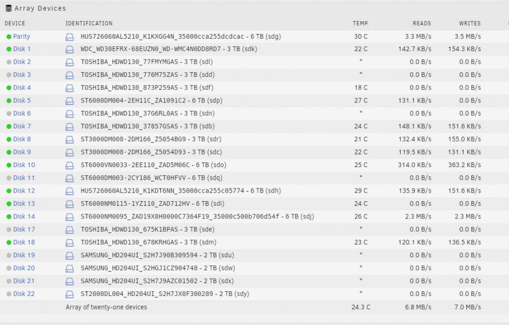

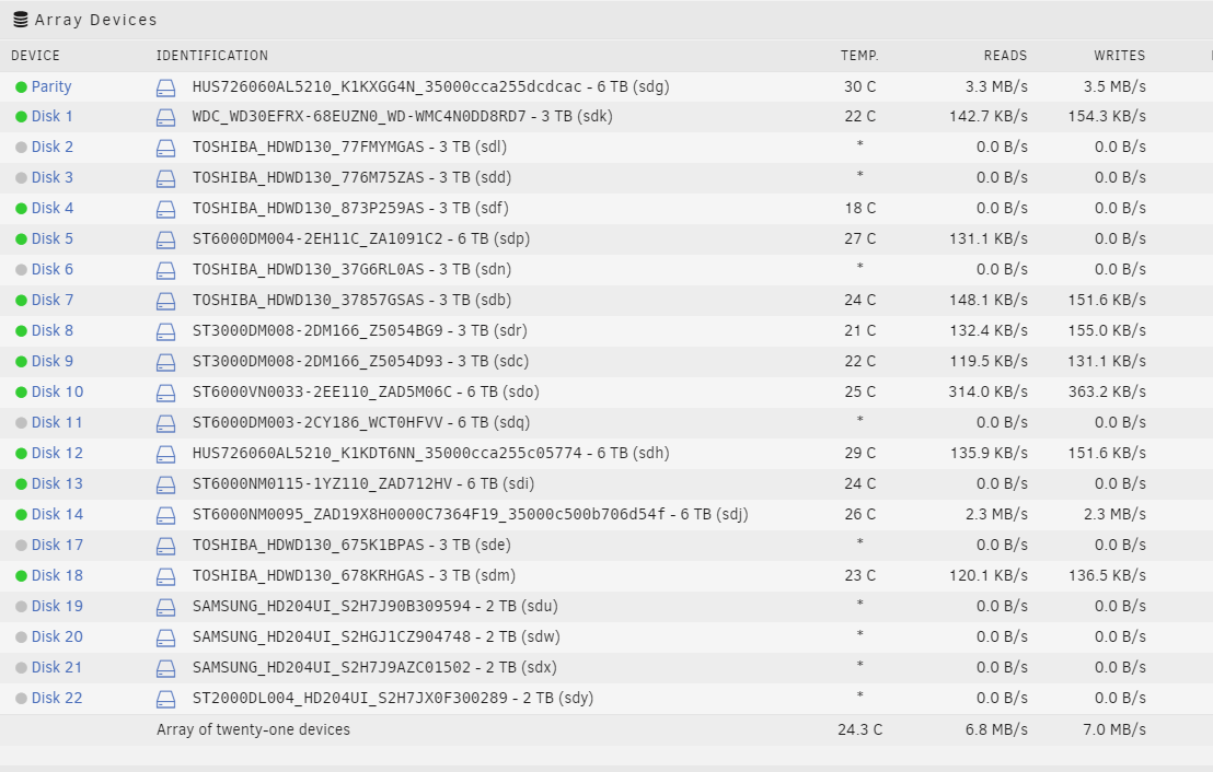

Note that the total read speed is this high because you have turbo write and it reads all disks when there are array writes, you just need to find who/what is doing that, what @jonathanmsuggested is the first thing to try, you can also boot with GUI mode to still have the GUI after disconnecting the server form the LAN.

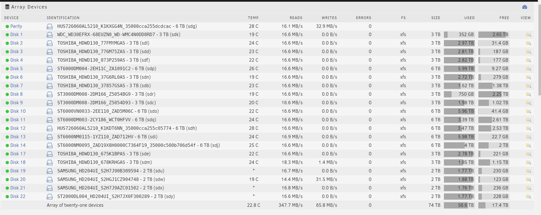

Ok, that makes sense, this morning just checking now I can see there are 9 disks reading/writing at different speeds and 11 not being written to or read from.  Am I right in that Turbo write is not active at this moment and they are 9 seperate writes?

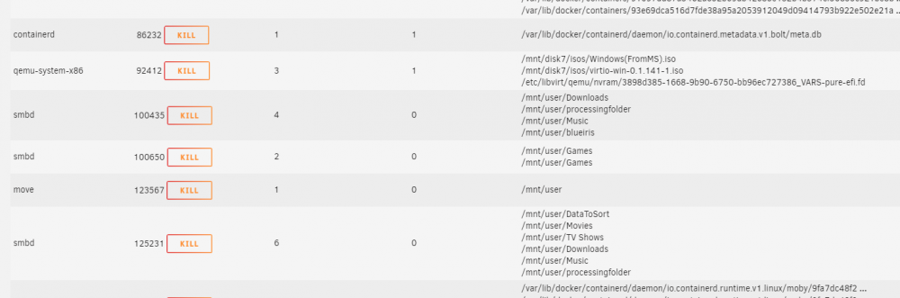

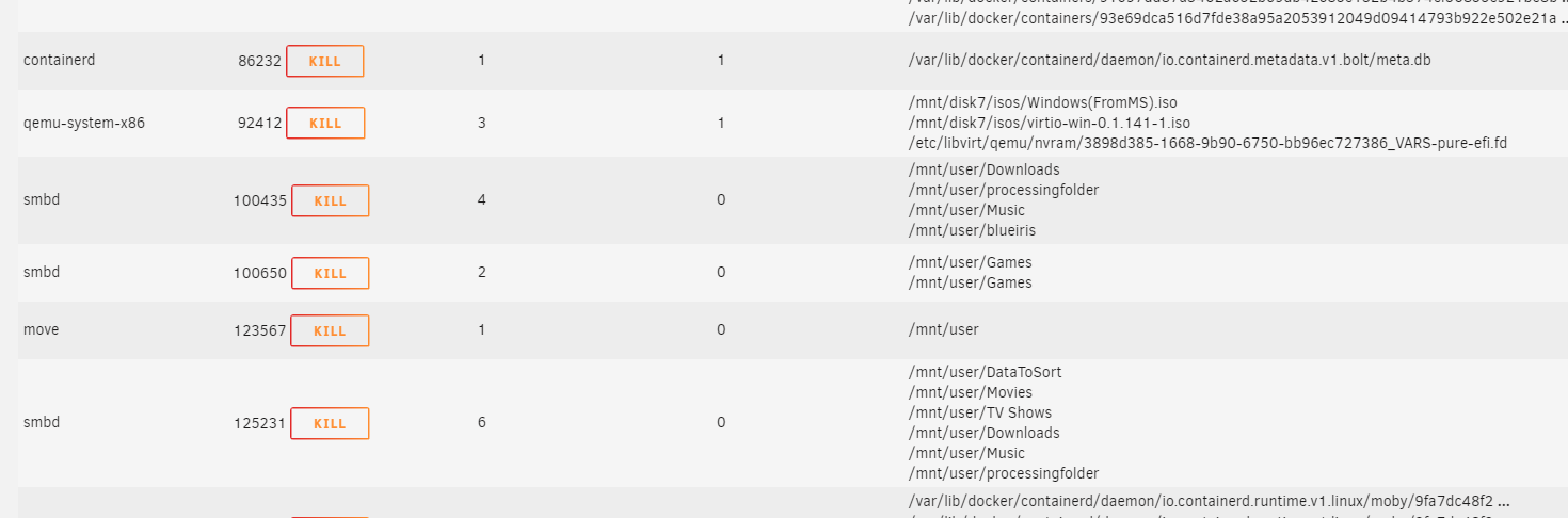

when the VM & Docker services are off, there is still a lot of activity, the only way to stop that activity is to boot into safe mode without the plugins running. My Desktop PC is the only other machine on the lan that can access the shares and I am certainly not doing that.  If you look at the second screen shot below, those are the open files I believe would be the cause of the activity shown in the 1st screen shot and this is what is confusing me
/mnt/user/Downloads is an old share that has not been used for a week or so, after following your advice Downloads are now going to an unassigned device.
/mnt/user/DataToSort
/mnt/user/Games
/mnt/user/processingfolder
These shares are all storage folders, I have not accessed them for weeks, nothing needs to access them, only me when I want something from them
Is there any other way I can find out what is calling on these shares when I know it is not me, there is nothing else on this network (no laptops, Pc's just phones, tv's satellite receivers, google homes etc)
Also  I see there are 2 process id's accessing the same shares? does this mean that there are 2 instances accessing shares?
