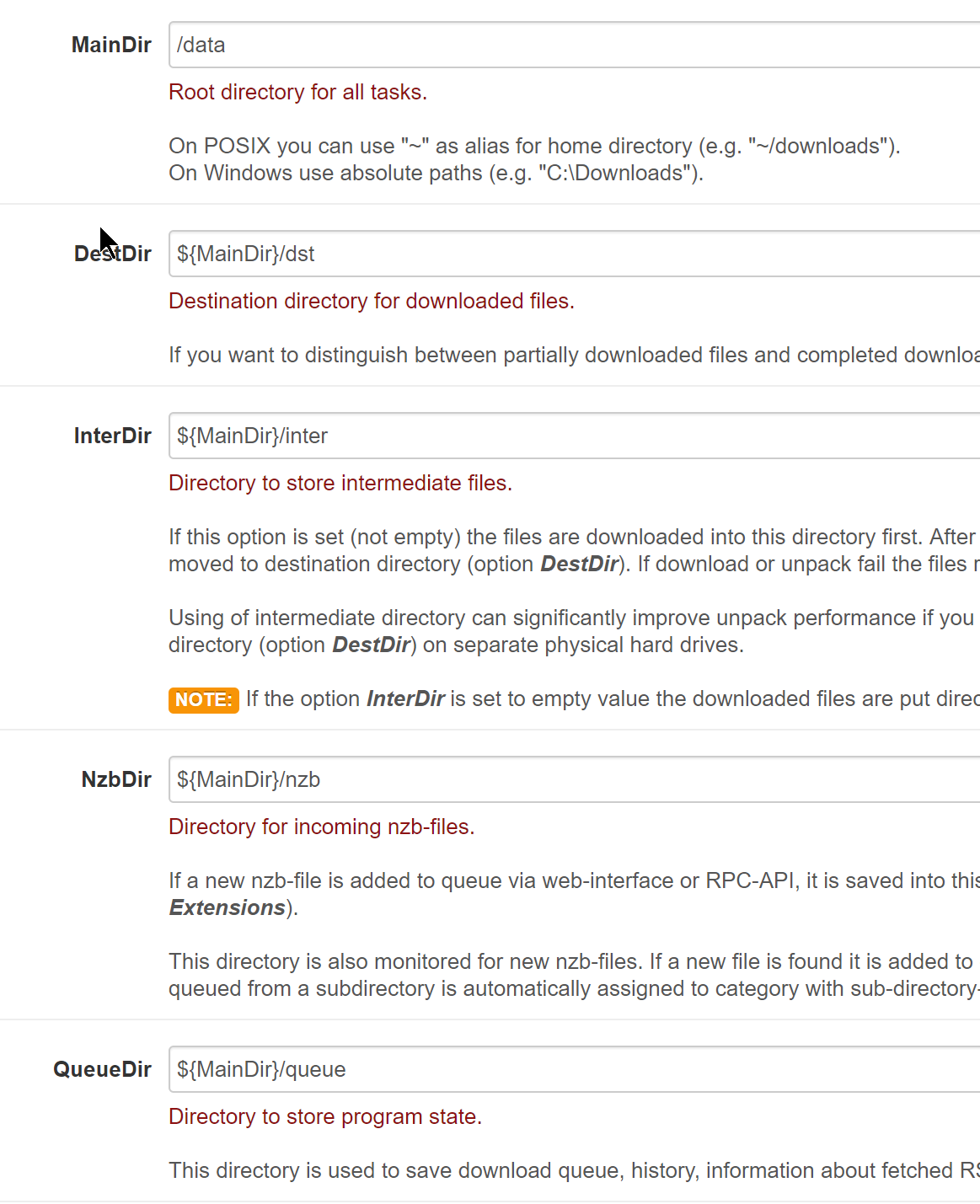

That looks OK too. Now here is the part where you can screw it up. Within the NZBGet application itself, go to Settings - Paths, and post screenshots of those settings.
Or, instead of the screenshots, you can post the contents of the NZBGet configuration file at
/mnt/user/appdata/binhex-nzbget/nzbget.conf
Let me know if you need any others.
OK, that looks good too.
