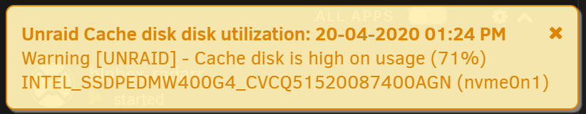

I am now seeing this message:
Showing 83% now.  I am wondering what happens when it fills up.  I can also tell you that I see the mover supposedly running.  Latest diags attached...

I stopped all containers and it is slowly going back down.  I have it running on the hour.  There were lots of downloads that nzbget was processing.
Docker image size is holding steady. You just need to figure out the best way to configure your system to use cache.
While nothing is downloading then of course mover can get things off cache quickly enough because nothing is being added. But running mover every hour isn't really the solution, unless you also intend to stop adding to cache every hour as well.
Mover is intended for idle time. There is simply no way to move from the faster cache to the slower array as quickly as you can write new data to cache. Running mover at the same time you are writing to cache just makes everything slower, including mover itself since it is competing with those writes for access to the drives.
A simple strategy would be to not cache any downloads or their postprocessing. Then obviously you won't fill cache.
But another strategy would be to cache the downloads, but send the postprocess results directly to the array. So in the case of NZBGet, you would download the intermediate files to a cache-yes user share, but send the completed files to a cache-no user share. This would also have the advantage of doing the postprocess reading from cache but the postprocess writes to a different disk, so those reads and writes aren't competing.
