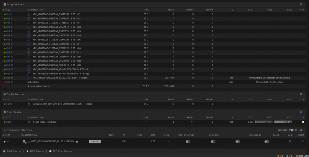

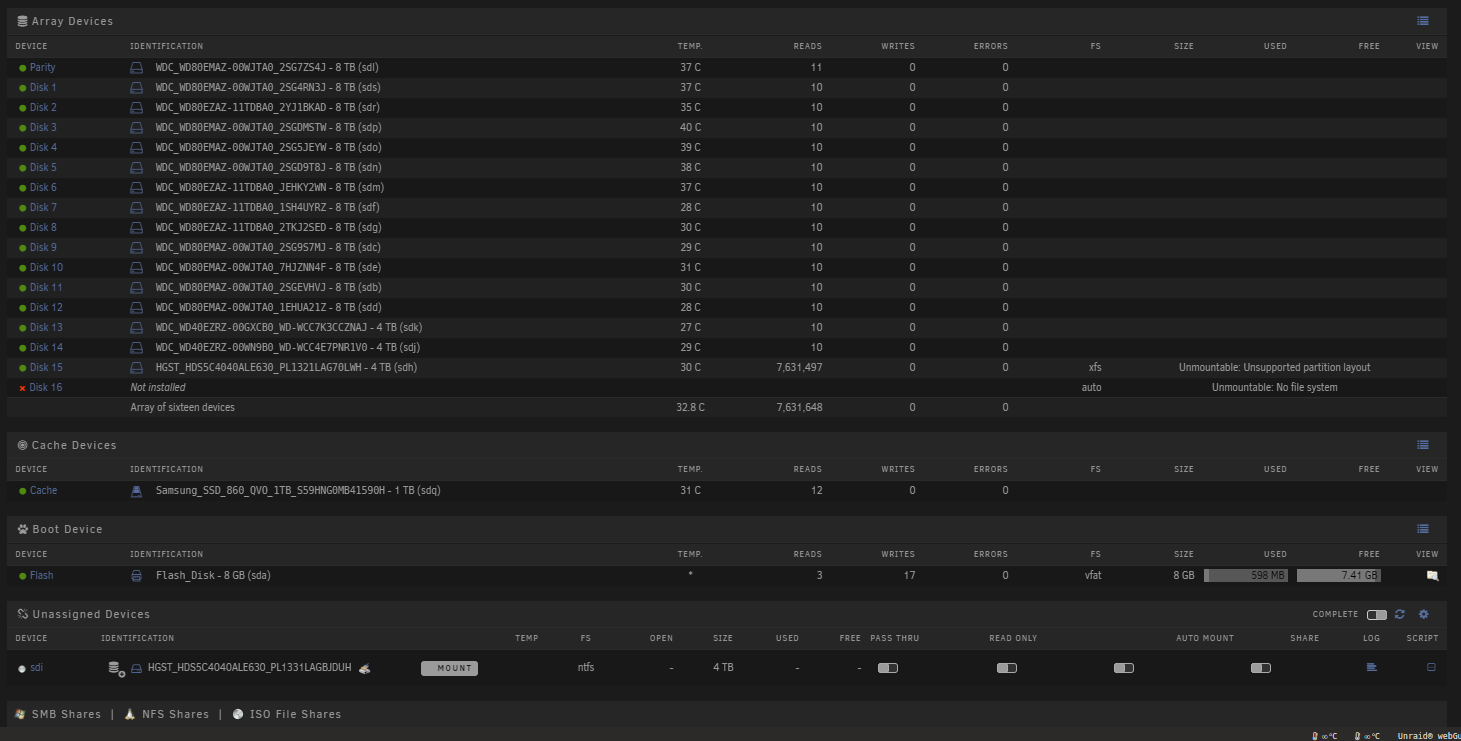

Just so we're clear, you want to use the new 8TB drive for disk15 and remove disk16, is that correct?
Also please post a screenshot of the main GUI page to see current array status and best way forward.

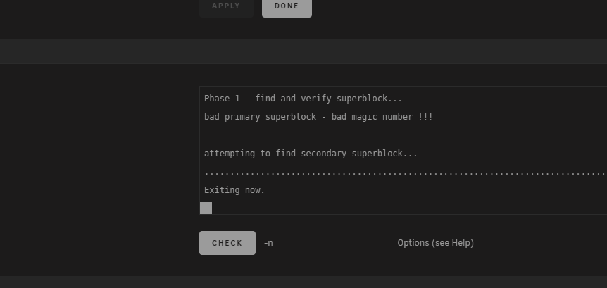

 Yes, If you guys think that will work I will do that if not I will stick with the 4tb I am attempting to check right now but its been running for 5 hours and now it says "exiting now" after it said
"Phase 1 - find and verify superblock... bad primary superblock - bad magic number !!! attempting to find secondary superblock........."
It did not give me any repair options
I have attached a screenshot of my latest main GUI screen please feel free to ask any other questions or if I can provide any logs or diagnostics that will help me solve this issue.
That confirms there wasn't a valid filesystem there, at least not xfs, and that's not surprising.

To rebuild disk 16:
-stop the array
-re-assign disk16 - icon should turn blue
-start the array to begin rebuilding
Any doubts please ask.
When it's done rebuilding post a new screenshot
11 minutes ago, johnnie.black said:
-stop the array

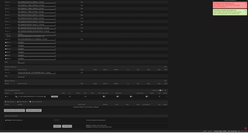

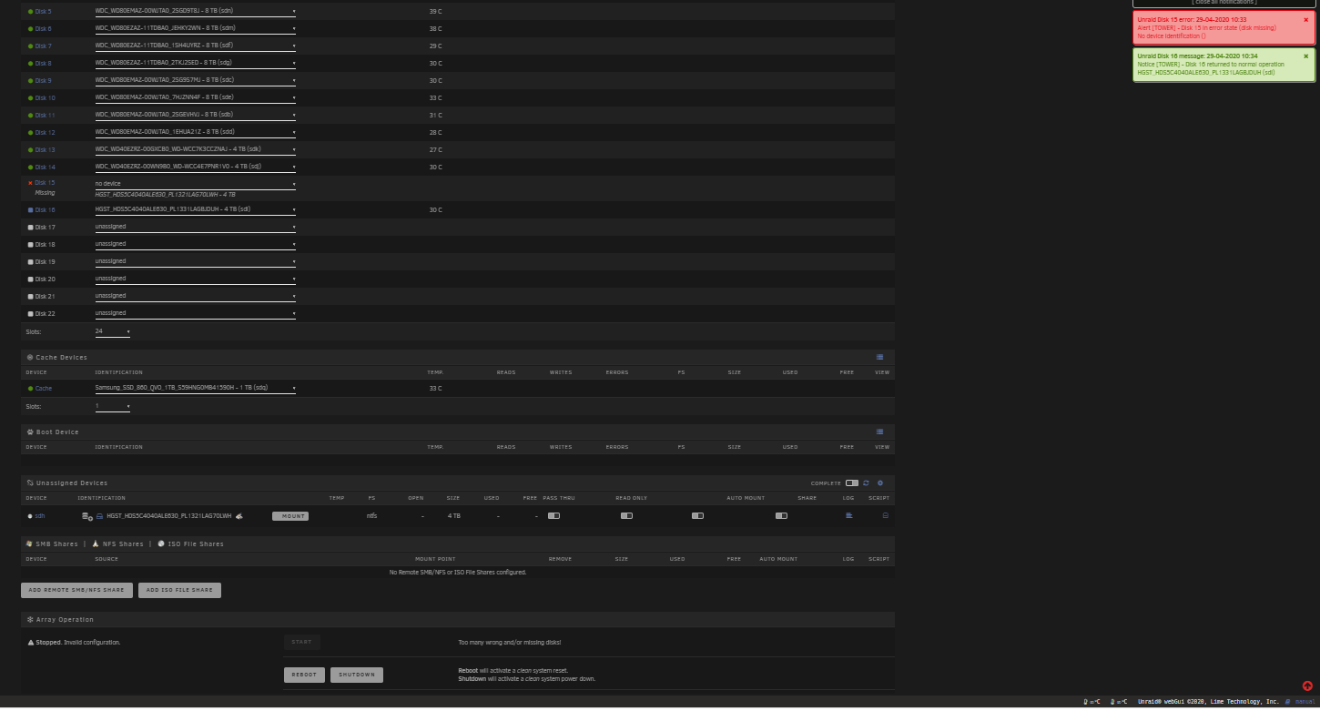

Ok thank you so much, I have stopped the array selected no device for disk 15 and selected the device for disk 16 (you were correct it turned blue) but now it will now allow me to start the array. The button is not active. It also says it is missing drive 15(expectd). I have attached screenshots
Thank you,
James
Please just do what I asked, I didn't say to unassign disk15, re-assign it, leave everything else as is and start the array.
I apologize I thought I was doing what you requested but I assumed incorrectly and then did exactly as you requested and you were right it has started the data rebuild for disk 16 and should be finished in 20 hours. I will post the results after it has completed.

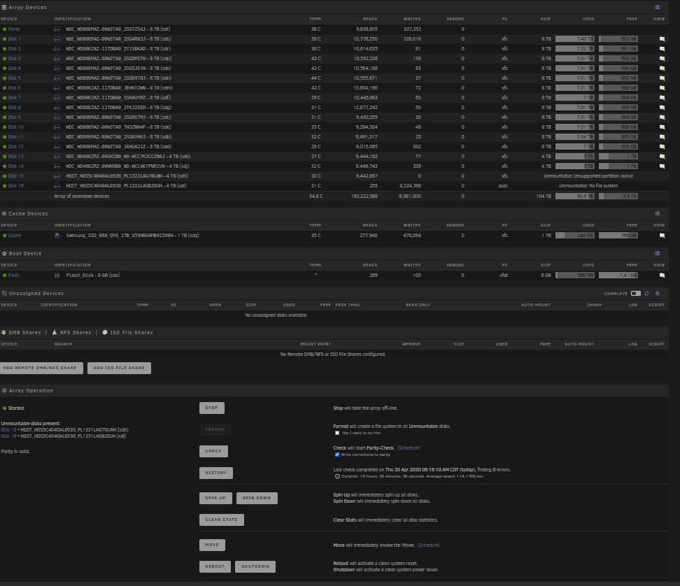

The rebuild has finished. Unfortunately I am getting the same error. I have posted screenshots and attached logs. Please advise. I did receive the new 8tb drive
early if that will help solve anything.
Thank you again so much!
James
tower-diagnostics-20200430-0733.zip tower-syslog-20200430-1233.zip
Now that the rebuild is done both disk 15 and 16 need to be formatted, next to the array start/stop button, there's a checkbox then press format.
