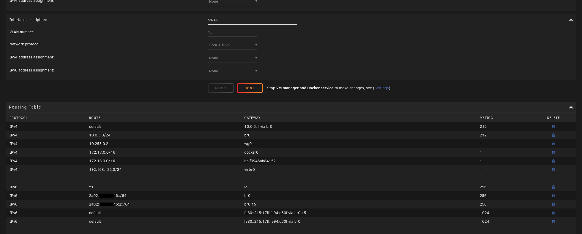

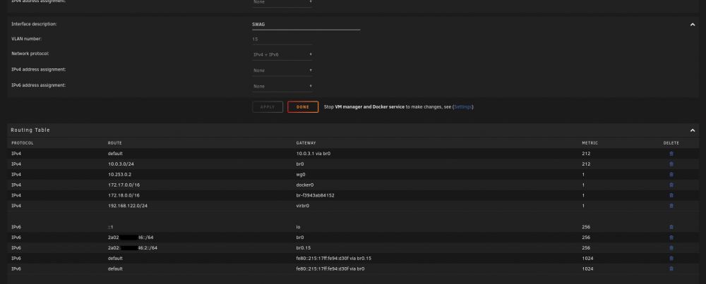

i am gonna kick this topic back in life now i switched from ISP. now i have IPv6 direct from the isp.
OPNsense works fine with ipv6. unraid still is that great, when at network settings are set to ipv4 + ipv6 non of my VM's have working ipv6, when set to ipv4 only, the VM's have ipv6 working great!
IPv6 on opnsense is setup with this tutorial (Dutch only): https://blog.firewallonline.nl/how-to-en-tutorials/xs4all-pfsense-opnsense-ipv6/

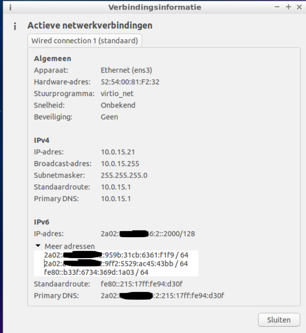

i have created a new VLAN just for the dockers that need ipv6 access. tested it by using a VM on br0.15 (this is the vlan) it got ipv6 working.
But Docker still wont work with it... i did use the information from the VM (and from my notebook)
rc.docker: no matching subnet for gateway fe80::215:17ff:fe94:d30f
the i change the gateway to the interface gateway (from opnsense) and boom: Docker container swag has made its first ipv6 ping to google.

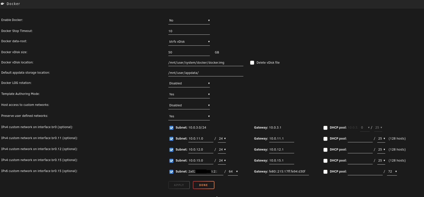

i found a way to have some dockers use IPv6 and the VM's.
what i did; unRAID it self is set on IPv4 only, i created i extra Vlan what is using ipv4+ipv6, did manual add this vlan to the docker setting (dhcp pool wasn't detected)
switched the dockers images what need ipv6 to this vlan and boom! its working!
setting unraid to IPv4+IPv6 resulting in no ipv6 on the VM's anymore... docker will work but it isn't always showing ipv6 then...
so, nextcloiud, plex, swag are working fine now :)
funfact; if i use the unraid terminal (or ssh) i can ping and lookup ipv6 addresses, its using the vlan to access ipv6... unraid itself doesn't have a ipv6 address, there is no assignment. command "ifconfig" shows that unraid does have a ipv6 address on that vlan 🤔
