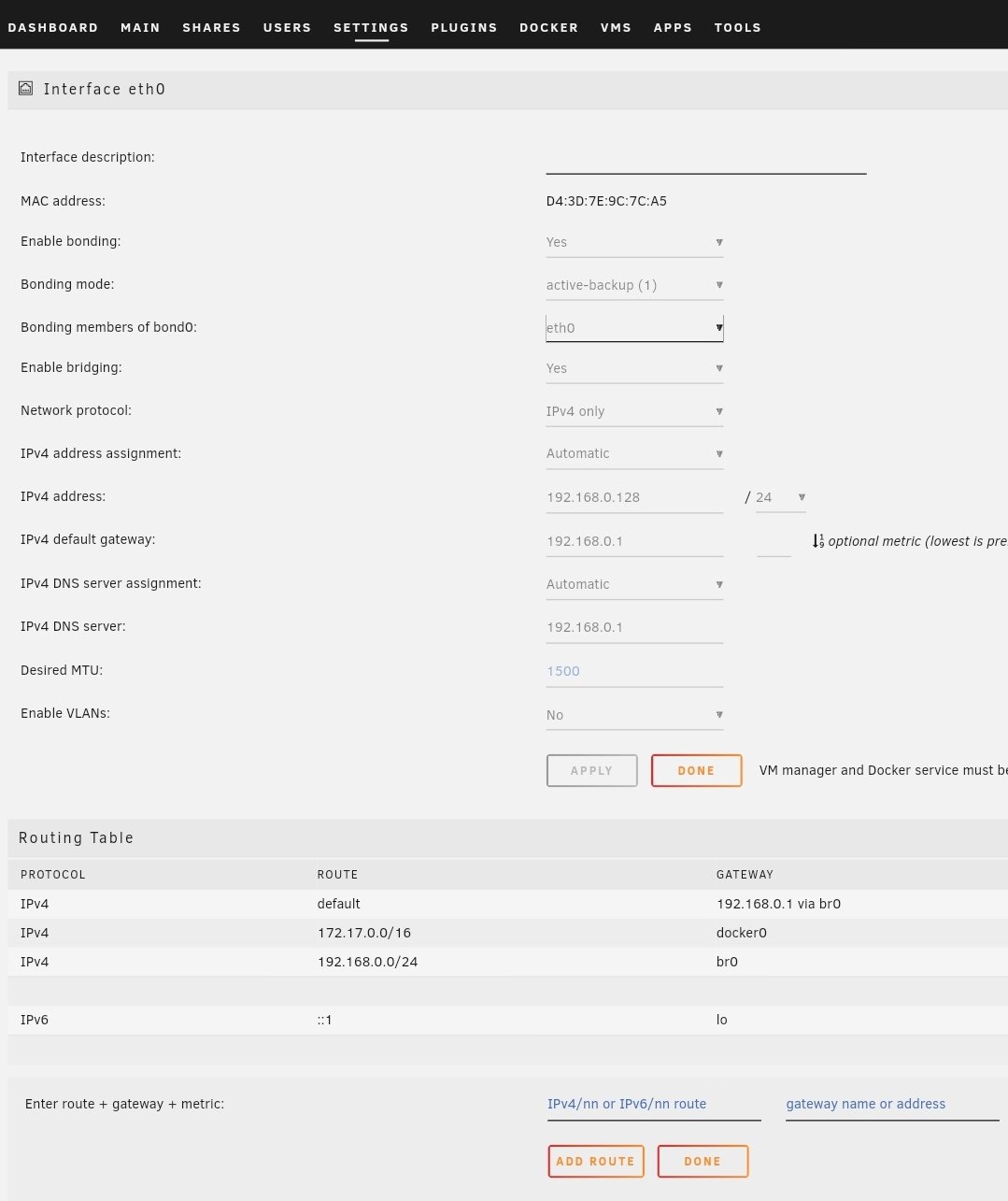

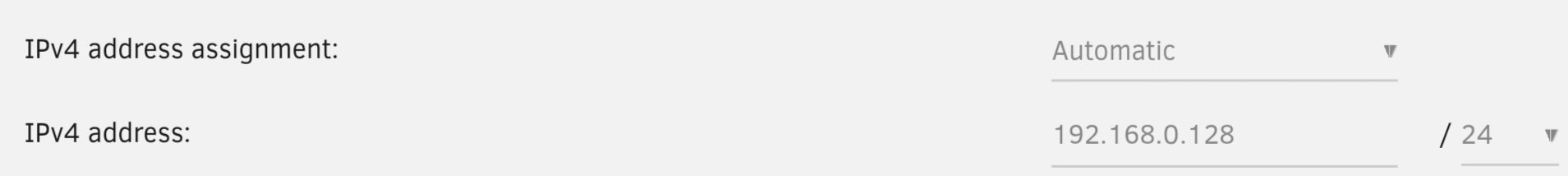

This is what I need to change in UnRaid to manual and whatever address, right?

BTW what is that /24? The range for other IP assignments? Should I leave it as is and change only the address?
It is the mask for the subnet.  Basically, it controls the size of the address space.  Look here for more information:
     https://en.wikipedia.org/wiki/Subnetwork
Just leave it set at /24 unless you know you have to set to some other value.  (If you have to ask what value to assign to it, you definitely don't want to change it!)
That's the CIDR notation of the IP address and /24 is the bit length of the subnet mask (255.255.255.0).  Leave it at /24 unless you have a reason to want to change it and know what that means.

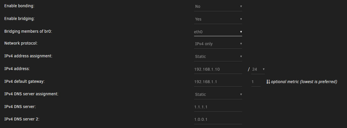

Here are my network settings for eth0.  I also set static DNS entries to a third-party (Cloudflare) DNS.  Some like to use Google DNS (8.8.8.8 and 8.8.4.4).  That is often preferred to just letting it default to your router/ISP DNS entries.
+1   Unraid should be able to use the router's DNS settings but sometimes things don't work like they should.  Supplying entries for DNS servers on this page will always guarantee the the server can get DNS service.  Always provide two addresses in case a DNS server is down.

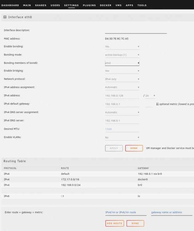

This is how mine looks atm.
1284897773_Screenshot_20200504-020220_SamsungInternet.thumb.jpg.a252a10cc467e9f1a09a1d2e9a9b0864.jpg

58 minutes ago, MacRaid said:
1. Change the IP in UnRaid, test.
You need to set the server assignment to static as well.  Don't leave it at Automatic.
