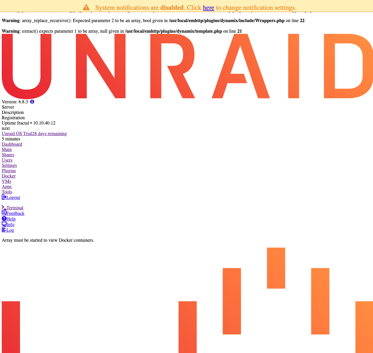

Attaching diagnostics and. screenshots (all my unRaid pages look like that now)
Thank you for any help!!
PS the first error that is covered by the banner is:
Warning: parse_ini_file(/boot/config/plugins/dynamix/dynamix.cfg): failed to open stream: Success in /usr/local/emhttp/plugins/dynamix/include/Wrappers.php on line 22
Some other ones from around the GUI:
DeviceIdentificationTemp.ReadsWritesErrorsFSSizeUsedFreeView
Warning: array_replace_recursive(): Expected parameter 2 to be an array, bool given in /usr/local/emhttp/plugins/dynamix/include/Wrappers.php on line 22
Warning: extract() expects parameter 1 to be array, null given in /usr/local/emhttp/plugins/dynamix/include/DeviceList.php on line 24
fractal-diagnostics-20200505-0742.zip

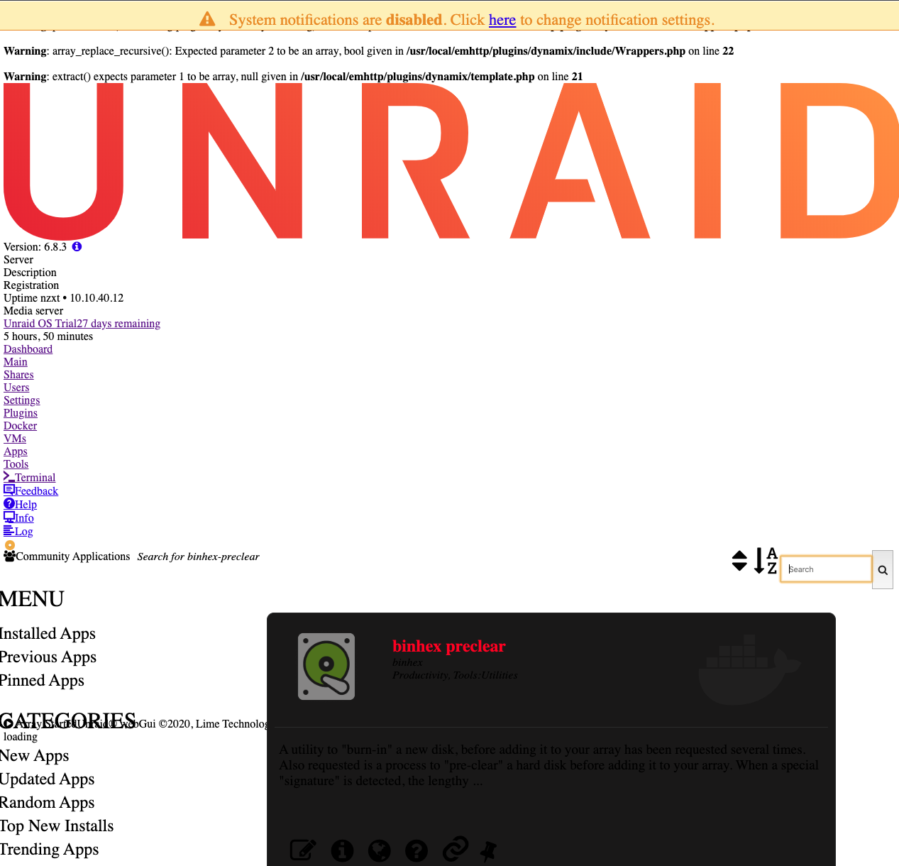

Unfortunately the exact same thing happened right after the binhex-preclear docker completed (successfully). As soon as I hit "Done" this is what I get:
1006261258_Screenshot2020-05-06at02_19_59.thumb.png.5e21152cd802a643cd72a8bdf546e7cc.png
Everything was solid until then...
Diagnostics attached without rebooting this time:
nzxt-diagnostics-20200506-0219.zip
