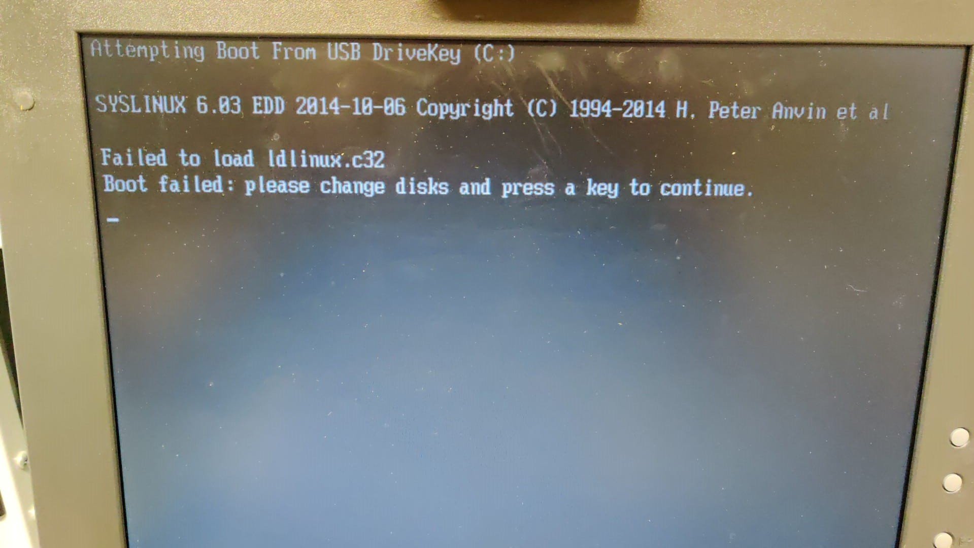

my unraid server have been using unraid for more than a year now with no problems, i had to take down my unraid server for about a month and this evening i wanted to set it up again, when i boot up ill get this error:
Failed to load ldlinux.c32
Boot failed: please change disks and press a key to continue
i can access my usb stick on a windows pc, but it tells me that the usb drive is damaged and it suggest that i scan and repair the usb stick, so i did and then windows tells me that it didn find any errors on the usb stick
i have tryed to use another usb drive
i have tryed to remove partitions on the usb i used to use and make a new bootable usb stick
all with the same result, the same error keep comming when i boot up.
any suggestions ? is the usb stick broke so i need a new one? if yes what usb stick is prefered to use?

What EXACTLY is the error and where is it happening?  What is the exact text of the error message?  (The construction of the sentence indicates that the error is happening on the laptop.)
my server (HP Proliant) boots up fine until it should boot from the usb, then this error come, i tryed to make a bootable usb for freenas, windows and some backup software i use for my laptops, and the servere boots up fine on that
