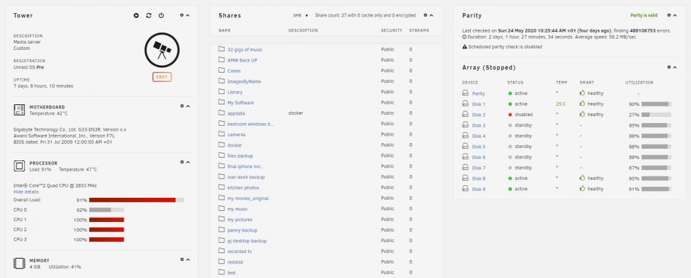

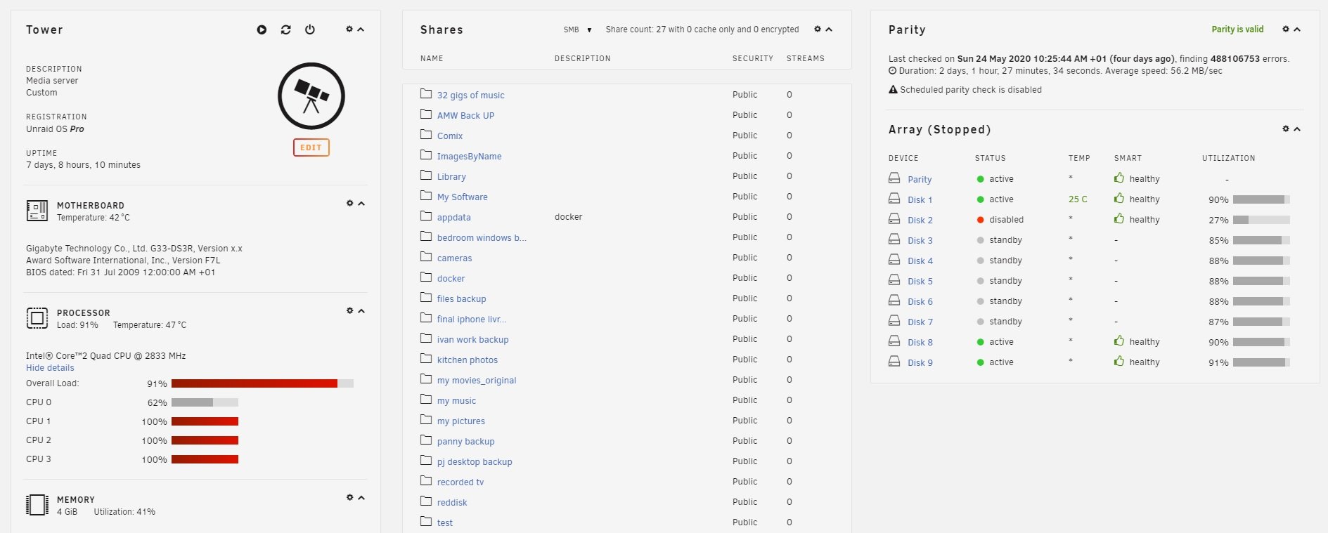

Things have gone a lot worse since the parity check.
I could not connect to the network drives so I logged on the Unraid Gui
- 1 drive disabled (drive2)
- 2 other drives with errors
- emby server stopped
- parity has over three and half billion errors
- CPU almost at 100%
- tried to stop the array but it's stuck on "stopping"
- wont' shut down, even with telnet connection and poweroff

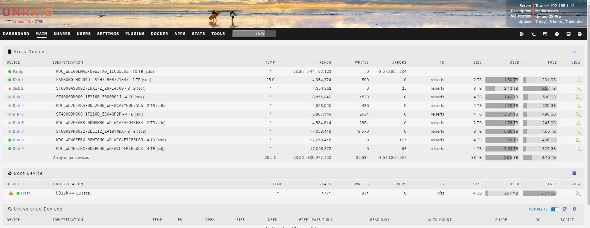

The problems continue it seems on my server.
tower-diagnostics-20200528-1733.zip
Rebooted, used two molex for each Norco cage this time.
Disk2 unmountable, no file system
Sent from my SM-A520F using Tapatalk
Array started with disk 2 disabled.
Not sure what to do next, I don't want to lose any of the data on disk2a7b5b89832e9e2809daac37ae190c25e.jpg
