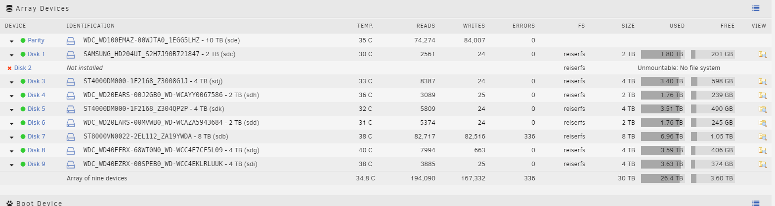

Ok replaced the cable, still no mounting and no drive access after starting the array.
Then I actually removed the drive physically from the server.
And rebooted it.
The UI still shows "Disk 2 not installed Unmountable: No file system"
And I cannot see a folder next to it.
And I cannot see data being emulated, or a drive being emulated.
No read errors now.
Diagnostics which I just donwloaded also attached.

What is UD? I have started the array in maintenance mode and clicked on CHECK for drive 2.
It says "running" below the following message "reiserfsck 3.6.27 Will read-only check consistency of the filesystem on /dev/md2 Will put log info to 'stdout'"
Failed to open the device '/dev/md2': Unknown code er3k 127
Just loaded the drive in unassigned devices, and I can access folders and download files.
So I guess next step is new configuration? This time I just calculate parity from scratch? Does this overcome the system file corruption?
