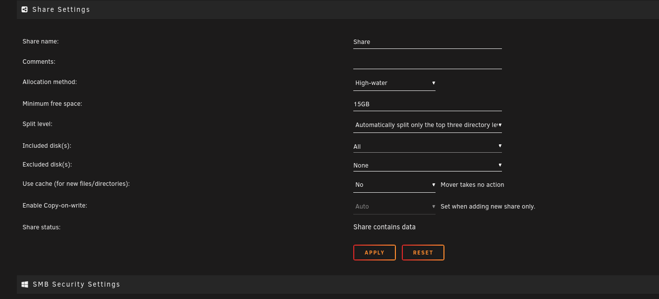

i have a server with 5 hdd's in there
3x 3 tb
2x 12 tb
1 x 12 tb is parity
1 x 12 tb is data
3 x 3 tb is data
(The 3 tb will be replaced later)
I am coping data from my old nas to the new unraid server via krusader docker.
i mounted my old nas and attached it to the docker.
in krusader im coping the data to the /mnt/user/[share]
while that works perfectly its only copying the data to the 12 tb data disk and not to the other hdd's
this is the settings im using for the share.  IF the share is the Top level. i have in there 1 directory in that directory i have directories a-z and in there also directories. So if i understand it correctly the Directories in the A_Z dirs will be split over the hdd's ?  But it does not seems to do that.
That is expected behaviour with the High-Water allocation method set on the share.     You might find this link useful in clarifying how that works.
i get it now Thank you.
