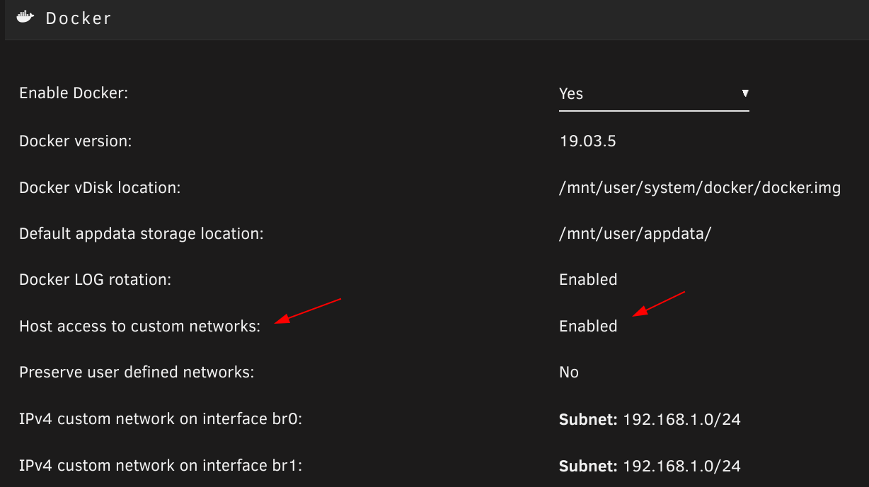

in case u have NC on a custom network and mariadb on host, did u enable the feature in docker settings so they can reach each other ?
and also allowed ip range for nextcloud user ...

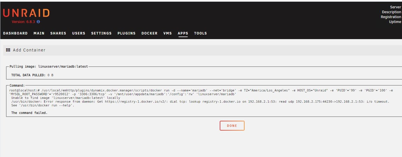

The problem happens when installing Mariadb, It is like there is no software available to download.
I get this info:

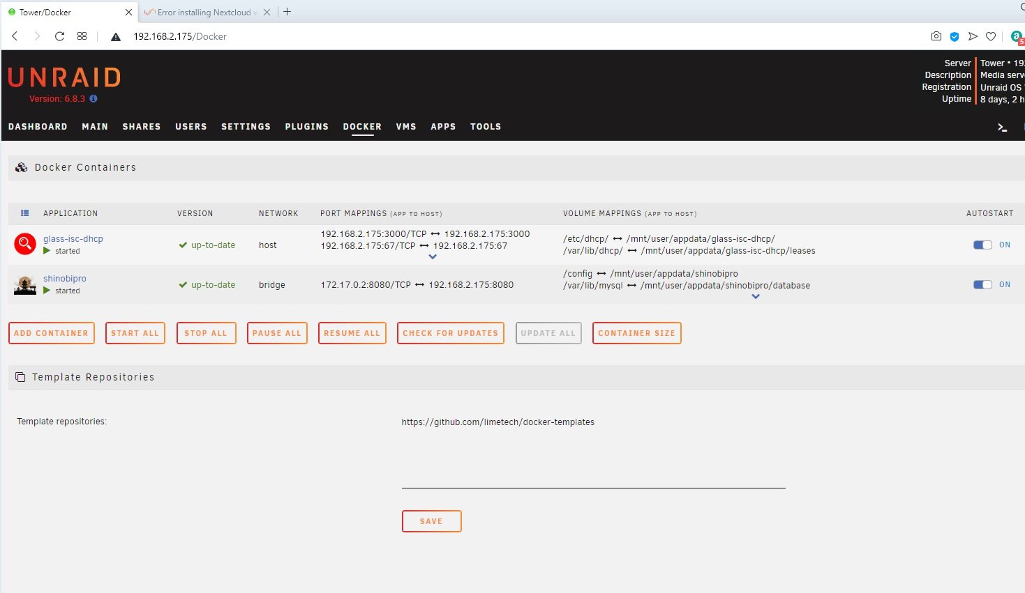

I have glass dhcp installed and I kind of think that I have installed it for that docker, but it does not appear on my dockers:

Update July 18th 2020
It turned out that my ethernet settings had only my router as DNS server, there is nothing wrong to have your router (or gateway) acting as your DNS, however in this case the IP addresses were not being resolved.
I had to stop the array  and then changed the NIC settings adding some DNS servers (ie. 8.8.8.8) and now it is working.
C' ya!
That has been driving me around the bend for weeks. Thank you! :D

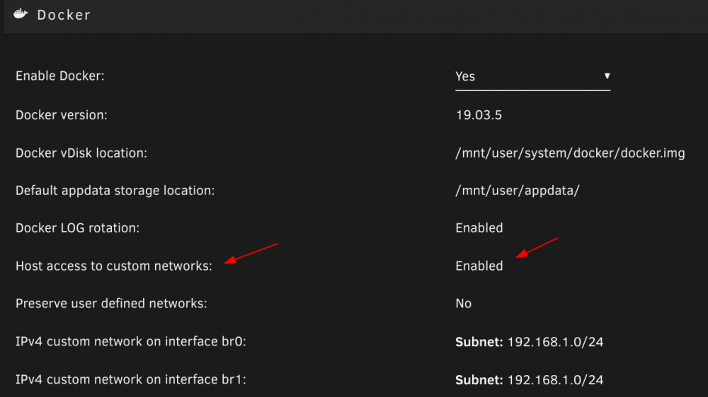

He also doesn't explain you need to stop your array while you edit the setting.... dockers (advanced view)..... Host access to custom networks:  ENABLE
Once you do that above your off and running :)
