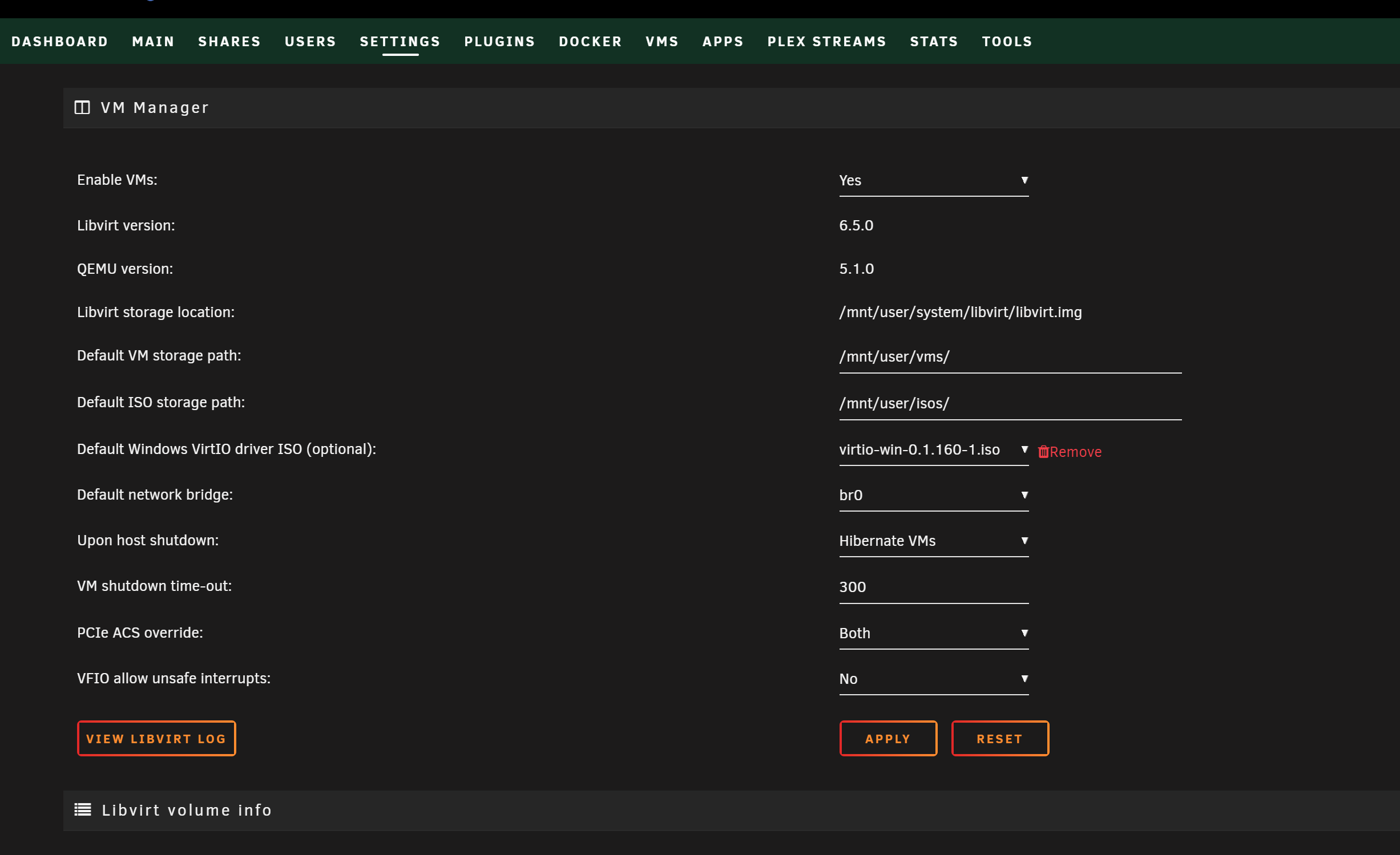

@jayg37  hopefully that helps.. and what i was talking about is the IOMMU  here is video.  but under Tools under system devices..
youll see right now probably all your devices are lumped together.
or if its enabled the IOMMU.
each device be in its own group and thats what you want it all seperated..
also if your sharing a USB controller sometimes that doesnt work..  so if you got 2 usb ports 1 using it in a on a different VM    and they use the same bus controller  it  causes issues
and it may need to be seperated more
so you want to enable ACS    in the video is older you can watch it to learn better.. and then you can see in the picture i have..  you dont need to edit the code anymore..  there is section in your VM Manager under advanced..  Enable PCIe ACS  and i set it to both,..  i forget what each one does but i just leave it set to both..
give that a try  too if u run into problems or just to learn it too
https://forums.unraid.net/topic/71675-video-guide-a-little-about-passthrough-iommu-groups-and-breaking-them-up/
hope it helps

I've upped my disk doze to 32gb and my ram to 4gb. iwasn't able to figure out the grouping you mentioned but will continue to look.
also there is section in unraid  you do the break up all the usbs soundcard etc  into different groups i forget what it that is at the moment  but give that a try upgrade ram etc

I think i figured it out.  So i installed a PCIE usb card then used a walk through on this forum to pass through the entire controller.  (My mobo only has one controller onboard) this consistently passed through the usb to my hassos vm.
This created a new problem as each restart changed the port the usb was located at. dev/tty/ACM0 or ACM1. I then used the info from HA forums to create a relative link to the usb device.
