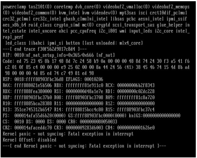

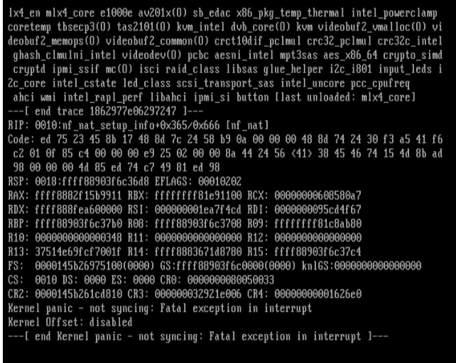

this is another kernel panic I had last week
Last call trace is related to the Mellanox NIC, see if you don't get them by temporarily running without it.

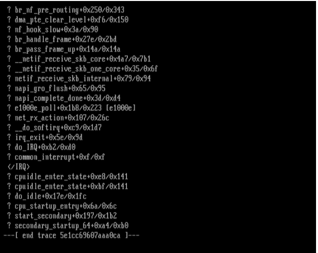

Woke up to this :(
Now it's the other NIC, possibly you have some custom IP config that is causing issues, did you check the link above about docker with custom IP addresses?
