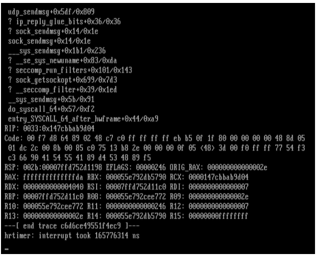

June 25, 20206 yr Author I will try safe mode tonight From your experience if it's a hardware problem, what might be reoccurring every 24 hours or so. For example a PSU either works or it's fried and doesn't provide power. But here it's not the case, the server crashed after 24hours of stability thanks a lot for all the help
June 25, 20206 yr Community Expert 6 minutes ago, DjSamLb said: For example a PSU either works or it's fried and doesn't provide power. Not necessarily, a failing PSU can cause stability issues.
June 25, 20206 yr What would be helpful is to know how long the server was operational before these issues came up and if anything changed in the week or so prior to the issues occurring. If nothing changed and the server all of the sudden started having this behavior, it really has to be something amiss with the hardware. Maybe dust buildup shorted something out or is causing heat or other issues. The PSU might be failing (a failing PSU could cause issues if it can't supply enough power or supplies too much power under certain situations). You can try running a memtest, though that is only 1 possible culprit. I wish I had more advice for you in this scenario, but unless you can point to a trigger that is causing the issue, it's really like looking for a specific needle in a pile full of needles ;-).
June 27, 20206 yr Author It seems the problem was the A/C unit in the server room switched to Heat lol Although CPU temps weren't affected I'm guessing it couldn't handle all the heat
July 30, 20206 yr Author Another Hang today managed to copy over the syslog before crashing any ideas? don't know where to start syslog
August 12, 20206 yr Author Turned out to be the vlan issue, used a dedicated network card for vlans and no more hangs!
