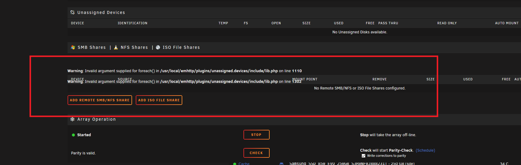

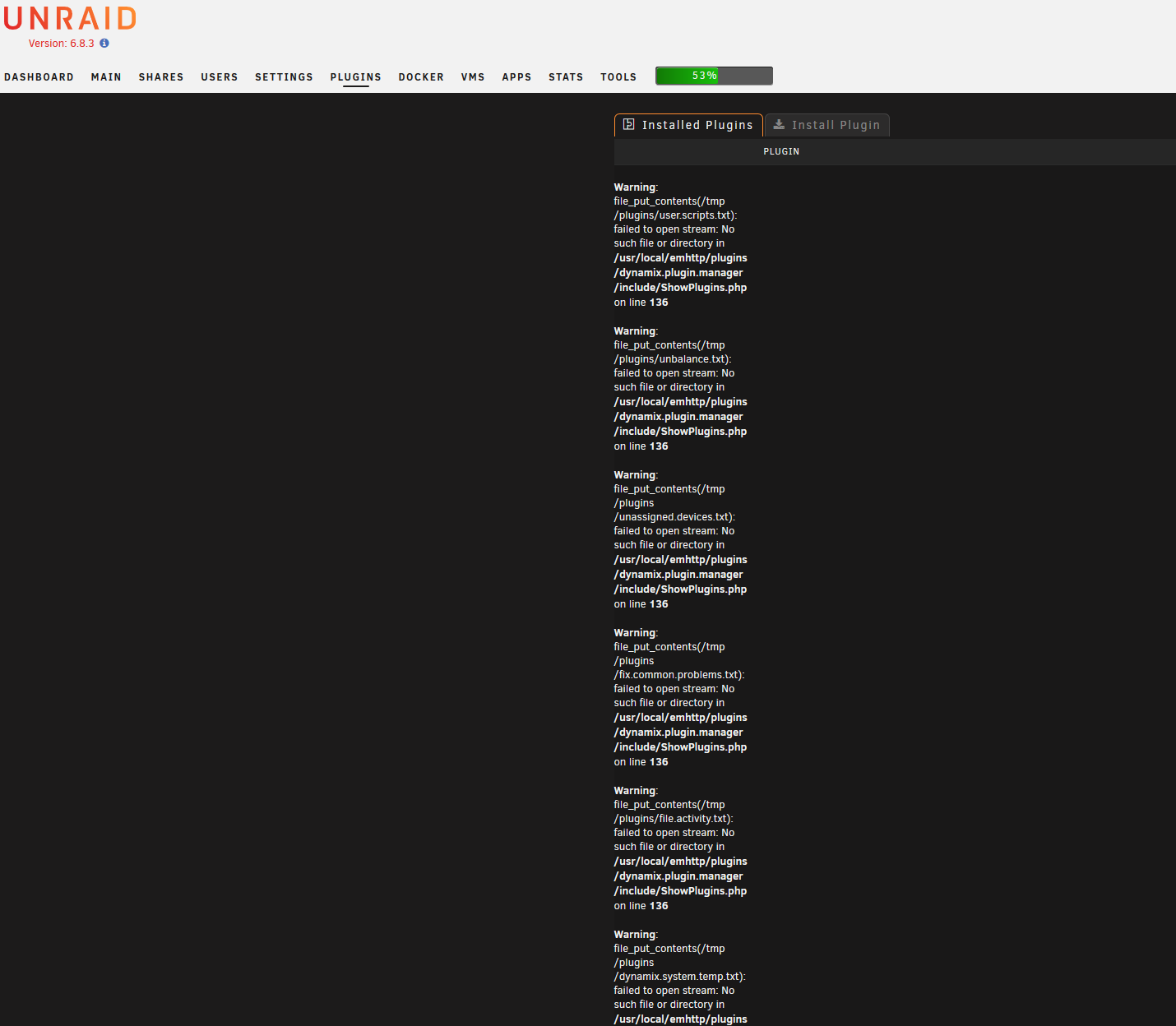

Multiple UI errors: "Warning: Invalid argument supplied" / failed to open stream:
As per the pictures. Anyone know what is suddenly causing these issues?
I haven't changed any user settings, any general settings, network settings or done any OS update or installed any new plugins and this just started happening out of the blue.

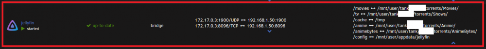

My best guess at the moment is that /tmp is mapped to a docker container (Jellyfin?) (or alternatively a user-script) for scratch space in transcoding and that container has deleted the contents of /tmp willy-nilly, causing the issues.
Ultimately a reboot is required to recover.

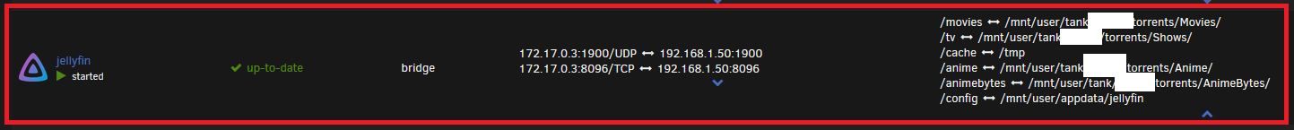

I guess it's Jellyfin, see pictures.
Shutting it down and rebooting the server doesn't seem to fix the problem. Have I messed up something in the build?
I changed also the /tmp flag to another folder in JF and I'm still getting these UI errors too.

Instead of /cache <--> /tmp, do /cache <--> /tmp/jellyfin if you want.  You'd still need to reboot for anything to ultimately take effect.

/tmp is used in every OS by multiple programs.  This is all OK.  What isn't OK is if program X deletes the tmp files from program Y.  Since JellyFin as far as it was concerned had exclusive rights to /tmp (as per the screenshot), it felt it can delete whatever it wants.
