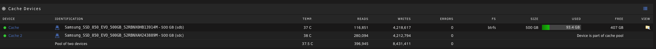

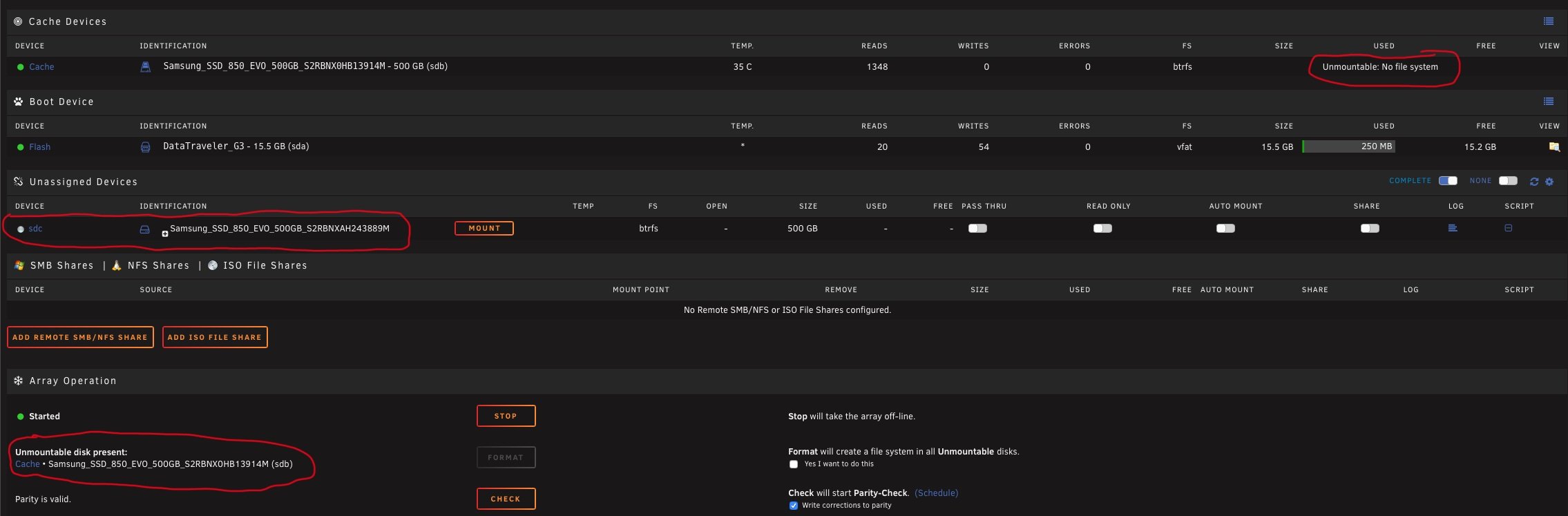

dont know how it happens, but one of my cache drives disappears after a reboot.
After another reboot it's back but only as a "unassigned device".
The other cache drive says "unmountable - no file system"
I make a sneak what happens when stopping the array and attach the drive as a cache again --> Warning: All data on the drive will deleted!
Now I'm stuck.. what to do now?

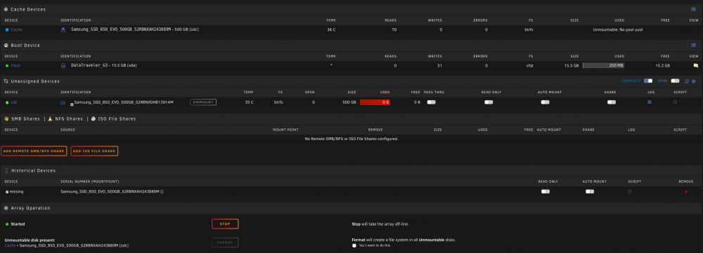

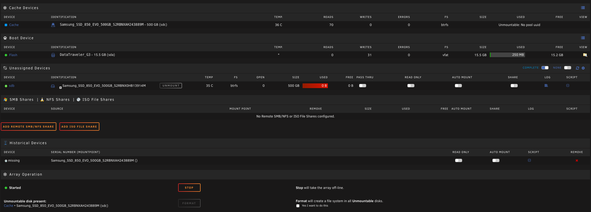

@johnnie.black - done.
But now I get the error "Unmountable: No pool uuid" (see screen - new diagnostics attached)
1756309123_Bildschirmfoto2020-07-02um16_27_20.thumb.png.90b710bd180eff6fbf32e47ea73ebc24.png
Additionally - the other cache drive (sdb) is now "un-unmountable" as you can see in the screen. Everything greyed out.
And I get those two mail-warnings:
First:
Event: Unraid Cache disk error
Subject: Alert [V1EW-S0URCE] - Cache disk in error state (disk missing)
Description: No device identification ()
Importance: alert
Second:
Event: Unraid Cache disk message
Subject: Notice [V1EW-S0URCE] - Cache disk returned to normal operation
Description: Samsung_SSD_850_EVO_500GB_S2RBNXAH243889M (sdc)
Importance: normal
v1ew-s0urce-diagnostics-20200702-1629.zip
Edited by Maddeen

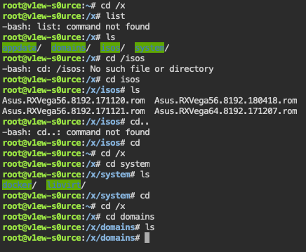

@johnnie.black - seems that I'm a lucky boy. (see screenshot) :)
But - as you can see in the screenshot - my cmd-line skills are pretty shitty. 🙈
So before I self-destruct my luck ... is this the correct command for copying the folders to my array?
cp -r /appdata/ /mnt/user/unraid_backup/appdata/
cp -r /system/ /mnt/user/unraid_backup/system/
cp -r /isos/ /mnt/user/unraid_backup/isos/
Actually there is no folder "appdata, system or isos" in the target folder "unraid_backup" - so does it work as described or do I need to first create the folders at the target first?

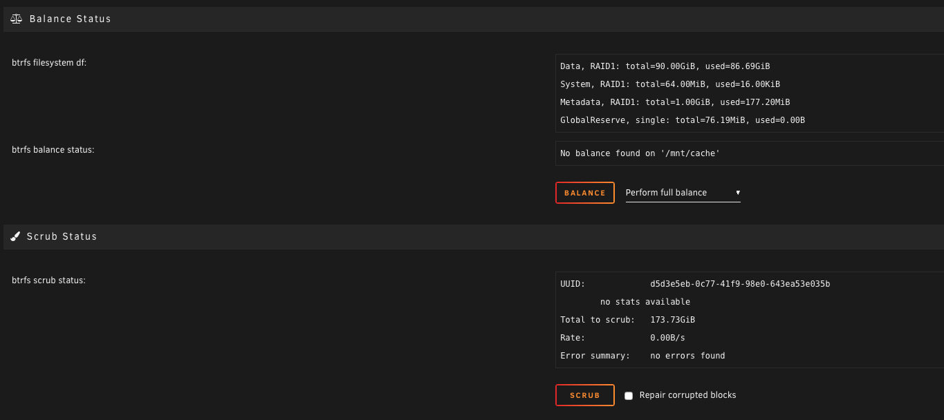

@johnnie.black - weird -- that's the correct wording :)
No restart since yesterday - here's the new diagnostics file
But what I dont understand is this information (screenshot) ... why it says that there is only 90GB (total) space and 86GB used (I've got two 500GB SSDs as cache drives at RAID1)
And below it says "Data to scrub = 173GB" ...
and - to fulfill the confusing - at the "Main-Tab" it says, that the cache drive is used for about 93GB. (screenshot #2)
All those information doesnt fit or aren't consistent - imho...
That's normal with btrsf, it's the the allocated size, btrfs first creates empty data and metadata chunks before writing data there, so there are 90GiB of chunks on disk and 86GiB are used.
raid1, so 86GiB x 2
Because the GUI uses GB, not GiB, 86Gib=93GB
