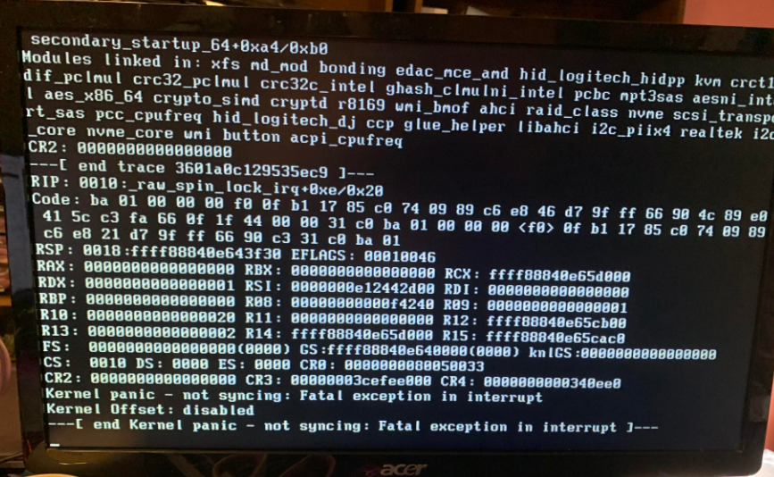

Also just tried Unraid v6.8.2 with the same freezing problem happening right away.  Sometimes it'll freeze right when i try to start the array, other times when I try to start Krusader, or if I happen to get as far as starting Krusader, when I start copying files it'll freeze.
Sometimes I'll see the kernel panic on the screen like below, other times it just freezes and the screen is sitting at the login prompt.
