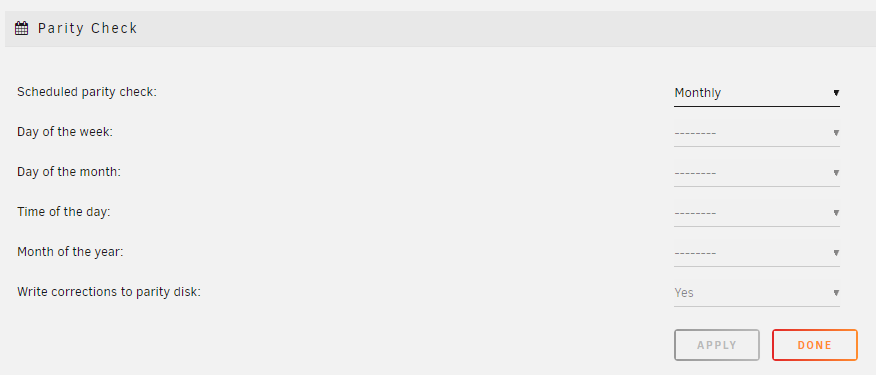

July 9, 20206 yr Hello, I currently cannot change my scheduler settings. If I select another value, the button "Apply" is grayed out. This applies to the parity check and the mover settings, for the speed test the button is enabled. If I try to change the value from Monthly to Weekly during the parity check, a new tab with the URL "http://tower/update.php" opens immediately and nothing else happens. Currently I use the Google Chrome Browser, but I have the same phenomenon in Firefox and in Firefox in incognito mode. Therefore I restarted the server a day ago, which unfortunately didn't help either. tower-diagnostics-20200709-1740.zip

October 13, 20205 yr On 7/23/2020 at 1:24 AM, dlgltal said: I'm having the same problem, can't change any item on scheduler page. I've rebooted, still not change. Currently running 6.9 beta 25. Tried downgrading, still no change. Same for me. Eeverything is greyed out except the first one: "Scheduled parity check:". If i chang it to daily, monthly ect everything else stays grey. Updating, rollback, Maintanance... nothing helped so far. On 7/23/2020 at 5:39 AM, trurl said: The actual cron files for the scheduler are in /boot/config/plugins/dynamix. Maybe something broken there. Seems the config is missing for me. There are .cron for docker-update, monitor, mover, plugin-check and unraid-check but no scheduler. 🤔
October 13, 20205 yr Community Expert 20 minutes ago, Tsumitsuki said: Same for me. Eeverything is greyed out except the first one: "Scheduled parity check:". It's a known issue, update to -beta30
