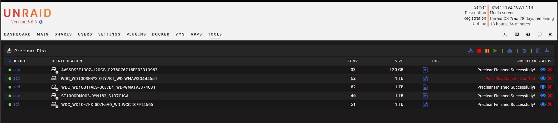

So far I have installed all the drives in my case and did a PRECLEAR on all of them.
Found that all my drives were severely overheating. Between 56-68C.
So before I add the parity and cache drives I am going to transfer all the data back to the hard drives.

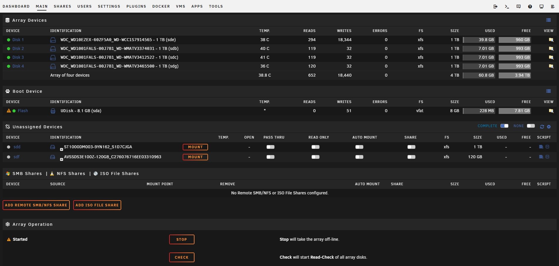

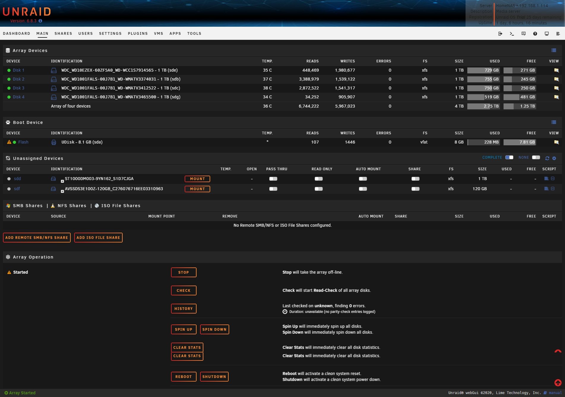

Well I've finally precleared all my drives. I've left my SSD alone and did not attach it as a cache drive nor did I attach my parity drive. That's the Seagate one. Now begins the long laborious transferring of all my movies back to the server. First 500 GB will take about an hour and 10 minutes.
Wouldn't it be faster if I attach the cache drive?
I've created a share called Media and within Media I am creating sub-folders called Movies, Music and Videos.
What would you recommend I do next?
The files would copy faster to the cache drive and then would still need to me moved to the array.  So not really.

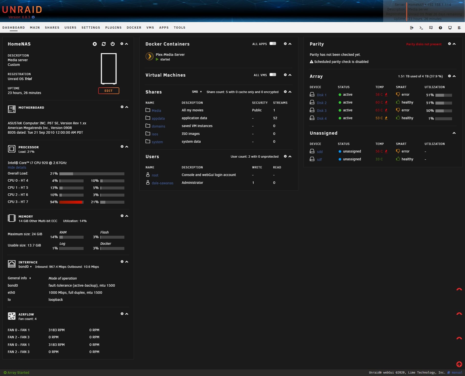

Here is a snapshot of my build FYI.

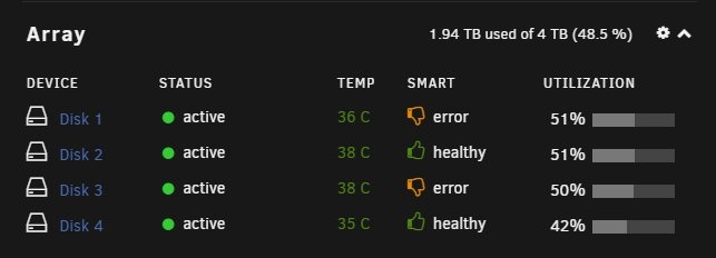

You did not use a parity drive ? Or you are still doing the initial file transfer ?
Also I see that your drives are very hot, so I would suggest to adapt your cooling solution to do something about this.
Finally, half of your drives show SMART errors, you should look into it. Though it might be because of the temperature.
Go to Tools - Diagnostics and attach the complete Diagnostics ZIP file to your NEXT post in this thread.

Disk3 is just CRC. You can acknowledge that by clicking on the warning on the Dashboard and it will warn again if it increases.
Unfortunately, disk1 is more serious:
ID# ATTRIBUTE_NAME          FLAGS    VALUE WORST THRESH FAIL RAW_VALUE
187 Reported_Uncorrect      -O--CK   100   001   000    -    23516
I would replace that ASAP. Hopefully you can build parity so you can do a replacement.
I see you have a 1TB unassigned, it also has a warning but that is just a single Reported Uncorrect. But you might as well skip using that one as parity if you intend to replace your disks with 2TB soon. Parity must be at least as large as the largest single data disk, so you would have to build 2TB parity before you could replace any data disks.
You might consider using that 1TB as disk1 instead of that bad one you already have in that slot. That would require working through some things to make that replacement since you don't currently have parity.
Also see you have 120GB SSD. That is too small for much use caching user share writes, but should be fine if you only use it for dockers and VMs.
And as I already mentioned, enabling dockers before installing cache wasn't the best idea. That will also require working through some things to get your dockers on cache where they belong.
