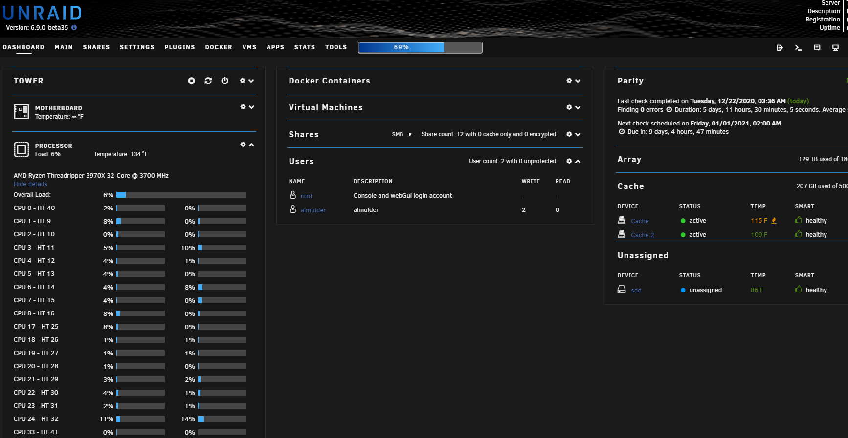

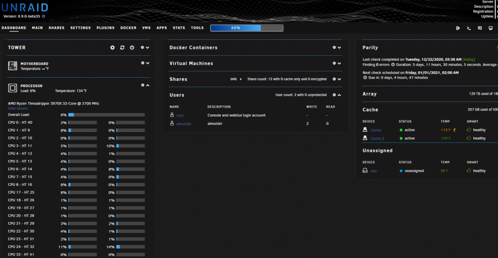

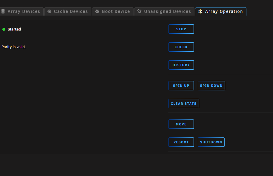

August 13, 20206 yr Author Is anyone willing to collaborate to make a better theme programs so we can make better themes and more control over them? My current method involves running a script in user scripts, and thats fine for me but for others its a pain, I know there is a better way buy I don't understand how. I need some who knows how to program and willing to help. My current method make a copy of the files and replaces strings withing the original files for the new colors, then when they want to change color they rerun the script and it replace the modified files with the original ones so they can edit them again. I here there is a way to do this with custom css files, but no clue how to do that. Any help is appreciated. It seems like many people would like the ability to modify many other aspects. Currently I am only focused on using the black theme, but will want to be able to edit them all. Below are some screenshots of the blue theme I made, (Script has you enter in 3 colors and it does the rest) This is what I want to create an interface for and use css instead of replacing the actual files. But no clue. Edited December 23, 20205 yr by almulder

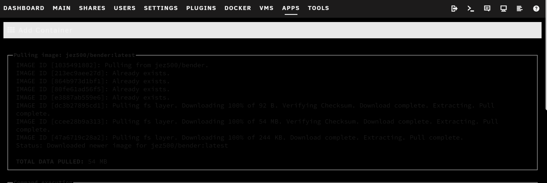

October 12, 20215 yr Hello, So I've been using this script for line a year or longer. It's awesome. But whenever I check logs of anything. The text is gray but the background is white making it impossible to read without highlighting/selecting the text. I've noticed it on all containers. But i was thinking maybe sooner of my containers just don't have any theming on it. But then it's weird the text is light gray. Anyways. It's I get to add that each container I use to make the background black is there an easy way to do that? Thanks, -Dev

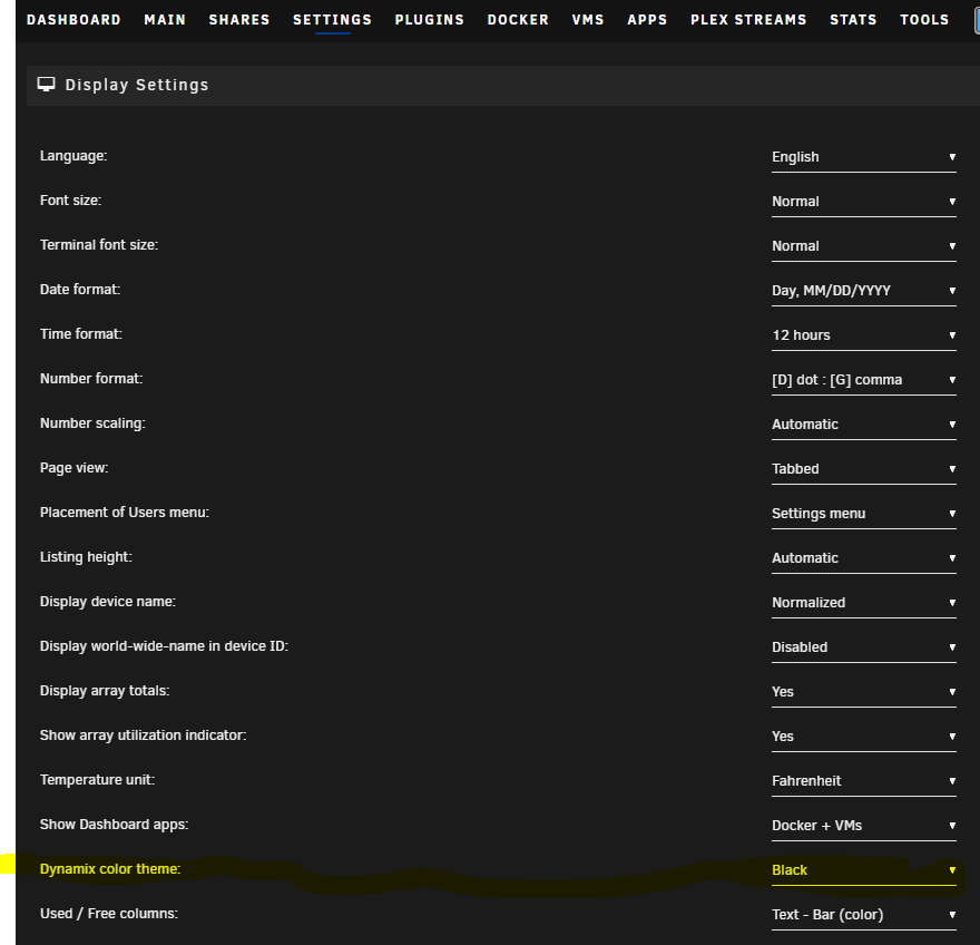

October 1, 20224 yr Author On 10/11/2021 at 7:32 PM, DevXen said: Hello, So I've been using this script for line a year or longer. It's awesome. But whenever I check logs of anything. The text is gray but the background is white making it impossible to read without highlighting/selecting the text. I've noticed it on all containers. But i was thinking maybe sooner of my containers just don't have any theming on it. But then it's weird the text is light gray. Anyways. It's I get to add that each container I use to make the background black is there an easy way to do that? Thanks, -Dev So sorry, I just see your post. Whenever I check my logs the background is black with white text. Mind showing me where your having the issue, and what theme do you have set in Settings/Display Settings/Dynamix color theme Should be set to black

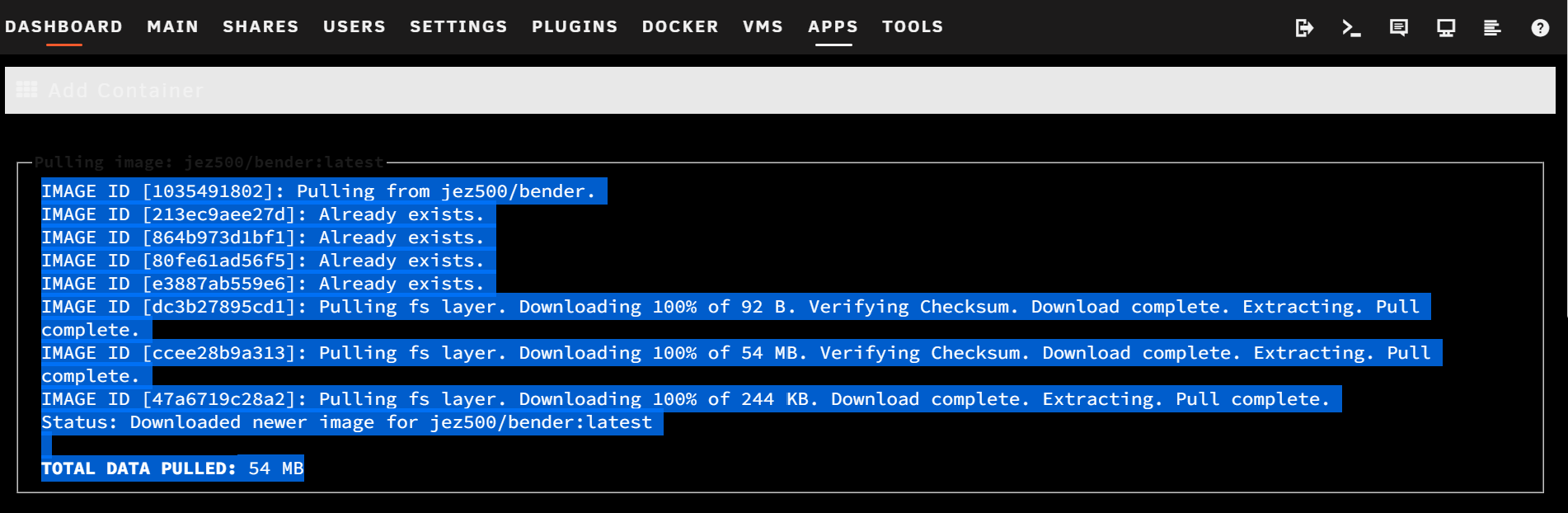

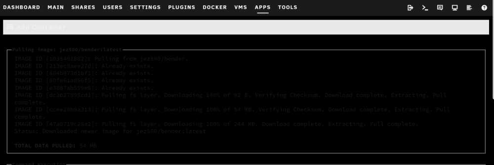

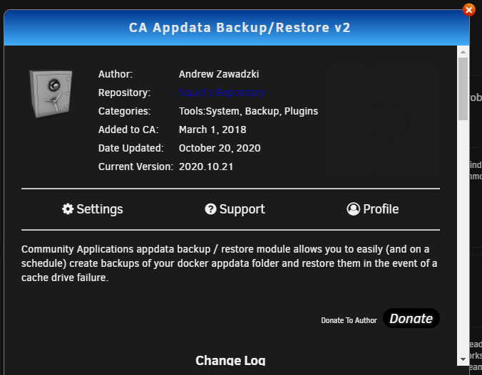

October 2, 20224 yr Author 4 hours ago, *LoneWolf* said: Yep same for me, when installing an app I will look into it.
October 2, 20224 yr Author 4 hours ago, *LoneWolf* said: Yep same for me, when installing an app So I just installed the same app and no issues. Are you using v7? And what theme are you using? (What version of unraid?)
October 2, 20224 yr 6 hours ago, almulder said: So I just installed the same app and no issues. Are you using v7? And what theme are you using? (What version of unraid?) Thanks must of missed DESIGNED FOR BLACK THEME ONLY, working great now
