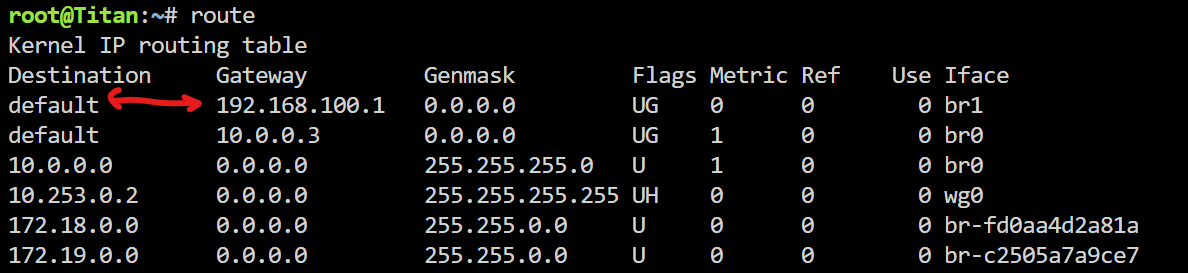

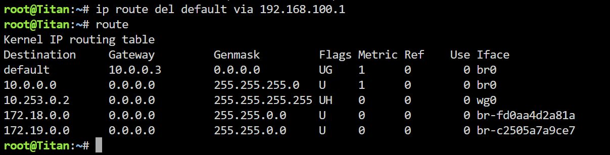

September 17, 20242 yr Just want to say I solved this by delete the route I didn't want. In my case I wanted to delete the default route pointing to a 192.168.100.1 gateway I used the following command to do it: ip route del default via 192.168.100.1 And it's gone! Hope this helps others!
