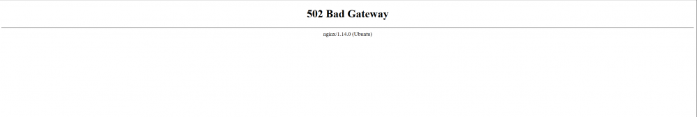

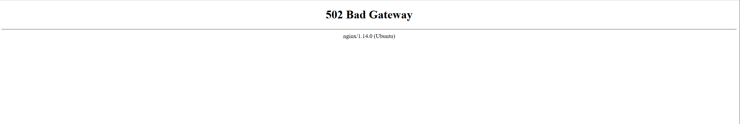

August 16, 20206 yr (update: 8/18/2020) Just wanted to update everything seems to be running fine now. for over 24 hours Removing nerdpack plugins seems to have resolved the issue! As stated web UI keeps crashing, bad gateway errors, slow/unstable ETC. I am running 6.8.3 stable channel 2x Xeon Bronze Supermicro X11DPL-i 64GB (4x16GB) Black Diamond ECC Registered Server memory. Edited August 18, 20206 yr by DataPhile
