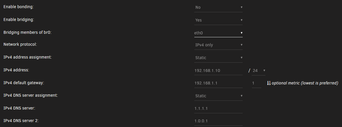

August 24, 20206 yr 4 hours ago, rockytt said: Wondering out loud if there was a way to change the IP of the server to be on the same subnet If your router allows you to set a "permanent" DHCP lease on the unRAID server IP address that is a good idea. That way, if for some reason the server is not reachable on the LAN via name you can always access it via IP address. Setting a 'permanent' DHCP lease or static IP address for the server allows you to always know what the server IP address is. You can also do this by setting a static IP address in the server network configuration (Settings --> Network Settings in the GUI). If you cannot access the GUI, you can manually edit the network.cfg file (/config/network.cfg) on the flash drive. GUI settings: Network.cfg on flash drive:
