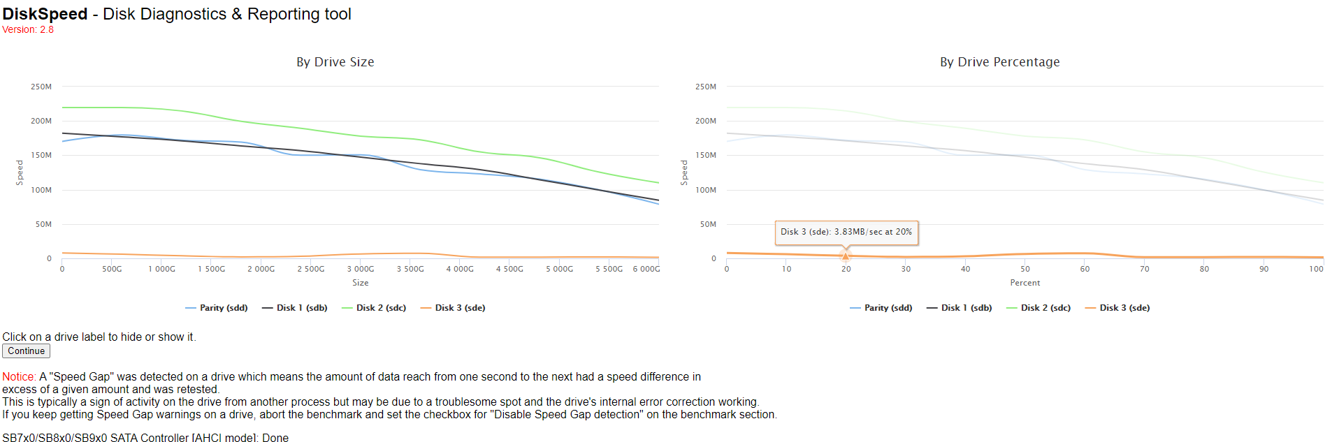

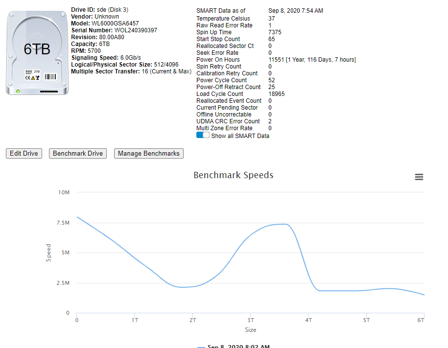

September 8, 20206 yr Author Thanks all.. Diskspeed docker revealed problem below. So it looks like disk 3, my backup drive, is failing. That sucks, but I have critical data remotely backed up as well as locally. Non critical data will get backed up during the daily backup. My question now is, should I just replace the drive and let backup scripts do their job, or replace the drive and re-silver it? Edited September 8, 20206 yr by BDPM
September 8, 20206 yr Community Expert 1 minute ago, BDPM said: So it looks like disk 3, my backup drive, is failing. Yep.
September 8, 20206 yr Community Expert 2 minutes ago, BDPM said: or replace the drive and re-silver it? Replace as soon as you can.
September 8, 20206 yr Author 2 minutes ago, JorgeB said: Replace as soon as you can. Drive will be here in a day or two. Resilver or let backup scripts do it? Disk 3 is only for backup purposes.
