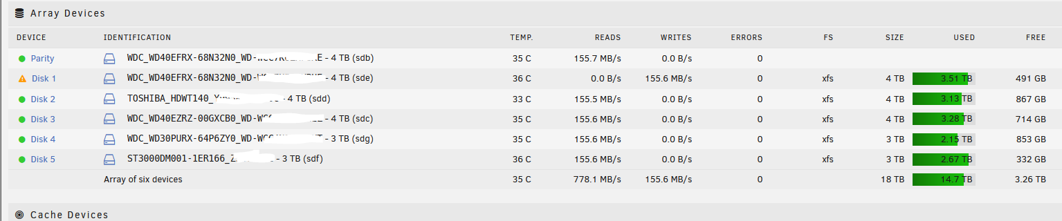

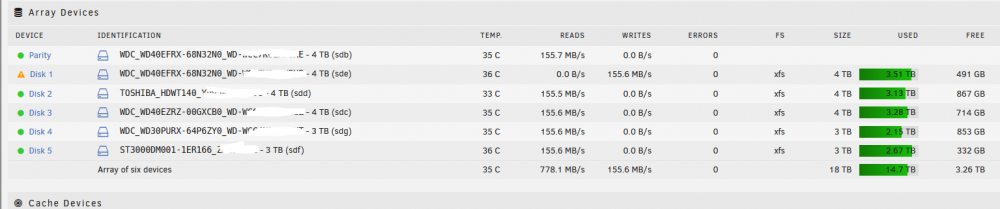

[SOLVED] Wrongly Assigned Data Disk As Parity Disk

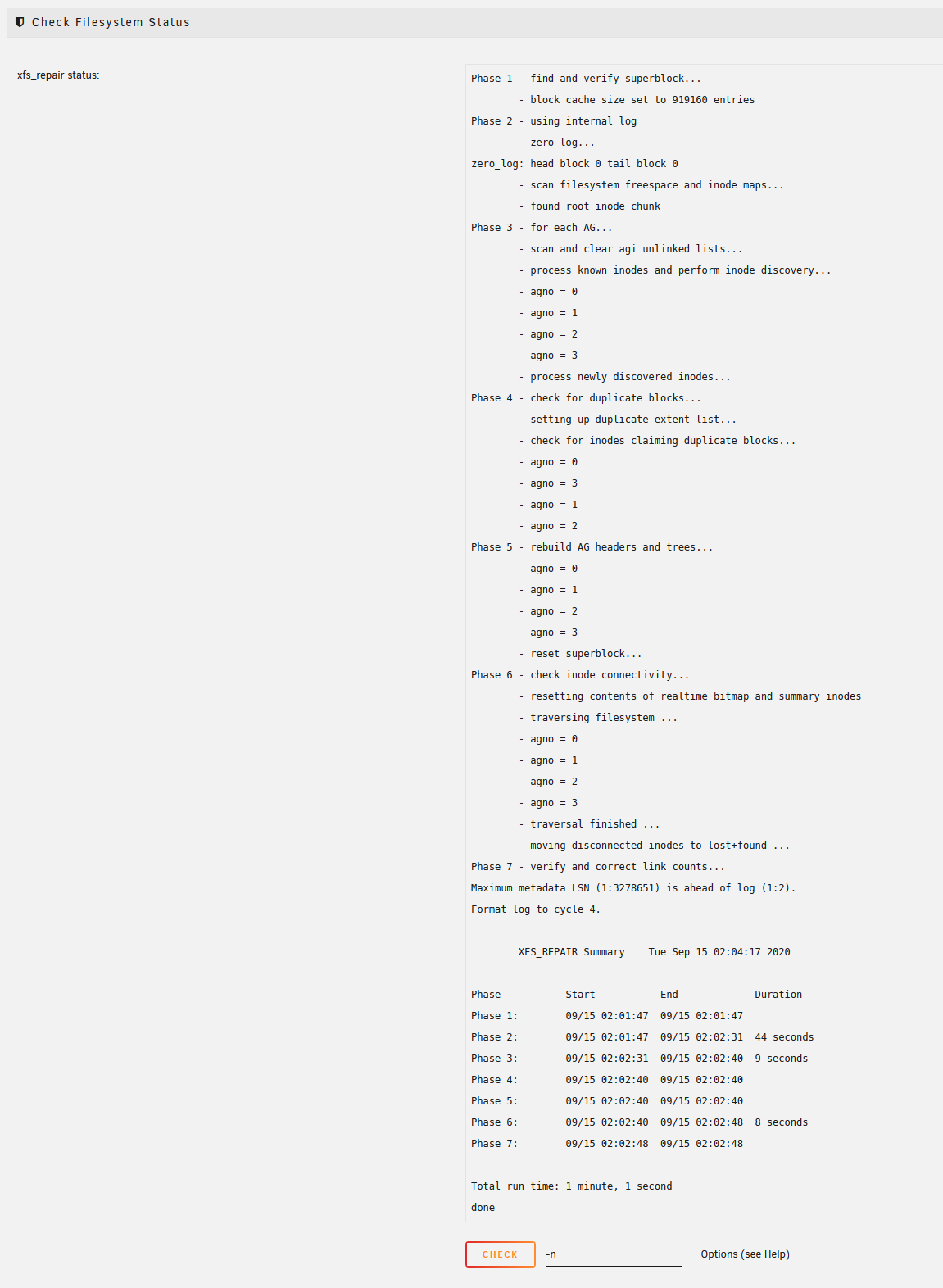

No, parity needs to be there since the disk is being emulated.
just finish the -vL
Now start the array in normal mode, not maintenance.
yes it work! (i know u thinking ofcos it work)
u safe my life, literally, all my data of my life, my photo, doc, record all is in that disk. and my share has return :)

Just now, Ong Hui Hoong said:
how would i know what data is missing?
Look for a lost+found folder, any partial/lost files should be there, all the rest should be OK.
anyway the lost+found folder should be under mnt/disk1 right? hope i get it correctly :)
hope nothing showing up there ... :)
Yep.

Hi All,
rebuild completed successfully, no lost+found folder been created, no error on the rebuild also, is that mean i got a full recovery?
It should be.
