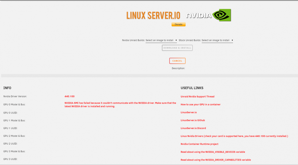

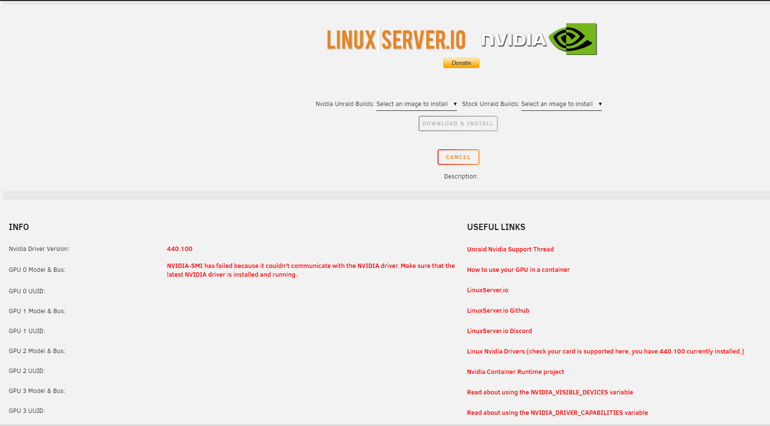

Probably unrelated to your issues, but why are you using the nvidia build of unraid when you have your gpu isolated and passed through to a VM?  It seems like that is your only gpu
yes that is my only  gpu. i am in the process of getting another gpu soon

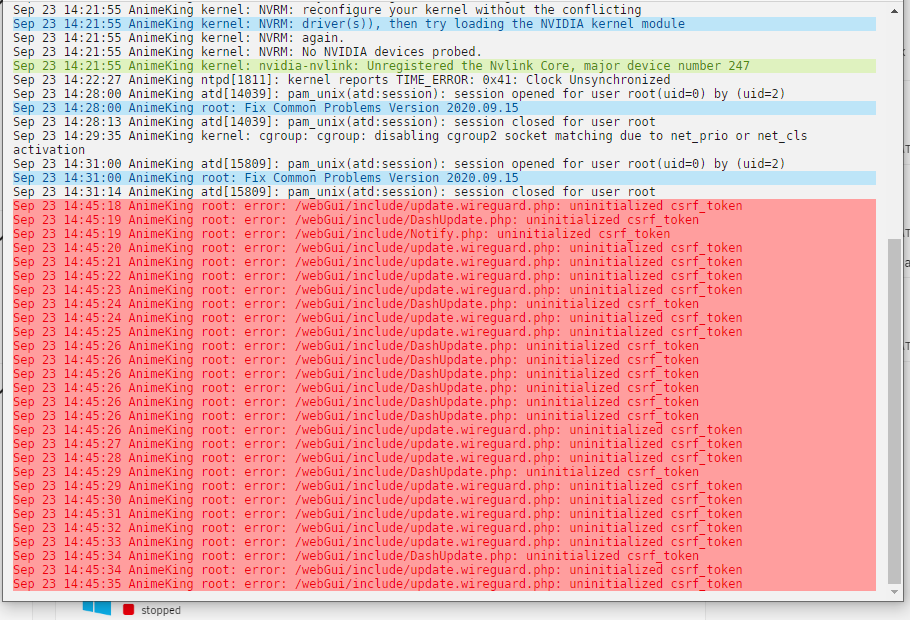

If you are having trouble getting diagnostics when the problem is occurring, setup syslog server so we can have some chance of getting syslog when problem occurs.
Does the problem occur when you don't use nvidia build?
no i can not. im rebooting my server so i can set up syslog

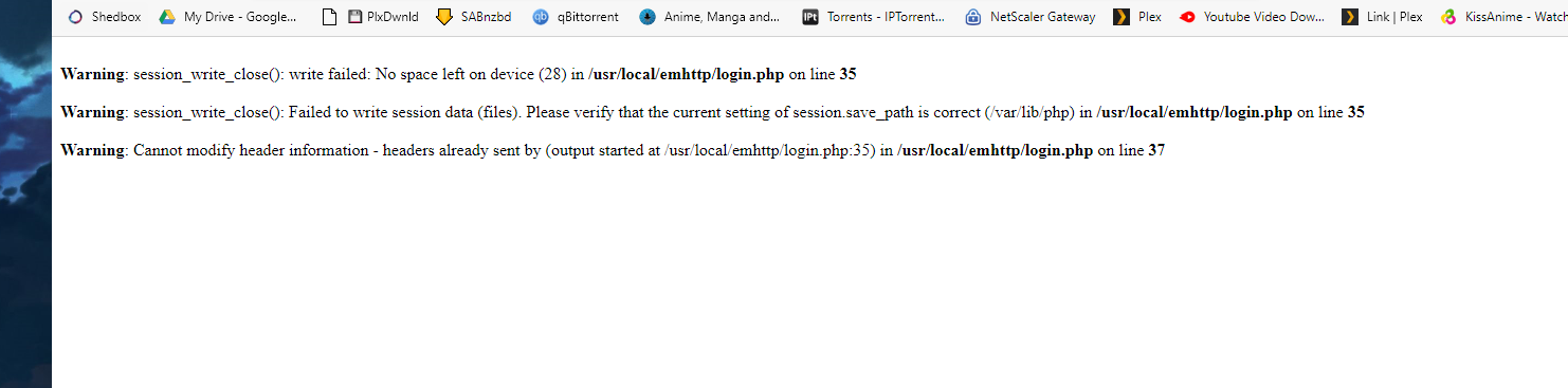

Judging by looking around on other posts, you might be filling up your rootfs (remember this resides in ram) you already assigned half of your memory to a VM.  I assume you have plex - are you transcoding in there to RAM as well (/tmp)?
@trurl i think i got it

Sep 23 16:19:47 AnimeKing kernel: nvidia-nvlink: Nvlink Core is being initialized, major device number 247
Sep 23 16:19:47 AnimeKing kernel: NVRM: The NVIDIA probe routine was not called for 1 device(s).
Sep 23 16:19:47 AnimeKing kernel: NVRM: This can occur when a driver such as:
Sep 23 16:19:47 AnimeKing kernel: NVRM: nouveau, rivafb, nvidiafb or rivatv
Sep 23 16:19:47 AnimeKing kernel: NVRM: was loaded and obtained ownership of the NVIDIA device(s).
Sep 23 16:19:47 AnimeKing kernel: NVRM: Try unloading the conflicting kernel module (and/or
Sep 23 16:19:47 AnimeKing kernel: NVRM: reconfigure your kernel without the conflicting
Sep 23 16:19:47 AnimeKing kernel: NVRM: driver(s)), then try loading the NVIDIA kernel module
Sep 23 16:19:47 AnimeKing kernel: NVRM: again.
Sep 23 16:19:47 AnimeKing kernel: NVRM: No NVIDIA devices probed.
yes i am trans in plex and have host path 2: /dev/shm/transcode. but my rootfs was doing this before the VM was made.
Nothing obvious. Were you still running nvidia build?

15 minutes ago, animeking said:
So I'm not really positive on the Nvidia build.
You have the nvidia plugin installed. That plugin is used to install one of the nvidia builds. The nvidia builds are custom (third-party) builds of Unraid with nvidia support added. That plugin can also be used to revert to a stock Unraid build.
Why did you install the plugin if you didn't know what it was?
One of my friends was helping me with my Gaming vm so that probably what he added for it. Would that hurt what I'm doing with plex and the array?
Simplifying is a standard troubleshooting technique.
i just deleted nvidia plugin and looking to see what else to simplify
Deleting the plugin won't get you to stock Unraid build.
Sep 23 19:08:57 AnimeKing kernel: nvidia: loading out-of-tree module taints kernel.
Sep 23 19:08:57 AnimeKing kernel: nvidia: module license 'NVIDIA' taints kernel.
Sep 23 19:08:57 AnimeKing kernel: Disabling lock debugging due to kernel taint
Sep 23 19:08:57 AnimeKing kernel: nvidia-nvlink: Nvlink Core is being initialized, major device number 247
The plugin allows you to overwrite the stock Unraid build with a custom third-party build with nvidia support. The plugin can also let you overwrite that custom third-party build with the stock Unraid build. Removing or installing the plugin won't change which Unraid build you have installed.
I don't use that plugin. Reinstall it then post a screenshot of its settings.
The 2 dropdowns at the top let you select a build to install. To get back to a stock Unraid build select one and click the button
I just choose 6.9 beta 25 for both and installed it
