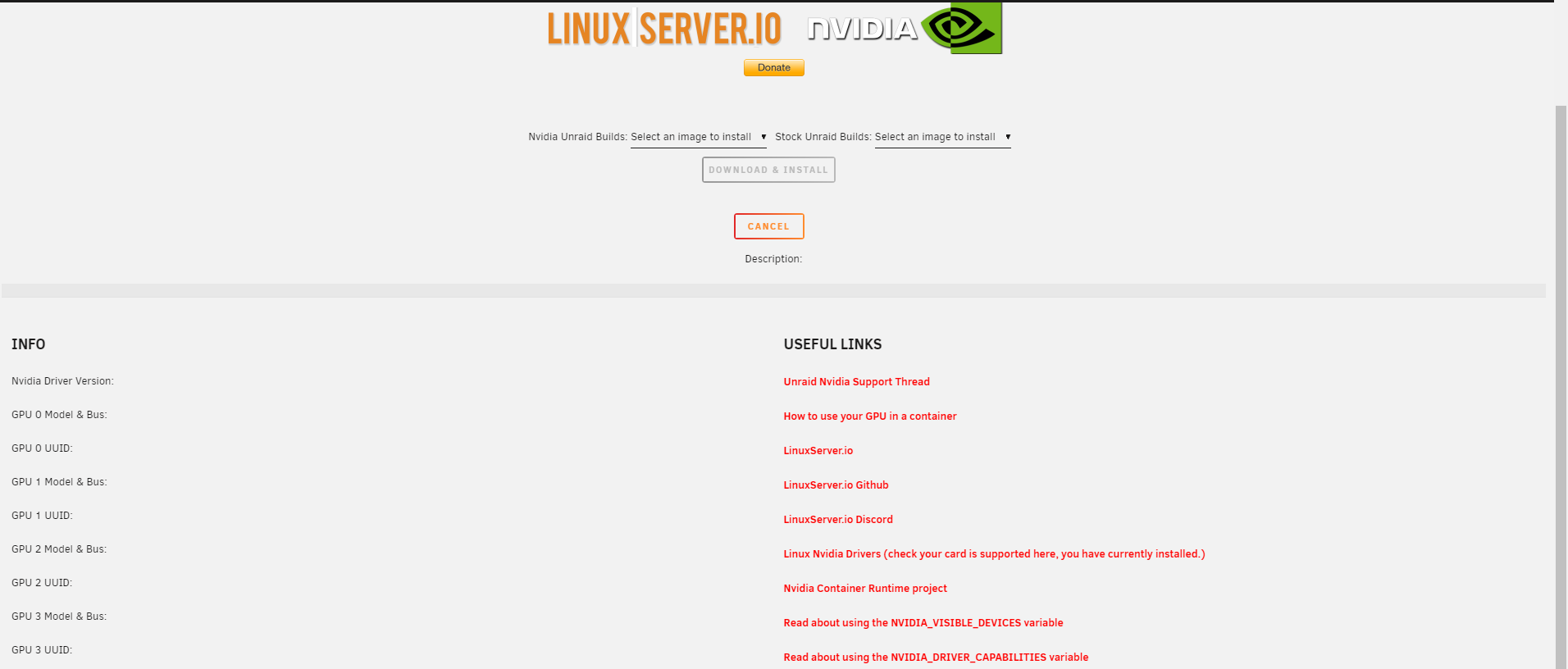

I just choose 6.9 beta 25 for both and installed it
Like I said I don't use this, but both is not something that makes any sense. It should be either nvidia build or stock build. I don't know what it will do if you select both, but it is not possible to have both at the same time.

Select ONLY the stock Unraid build and install it. I assume it will tell you to reboot but if it doesn't you must reboot after the install to run the stock Unraid build.
Then post new diagnostics.
That is only syslog, not diagnostics. You did post diagnostics in your first post, but syslog is enough for now. It seems to indicate you have stock Unraid now. Post another screenshot of the nvidia plugin settings.
Compare that to your earlier screenshot.
So, you are now on stock Unraid and Diagnostics says unraid-6.9.0-beta25
Try it that way and see if it makes any difference.
Sent from my SM-N986U using Tapatalk
Not sure which build gets installed if you do that.     You only chord EITHER a Nvidia build OR a stock build.
It was the Nvidia build not the stock build
As noted and as I instructed, you were on the stock build with those latest diagnostics and the nvidia plugin screenshot.
Did you reinstall the Nvidia build after that?

And in regard to the 'nvidia build' of unraid, for troubleshooting, its best to simplify the process and that build is not "officially" supported (third party).  Also, since you stubbed that video card anyway to pass it to a VM, unraid itself can't see it so the driver will never load and becomes pointless; and spams the log.

and on the nvidia i was trying to passthrough my VM so i can use my gpu for gaming
yes, I figured; in that case the nvidia build is pointless since the VM (windows) is handling the gpu and drivers.  The nvidia build is primarily used if you want to allow the gpu to transcode in plex/emby, in which case it provides the necessary drivers for unraid/linux to see and talk to it.  Unfortunately, it's one or the other: either keep it in unraid for transcoding OR pass through to the VM
