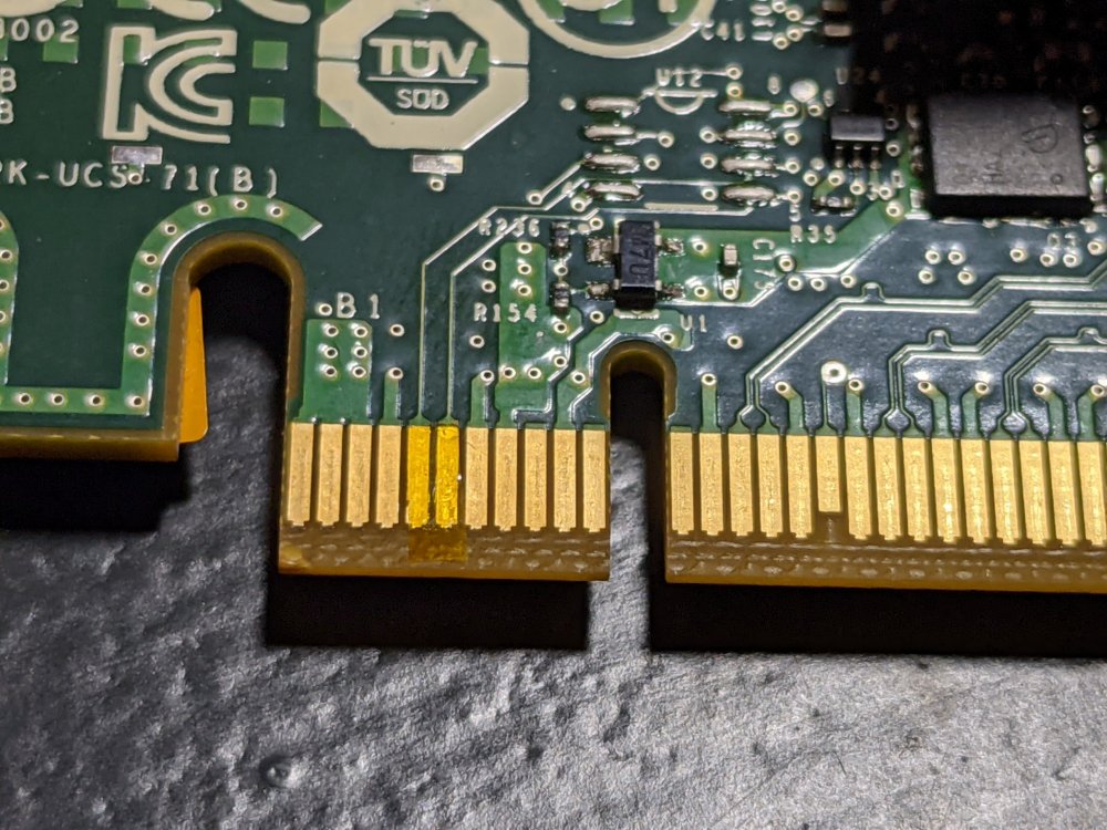

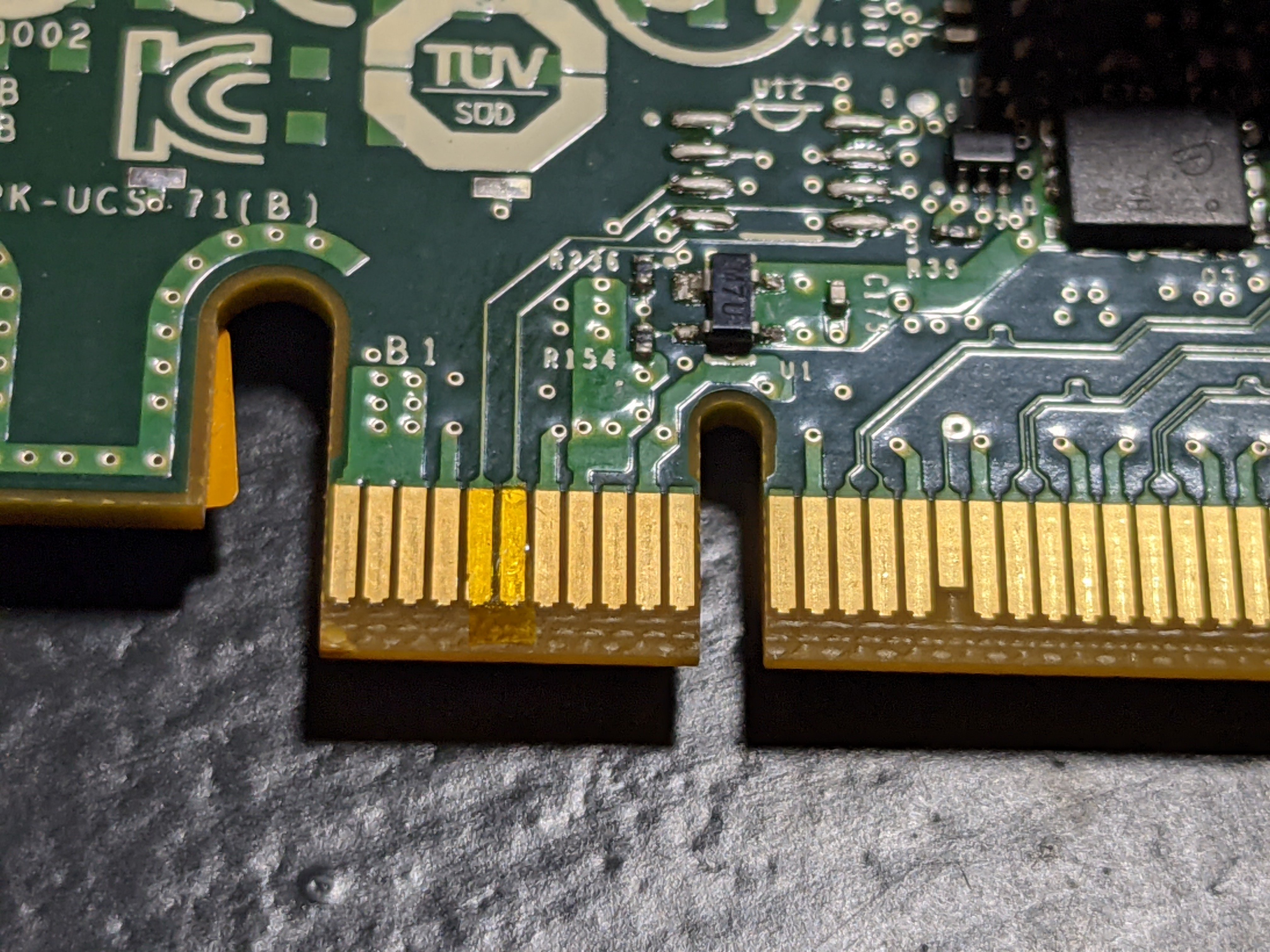

Bought some "Polyimid Foil" today from the 3D printing section of an electronics market in my hometown. I used just a tiny bit of it to cover the 5th and 6th pin of the controller. It's so thin it's nearly not visible.
After booting up the machine all disks are shown, of course still with the same ids, so UNRAID detected all the disks of the existing array. The one disabled disk from my last parity build was still unassigned. I just assigned it agai and the data rebuild just started.
Kapton is a brand name for that exact product.
Now you know how different it is from electrical tape! Night and day difference for this specific usage.
Yep, that's what I had to find out. Wanted to drop the name here for anyone reading this thread in the future :)
And yep, you're right. This is very different from regular electrical tape!

Quickly recapping what I did and what I learned:
* NEVER buy SATA controllers with Marvell chipset
* instead use LSI/Broadcom (or maybe JMB585 chipset)
* in case you decide for a Dell Perc H200 you probably need to "deactivate" the 5th and 6th pin with some "Polyimid Foil"
* unRAID community is awesome :)
Thank you so much! Marking this as [Solved] :)
