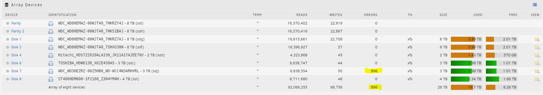

Those diagnostics are with the array stopped. Can you post another with the array started? Also, post a screenshot of Main - Array Operation.

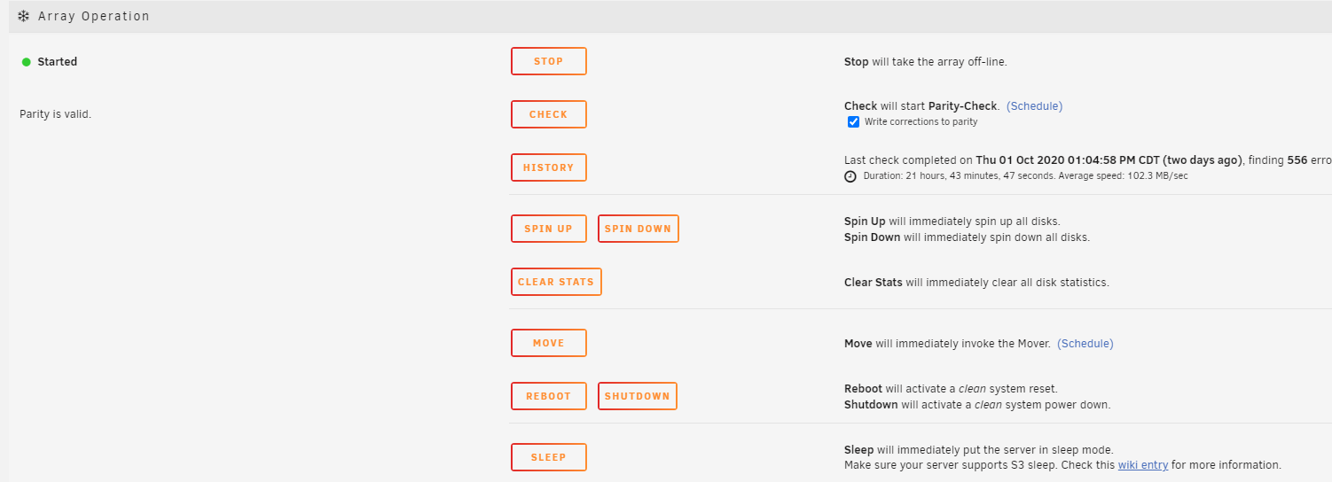

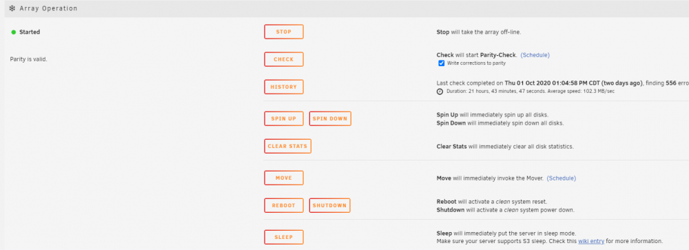

OK. Just trying to confirm that your last parity check had errors.
You must run a correcting parity check to correct those. And then run a non-correcting parity check to confirm you don't still have any.
Exactly zero sync errors is the only acceptable result and until you get that result you aren't finished fixing things.
Exactly zero sync errors is the only acceptable result and until you get that result you aren't finished fixing things. no errors in smart for that drive.

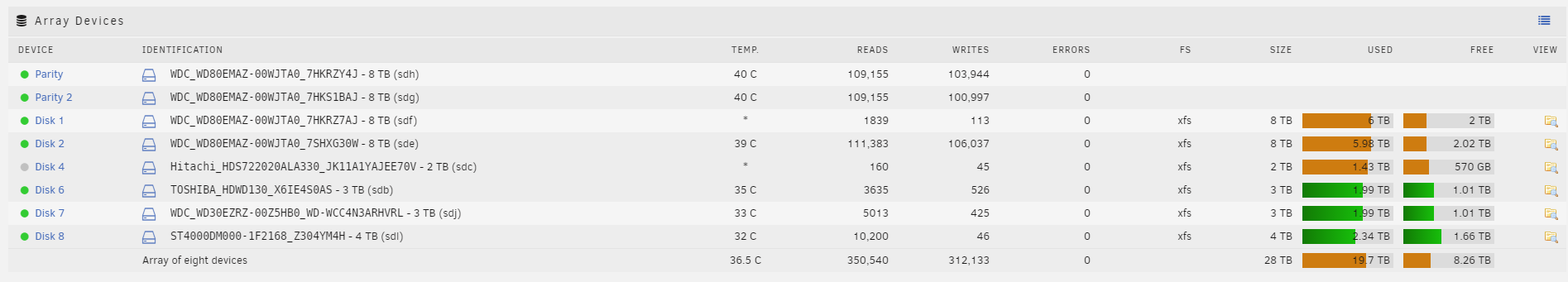

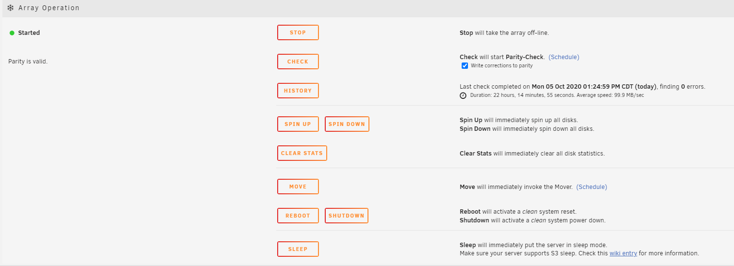

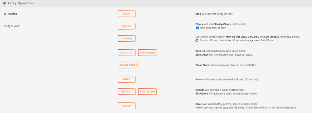

i just finished another parity check run. 0 errors but got errors for disk 7. should i run it again? also attached the diag. edit: the only time i ever had errors is after connecting more drives and since they are still connected i think its that. still waiting for the molex power for sata. image.thumb.png.8596fe33482f49bf612cf27c88904a22.pngimage.thumb.png.5496e583cd549cd26720cfa7f8be8296.png
server-diagnostics-20201005-1551.zip
Edited by droopie
Might as well wait until you make that change before further testing.
