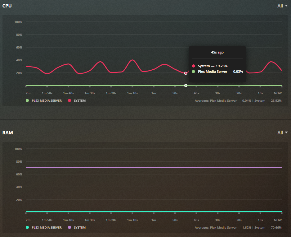

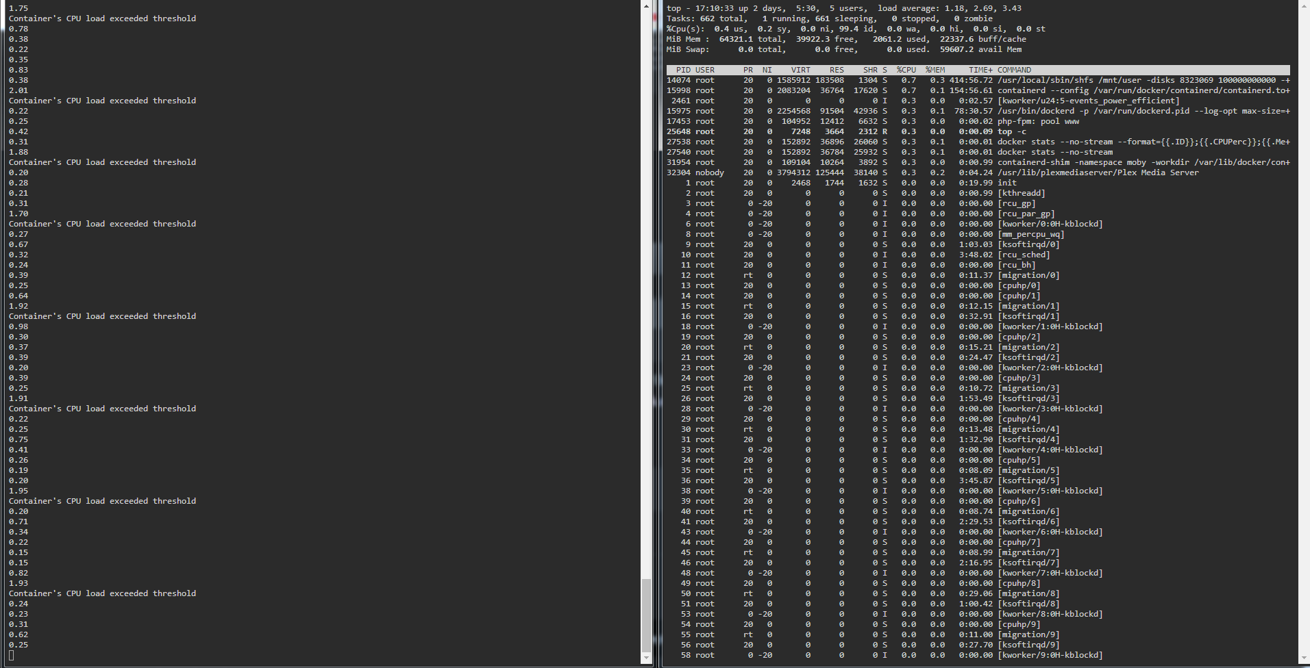

October 20, 20206 yr Hi @mgutt This is another great idea you have! I think mostly my drives doesn't spin down before evening, but I have had complains late at night that the stream did not start - and then you had to press play again? (Spin-up) (Not the end of the world but if I can fix it...then why not ) So running this on Plex I get these spikes? I checked and I have no TV-recording, no playback, and no scanning of library What do you think could be causing these spikes? Highest value was 45.97 From Plex

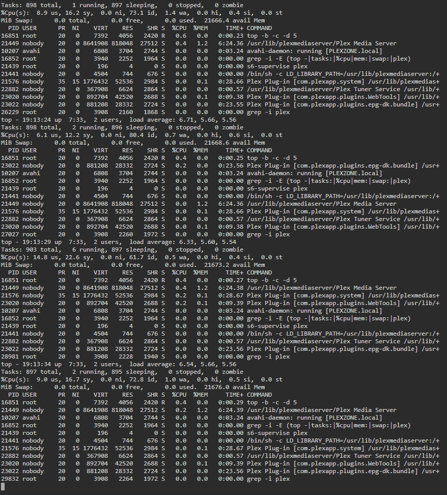

October 20, 20206 yr Author When this happens execute the following to see all Plex processes top -b -c -d 5 | grep -i -E "(top -|tasks:|%cpu|mem:|swap:|plex)" I guess Plex: - rescans the library - Plex generates Thumbnails - Plex tries to find tv show intros (so they can be skipped) Edited October 20, 20206 yr by mgutt

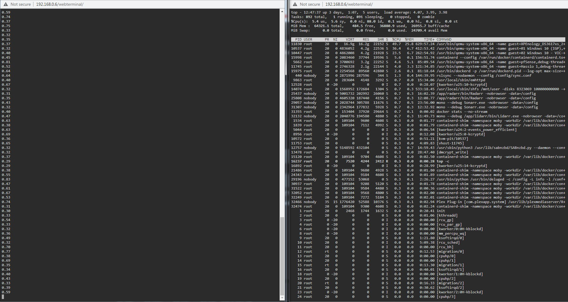

October 21, 20206 yr 22 hours ago, mgutt said: When this happens execute the following to see all Plex processes top -b -c -d 5 | grep -i -E "(top -|tasks:|%cpu|mem:|swap:|plex)" I guess Plex: - rescans the library - Plex generates Thumbnails - Plex tries to find tv show intros (so they can be skipped) So I did run both script at the same time: But below I don't see the CPU go above 1% Not a single time! This is really strange Edited October 21, 20206 yr by casperse

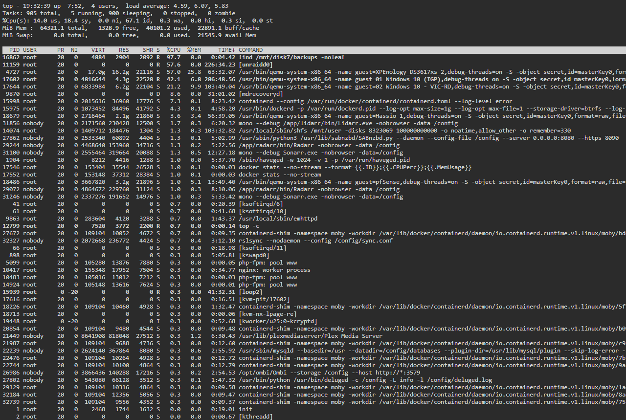

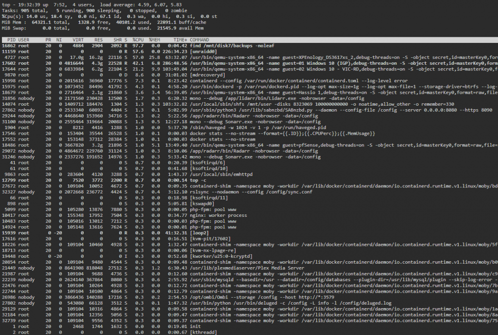

October 21, 20206 yr Author 1 minute ago, casperse said: I don't see the CPU go above 1% Really strange. Maybe the container CPU load includes I/O wait? Because your top results show permanent wait (1.4, 0.7, 0.5 and 1.0). This means something is reading / writing data from/to HDD/SSD and the volume answers not fast enough. Please repeat the test, but this time check all processes: top -c I'll bet its unraid's SHFS process ^^

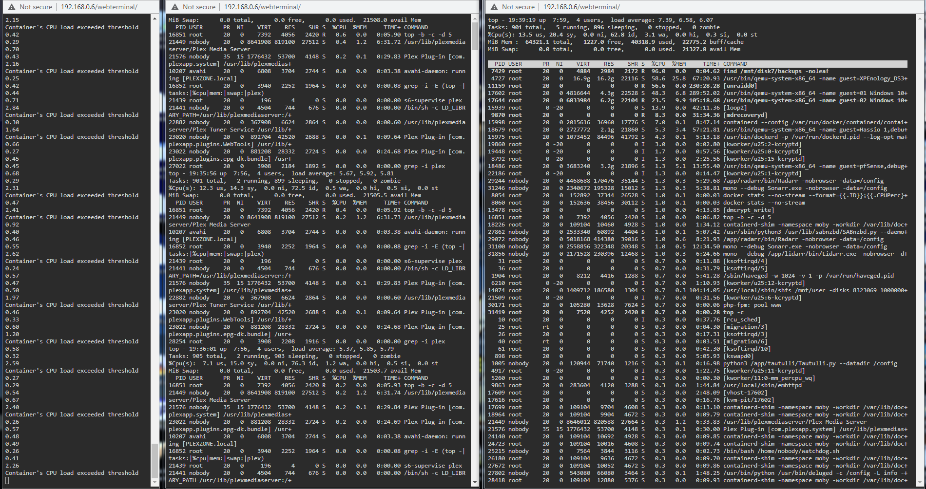

October 21, 20206 yr 5 minutes ago, mgutt said: Really strange. Maybe the container CPU load includes I/O wait? Because your top results show permanent wait (1.4, 0.7, 0.5 and 1.0). This means something is reading / writing data from/to HDD/SSD and the volume answers not fast enough. Please repeat the test, but this time check all processes: top -c I'll bet its unraid's SHFS process ^^ I can't see what it is, hope you can :-)

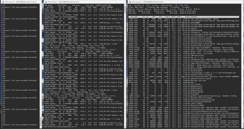

October 21, 20206 yr I use the Plex inc Docker moved away from the other ones, maybe it's different? Had it running across all tree trying to catch it Edited October 21, 20206 yr by casperse
October 22, 20206 yr Author 7 hours ago, casperse said: I can't see what it is, hope you can 🙂 I would say you have so much activity on your drives that even a small write from Plex like to a log file, can produce an I/O wait, which boosts the docker containers load. If you like you could install "iotop" through the NerdPack Plugin and execute it: iotop It returns all processes with the most I/O actions. And you could install sysstat to execute iostat which returns activity per disk: watch -t -n 0.1 iostat -d -t -y 5 1 Finally you would need to find out which process is writing to the same disk, which is used by Plex. But I'm not sure if this effort is worth it. I mean what could you do to remove the io wait? Maybe direct disk access tweaking? Or a seperate disk for Plex alone? Edited October 22, 20206 yr by mgutt

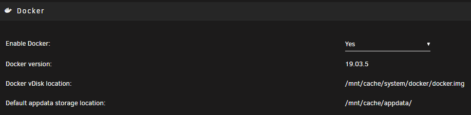

October 22, 20206 yr Author Do you already use direct disk access (replace /mnt/user/... against /mnt/cache/...) for Plex appdata, docker.img and other docker appdata containers, using the cache only?
October 23, 20206 yr 20 hours ago, mgutt said: Do you already use direct disk access (replace /mnt/user/... against /mnt/cache/...) for Plex appdata, docker.img and other docker appdata containers, using the cache only? I see what you mean! I only went into the dockers of Plex/Emby and changed the path to /cache/ I should do that for all of the running dockers /appdata/ path! I come back and report my findings when that's done

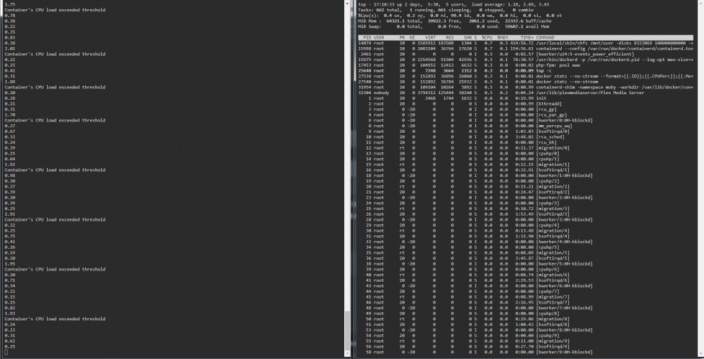

October 23, 20206 yr So I did the change to all appdata path to /cache/ (If I ever update my cache drive I need to remember to change this back before moving it back to the array! LOL) I then started to shutdown every docker! and every VM down! so only Plex docker was left running: And I keep getting these Bump as a heartbeat? So only thing left is Unraid Apps (Can not stop them, but I can start to uninstall them?) Or its the Plex inc Docker? that somehow are different than the others? (I could try another one?) Almost given up now! :-)
October 23, 20206 yr Author First process is SHFS. Something is still writing to / reading from "/mnt/user/". 1.) Your docker.img path uses /mnt/cache? 2.) Did you disable Heartbeat? (The Link contains a command to monitor writes to the docker.img as well)
October 23, 20206 yr 33 minutes ago, mgutt said: First process is SHFS. Something is still writing to / reading from "/mnt/user/". 1.) Your docker.img path uses /mnt/cache? Yes I pretty much have /Cache/ written everywhere now :-) 33 minutes ago, mgutt said: 2.) Did you disable Heartbeat? (The Link contains a command to monitor writes to the docker.img as well) Funny I said that it looked like a heartbeat didn't know there actually was one! (I will disable it when there is no traffic and test again) Thanks!
October 24, 20206 yr Finally - Thanks for all your help! - I think it's finally where I can use this script without spinning my drives up 24/7 But maybe I should make it around 4-5% - I still get some spikes after 3 min: 3.71 - Container's CPU load exceeded threshold And I think Plex activity of any user going into any media library will go way above 4%...even 10% in my testing Could be interesting to see if this actual have any noticeable impact on my electric bill since all 22 drives (Not including the 2 x parity drives) would be spin up during any playback of any movie. I actually did the separate UAD drive for frequent access in order not to do spin ups but that was 24/7 I think this is reasonable trade off... Thanks again Shouldn't it keep them spinning 2-3min between getting threshold again? keeping the drives spin-up? Edited October 24, 20206 yr by casperse
