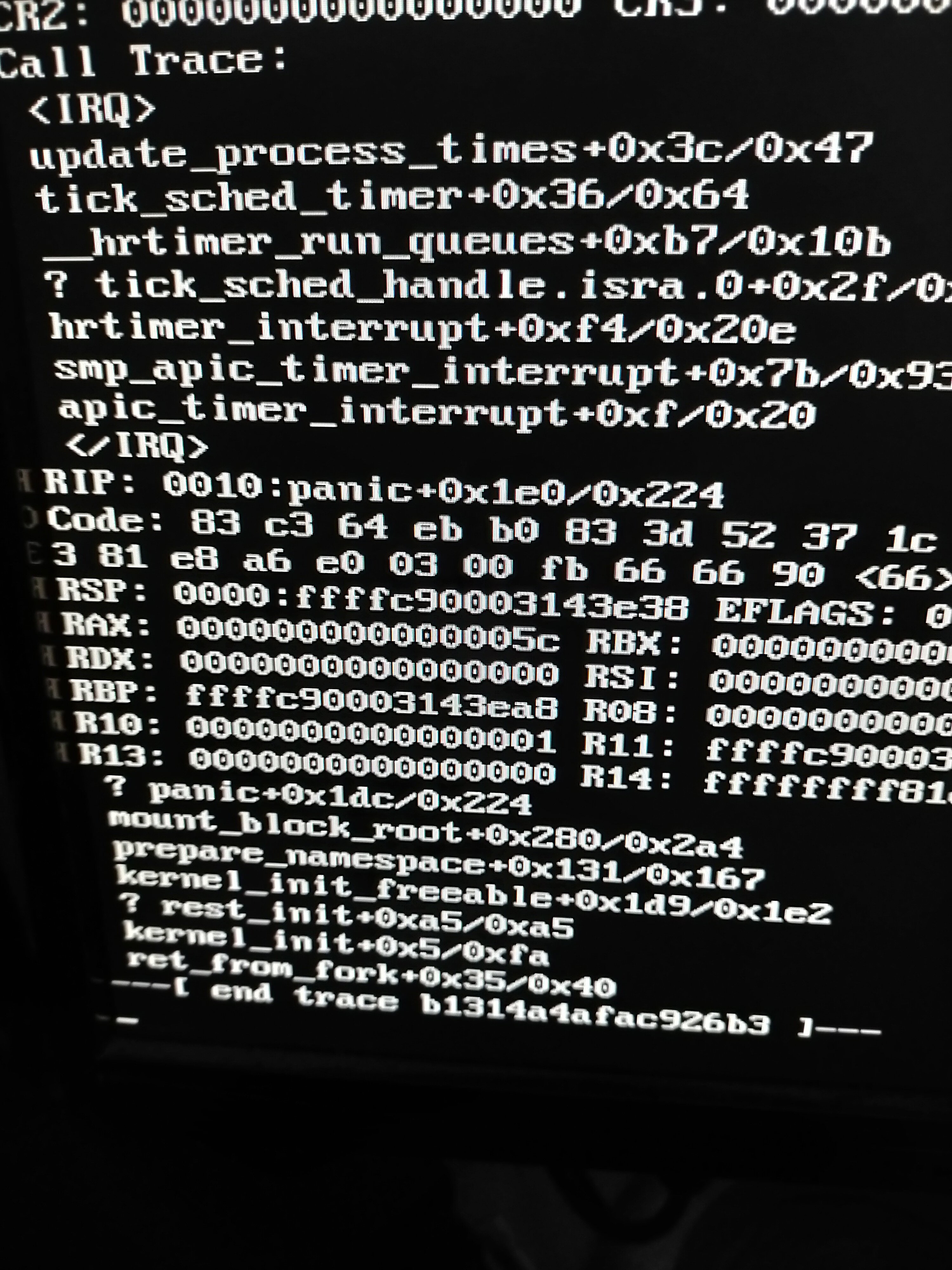

October 30, 20206 yr Author Hi all, Restarted the PC this morning to run memtest and it would not run. Went to go back into Unraid and it stuck at the attached. I havent got a recent backup, my most recent is from June. I am wondering if the old usb is corrupt, so I have tried to copy the files from the old USB to the new one and make bootable but I get the same. Whats my best course of action? From my diagnostics is there a way to find the correct drive assignments? I have another USB is there a way to create it and copy the config folder over? Thanks
October 30, 20206 yr Author Got it sorted. Created another Unraid boot disk, copied the config over from the old USB stick and booted it. Everything is back up, the only issue is JellyFin throwing a wobbler. Small price to pay. Downloaded a flash backup straight away. Ran a memtest. Had to download a setup Ultimate Boot CD as memtest wouldnt boot. Ran it for 8 hours, no errors.
