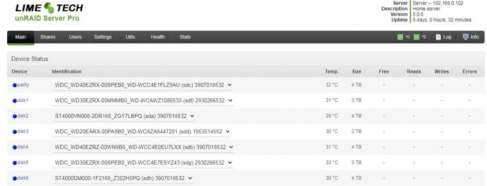

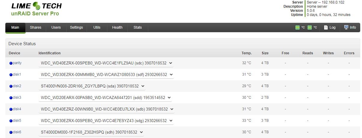

Array must be new after the new config (blue icon for all devices):
Yes that's what I get (I've just repeated the first steps of the process)Capture3.thumb.JPG.dad7a90d02d2d8bd81984961c6f40368.JPG

With that said, worth another try? Questions:
- if I get the same problem (parity drive being rebuilt), the correct course of action is to stop rebuild ASAP, right?
- is there anything I should do to 'protect' the parity drive given the problem with the previous try? e.g. cloning it?
In the meanwhile, I am trying to recover data from the old disk2. I believe that the file system might have been wiped out due to a temporary short on the PCB (I didn't fix it properly and it might have hit a screw on the casing - not my finest hour). The data should all be there. I'm using Raise Data Recovery for that (I don't have a Linux PC and this one works for Windows).
2 minutes ago, JorgeB said:
Now do it the other way as the post above.
Thanks @JorgeB. Will try later today and report back.

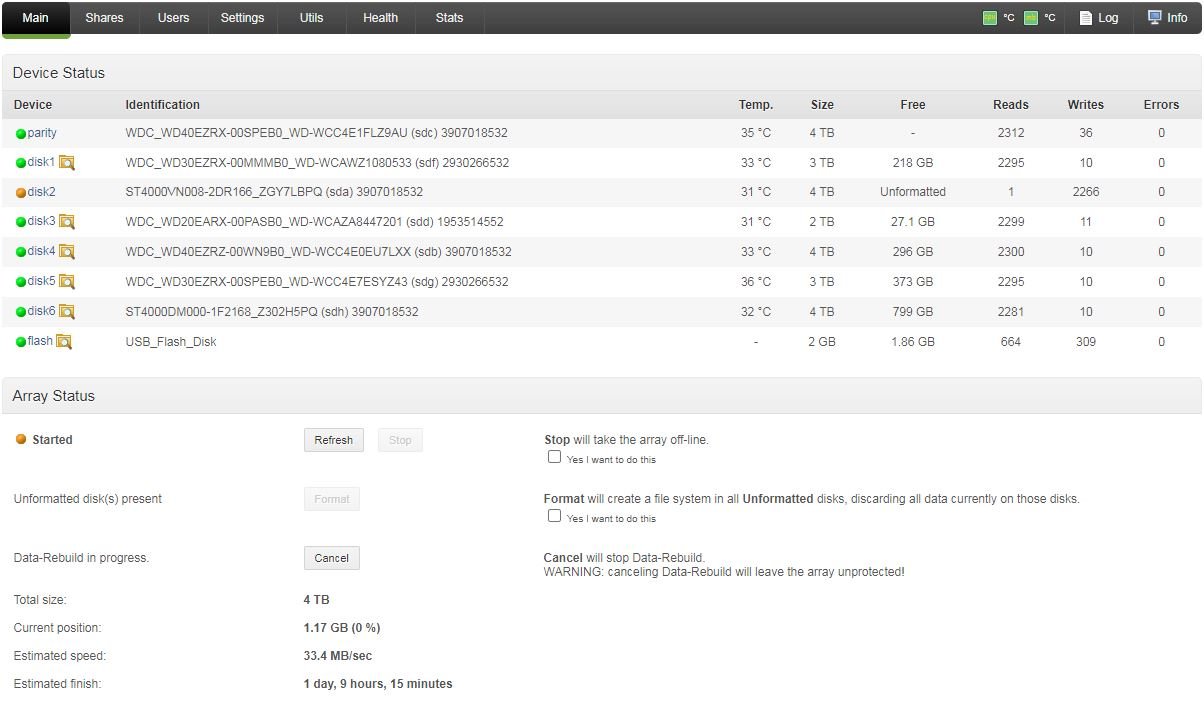

@JorgeB I tried another time the original way, no luck - the invalidslot command doesn't seem to work here for some reason. Stopped immediately obviously to minimise incorrect writes on parity disk.
So I followed the other way you suggest and now we are up and running, see below.
You mention "filesystem check", "rebuild the superblock", "--rebuild-tree" - I assume these are all things I will have to do on disk2 later on to fix the partial 'damage' on the parity disk, right? So I assume the process now is:
- finish data-rebuild
- fix disk2 with the commands above (I will look them up but if confused, I might have to come back to you and ask for help - sorry!)
- run a parity check
Thanks!
