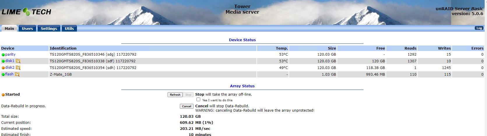

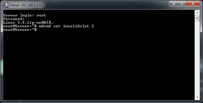

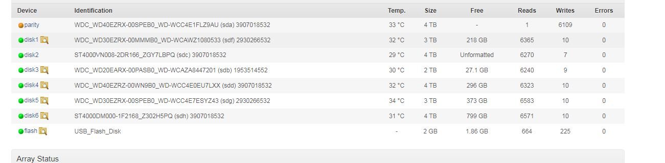

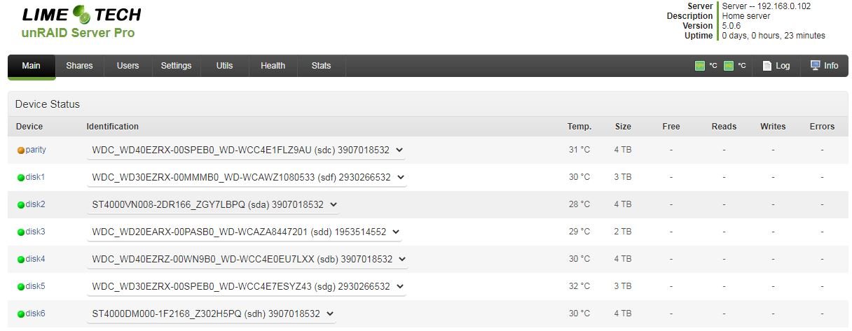

@JorgeB I'm not sure it is working; I've stopped the parity rebuild. I followed your instructions to the T but when I restarted the array, it showed disk2 with a green dot, the parity disk with a orange dot, and it started writing on the parity disk! I quickly stopped the parity rebuild to minimise 'damage' to the old parity drive (the parity rebuild was stopped after 6109 writes to the parity disk so hopefully nothing major).
See below:
- screen grab of the Main page before I stopped the parity rebuild
- screen grab of the invalidslot command in Telnet
I'm struggling to image what could have gone wrong. I am sure I did not refresh the Main page before starting the array but could it be that I waited too long before doing so? After sending the invalidslot command, I went through your instructions again before clicking the Start button; let's say 1 minute between invalidslot command and starting the array...?
... or any other suggestions? Thank you!

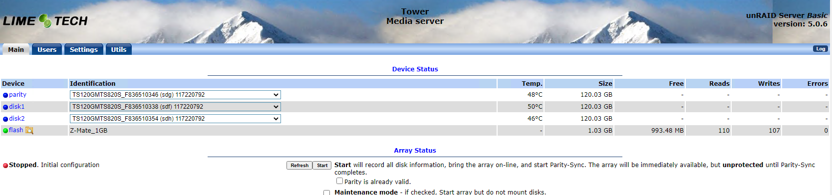

Looks like it was done correctly, but apparently something wasn't, make sure you're on 5.0.6 like mentioned, it appears you are since the kernel version is the same.
Just did a quick test, waited for about 3 minutes after the invalid slot command and it still worked correctly.

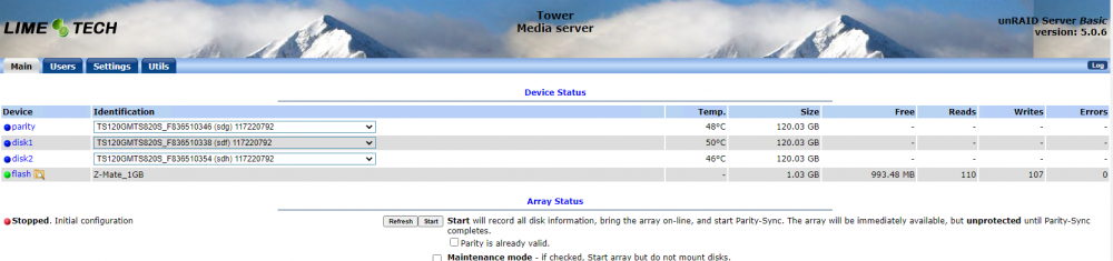

Array must be new after the new config (blue icon for all devices):
Type the invalid slot command and start array:
Yes, 5.0.6. Full screen grab of the Main pageCapture1.thumb.JPG.24bd5000a4f0ea8feec6a6dedc9df87a.JPGCapture2.thumb.JPG.f07cacdab962f0aa9cada83f011ff79d.JPG
No idea why it didn't work then, you can try the other way, more steps but at least it won't damage parity any more:
