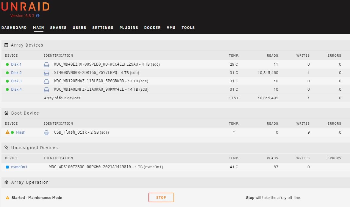

See below - 'original disk2' as Disk 1, 'rebuilt disk2' as Disk 2, and the new data drives as Disk 3 and Disk 4. I started the array in Maintenance mode.
Disk 2 aka 'rebuilt disk2' is currently getting the reiserfsck --rebuild-tree --scan-whole-partition treatment.

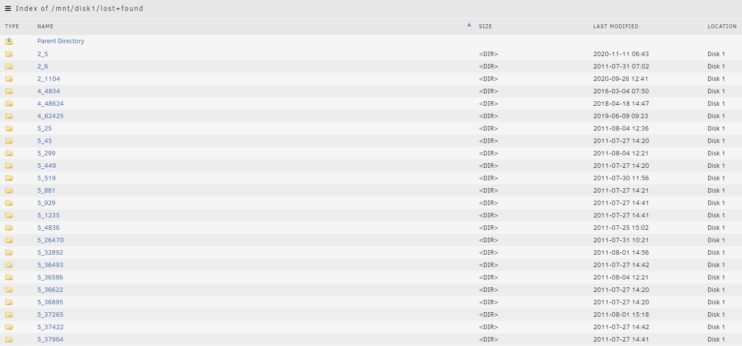

An update. reiserfsck on 'rebuilt disk2' seems to have done a decent job, though the root directory structure has disappeared and folders are now mostly bunched together in lost+found - see below.
I'm thinking of copying the whole content of 'rebuilt disk2' to an external hard drive, re-start the array only with the new 12TB and 14TB drives + parity, then on my PC slowly shift through the folders in lost+found and one by one copy them to the correct location on the server. Any better ideas? Thanks.

Have you looked at the files in there? You may find the filenames have also disappeared.
Yes, they seem to be OK. The data I hadn't backed up is mostly DVDs saved in their standard structure (VIDEO_TS, AUDIO_TS folders etc.). I've played a handful of folders and they seem to work OK.
