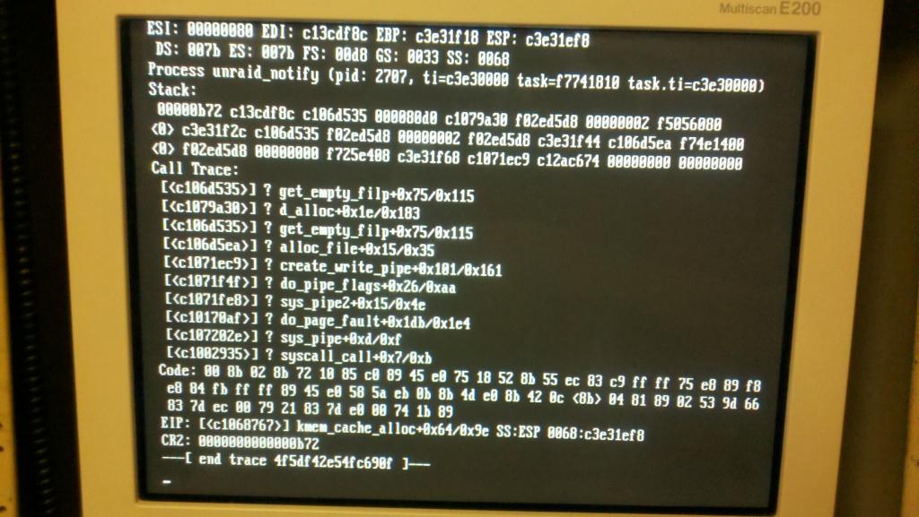

I will run memtest tonight. What methods do you suggest to troubleshoot the power supply i have CORSAIR Enthusiast Series CMPSU-650TX 650W ATX12V / EPS12V was supposed to be a good one. I also attached a picture of the console before hard shutdown.
you have cache_dirs running ?
if yes... then i think you are caching a bit tooo much and your machine is running out of memory
if no... swap enabled ? any corruption on your swap file? check your logs for any problem with the disk where the swap file is on ?
Else... wait till a more experienced user gives comment on that screenshot
