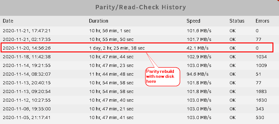

Just an update,.. I replaced the parity disk and it looks like the problem has gone away from what I can see below. Am just doing another check, hopefully it comes back with 0 as well.
Oh well, so much for that theory.

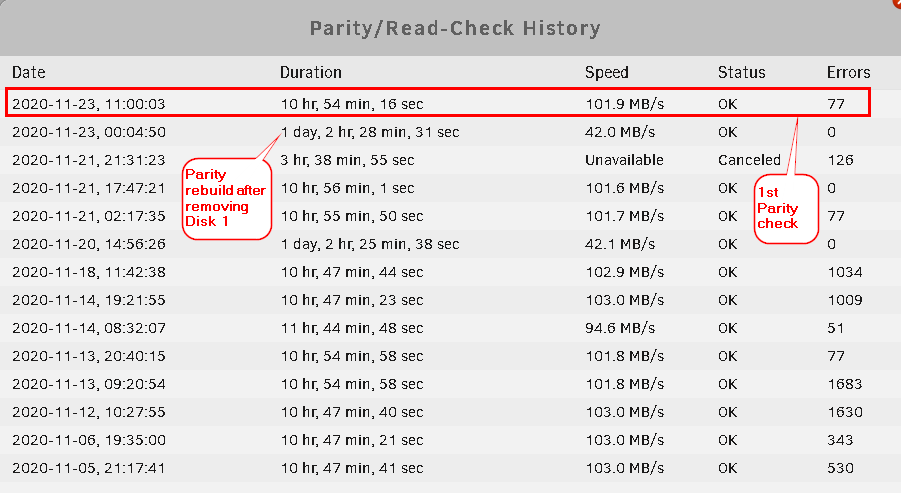

OK, so after the parity rebuild following the removal of Disk 1, I got errors and then repeating the check started to get errors again as per screenshots below.
I figure there's no point in letting the check finish - is that right ?

Yep, cancel and try without a different disk.

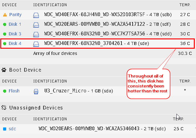

Gut feel is the 4TB that's running hotter than the rest,.. its also sitting vertical in the cage not at the top (Disk 1 is at the top in the DVD bay) which is the one I'd have thought would be the warmest
Could be, but not because of the temp, 36C is still cool.

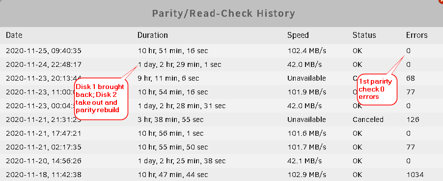

Latest update is looking good so far. Assume if it gets thru this check with 0 errors, that Disk 2 was the issue ?

Most likely, I would run another one just to make sure, kind of worrying that a disk starts corrupting data out of the blue without any apparent reason, and SMART looks normal.
