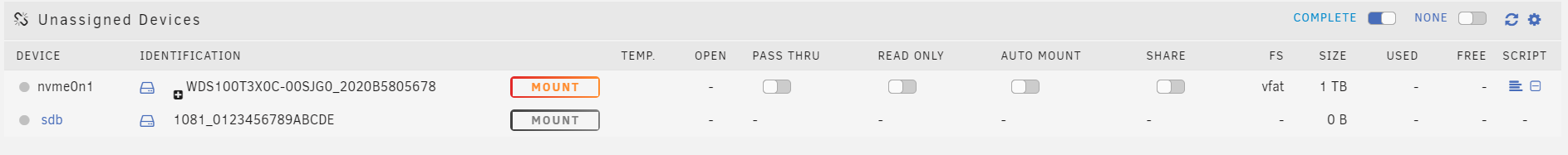

So sdb is listed as a 0 B greyed out, unmountable mystery drive with what looks like a placeholder ID.  Where did it come from?  How do I get rid of it?
All my drives are otherwise accounted for and listed under the "Main" tab of the web gui.
I tried df, fdisk, lsblk, and parted -l commands in the terminal and none of them make any mention of sdb...  Is this a ghost?  Is my system being haunted by a drive from a previous era?

This is the only relevant part of the syslog.txt that mentions sdb in anyway
Nov  6 06:58:17 FractalTower kernel: sd 0:0:0:0: Attached scsi generic sg0 type 0
Nov  6 06:58:17 FractalTower kernel: sd 0:0:0:0: [sda] 60088320 512-byte logical blocks: (30.8 GB/28.7 GiB)
Nov  6 06:58:17 FractalTower kernel: sd 0:0:0:0: [sda] Write Protect is off
Nov  6 06:58:17 FractalTower kernel: sd 0:0:0:0: [sda] Mode Sense: 43 00 00 00
Nov  6 06:58:17 FractalTower kernel: sd 0:0:0:0: [sda] Write cache: disabled, read cache: enabled, doesn't support DPO or FUA
Nov  6 06:58:17 FractalTower kernel: sda: sda1
Nov  6 06:58:17 FractalTower kernel: sd 0:0:0:0: [sda] Attached SCSI removable disk
Nov  6 06:58:17 FractalTower kernel: scsi 1:0:0:0: Direct-Access     NORELSYS 1081             0    PQ: 0 ANSI: 6
Nov  6 06:58:17 FractalTower kernel: sd 1:0:0:0: Attached scsi generic sg1 type 0
Nov  6 06:58:17 FractalTower kernel: sd 1:0:0:0: [sdb] Attached SCSI removable disk
Nov  6 06:58:17 FractalTower kernel: floppy0: no floppy controllers found

Looks like a card reader, maybe included with the case and connected to the internal USB ports?
Bingo!  It was the card reader.
