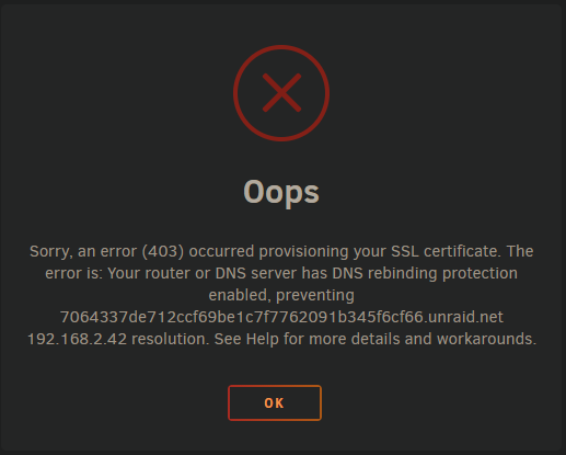

When I try to click the provision button under 'Management Access' for an SSL certificate I get the following error.

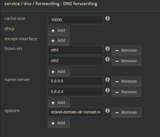

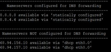

I've tried to follow the suggestion in the help section of unraid, and also from the forums by specifying 'rebind-domain-ok=/unraid.net/' to allow dns rebinding on that address.
You can see I also specify the google DNS servers, which I've confirmed are being used

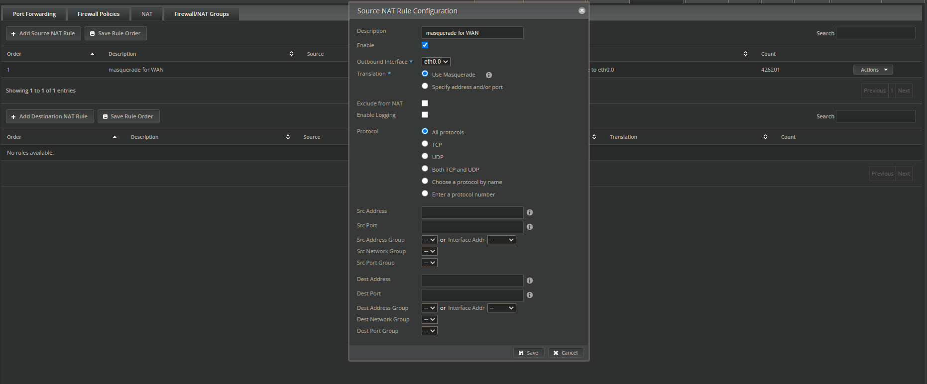

My current path for the server is (Unraid Server) -> (Dumb switch - Eth1) -> (EdgeRouter 4) -> (ONT)

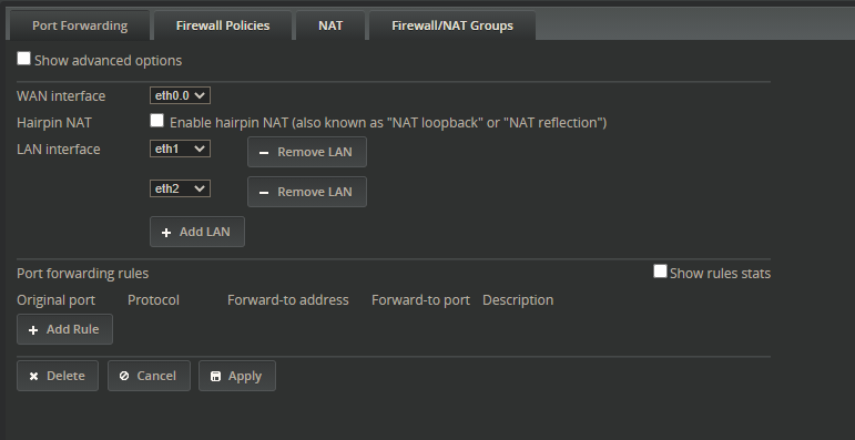

I have hairpin/loopback NAT disabled

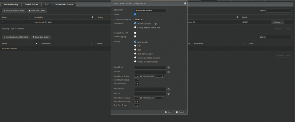

I do have a masquerade for outbound traffic to VLAN eth0.0, not sure if that qualifies as a double NAT.
Edit: I got my set up working without the masquerade, still no luck...

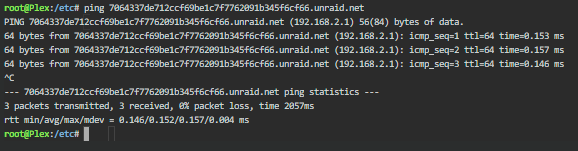

I tried creating an entry at C:\Windows\System32\drivers\etc\hosts on the PC I'm using to access unraid
192.168.2.1 7064337de712ccf69be1c7f7762091b345f6cf66.unraid.net
It doesn't take ~30 seconds to fail like before; it responds in less than a second but I still get the same error.  I've verified my machine resolves the address properly.
