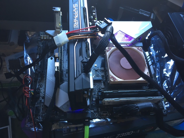

Yesterday the HBA pre flashed appeared so I started creating a test server using the PCIe Expansion cards:
Slots used in order:
slot 1 a x1 slot so the usb 3 card has been placed.
slot 2 the 1st x16 slot that is where the GPU is Placed.
slot 3 a x1 slot not used due to GPU covering part of that slot depth.
Slot 4 the 2nd x16 on PCIe v3 so x8-4 one or the other, but the HBA is placed.
testing components:
PSU: CORSAIR CV650. (had a while for testing)
RAM: 8gb 2400mhz (x2 4Gb make Ballistixs, found really cheap on ebay 2nd hand).
STORAGE: X1 4TB HDD X1 2TB HDD & X1 SATA 2.5" SSD 240GB.
COOLING: AN OLD NOCTUA HEATSINK AND FAN. (I knew I had in trhe loft somewhere).
CPU: 7th gen I5 7500, 9th gen i7 9700k (Ebay on the extremely cheap for the i5, colleague work for the 9th gen i7).
MOTHERBOARDS:
SUPERMICRO C7Z270-CG-L, ASUS Z170 DELUXE,  ASUS PRIME Z390-A.
         Ebay                                    amazon uk        Same colleague from work.
Refurbish "grade B".                       2nd hand          2nd hand known history.
GPUS: x1 EVGA 1070ti and the AMD Raideon Sapphire RX 580 (both with 8Gb video memory).
PCIe CARDS: x1 USB3 card and the HBA.
Windows as above, summery:
Supermicro ...CG-L: Would work getting to the bios and worked within the bios but any further in the boot up process would result in a complete lock up. So after trying different ports and usb drives even tried installing via dvd installation disk, offical and home made. Results still no go. no visible damage to hard ware.
Asus .... Deluxe: Installed windows as expected and both videos cards ran as how would expect and no issue installing the drivers.
Asus .... -A: installed windows as expected but the drivers was made really easy one piece of software that windows found and the drivers where installed. and both videos card ran without a problem.
hence the conclusion of acquire additional drives and case and we have both a work NAS & VM running as my desktop.
Now since we have most of the parts a media server but running off the ASUS Z170 deluxe.

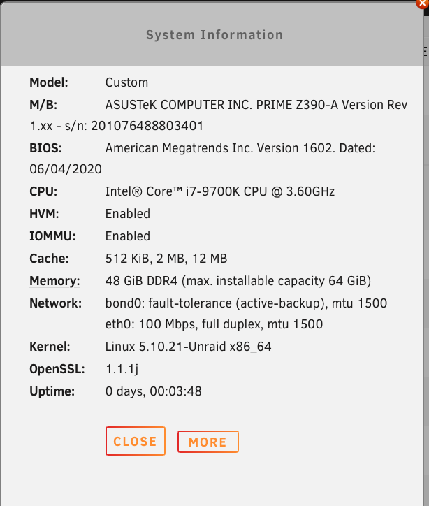

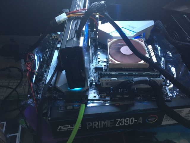

So, Yesterday spent setting up the the ASUS Prime z390-a up as a test server with unraid, I wait for the sync to complete. and the additional plug-ins and set up a temporary share and user. but the hitch being this server is running 6.9 and the one I have and is the main server is running on 6.8! is there a way to upgrade to 6.9 since when I put the server together I had installed on a 6.9beta then downgraded too 6.8 is there a way of me to upgrade to 6.9 when I not sure that it has been a year between the two.
Today: is setting up the VM and testing the it.

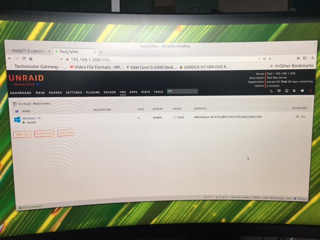

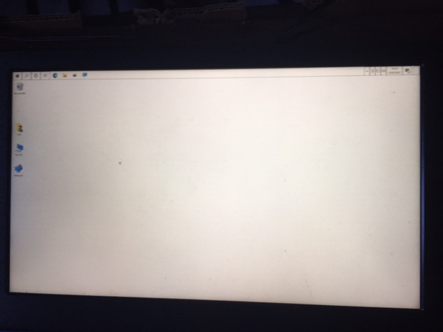

I set up an i400fx* vm with 4 codes and 1/2 the ram (4GB) with the usb card passed through. This was insstalled onto a 240GB ssd which also was passed through using path:
/dev/disk/by-id/ata-CT240BX500SSD1_2045E4C4F00F
since I am happy with the whole drive being passed through.

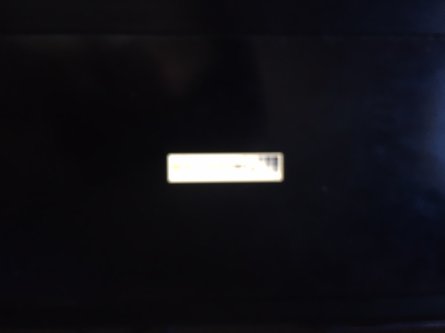

the result being with the amd card lock up on boot when the gpu was passed through
the nvidia card not yet tested.

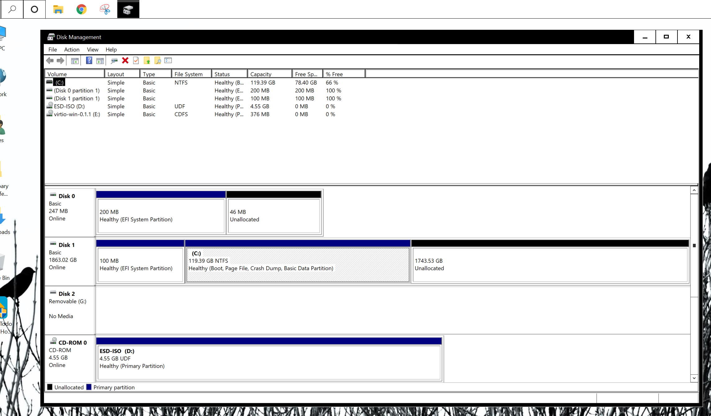

So I tried again with the Q35 machine and it install the amd card graphics driver without a hitch and did not freeze after installation.
so powered down and rebooted the VM and still works there is progress.
So now I have powered down the VM and server I have also turn the PSU off and have waited over an hour now I am going to try and start it up once more.
That to has worked this had never progressed this far before!

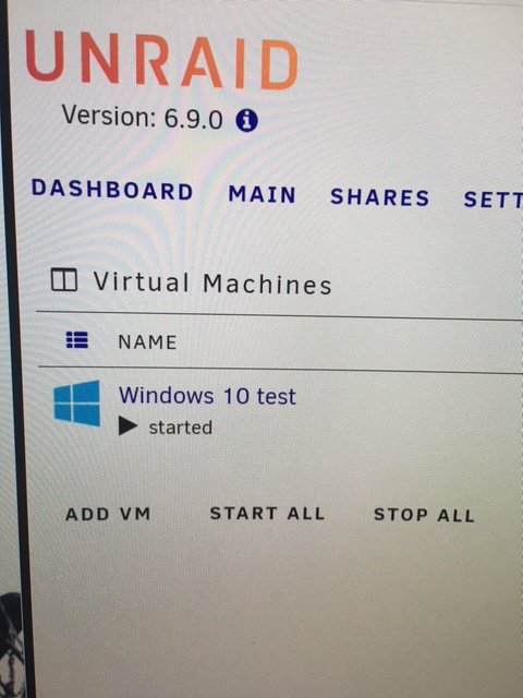

Hello, A small up date just turned the server and power on the the VM. and it booted up a okay :)
it is still has the AMD Raaideon rx 580 in place, i am on going to give it a week and then do the same with the 1070ti.
but there is the variable of the test system is on the stable 6.9 release and the 7700k system with the issue regarding vms is on the stable 6.8.3 release.

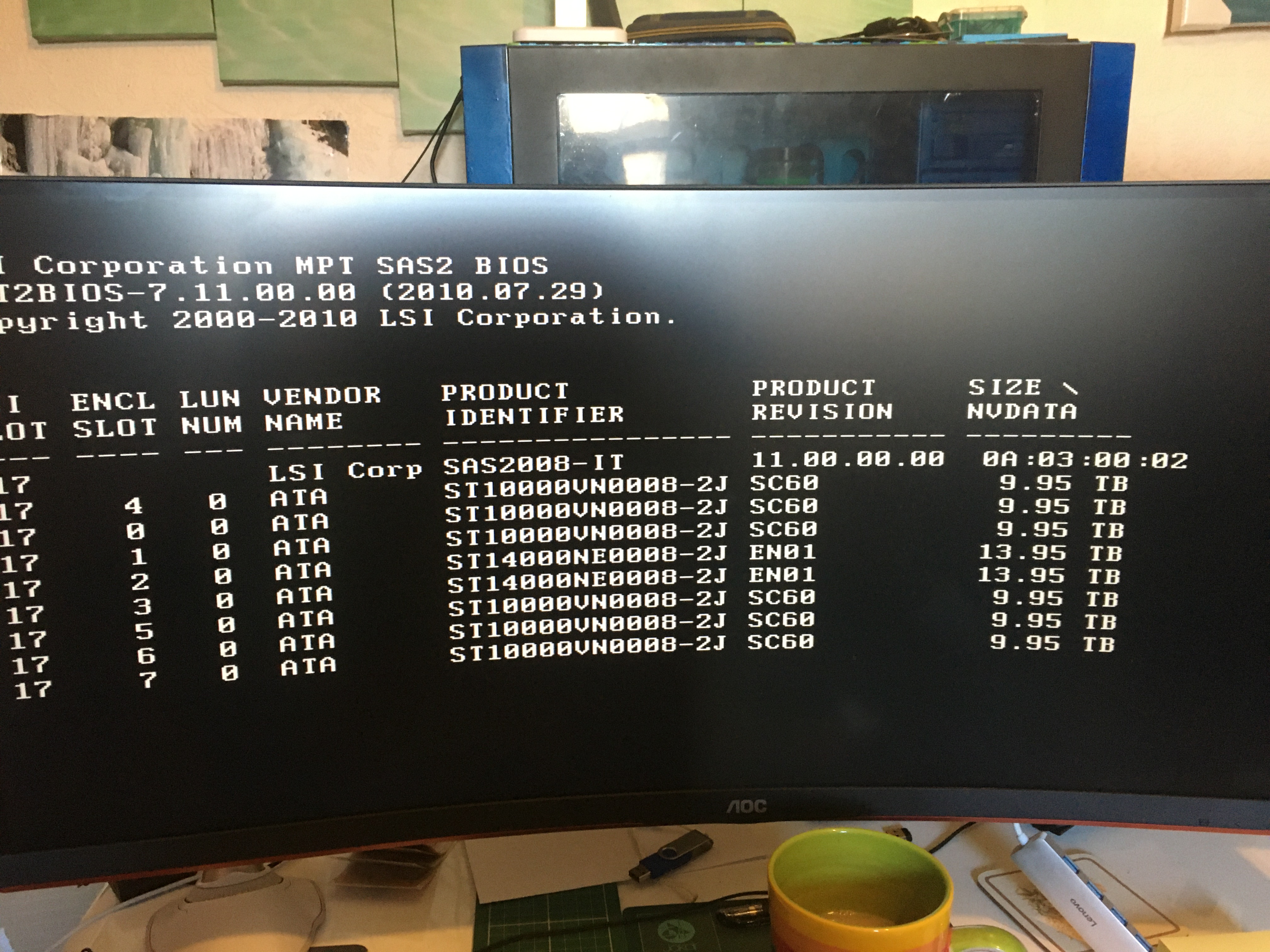

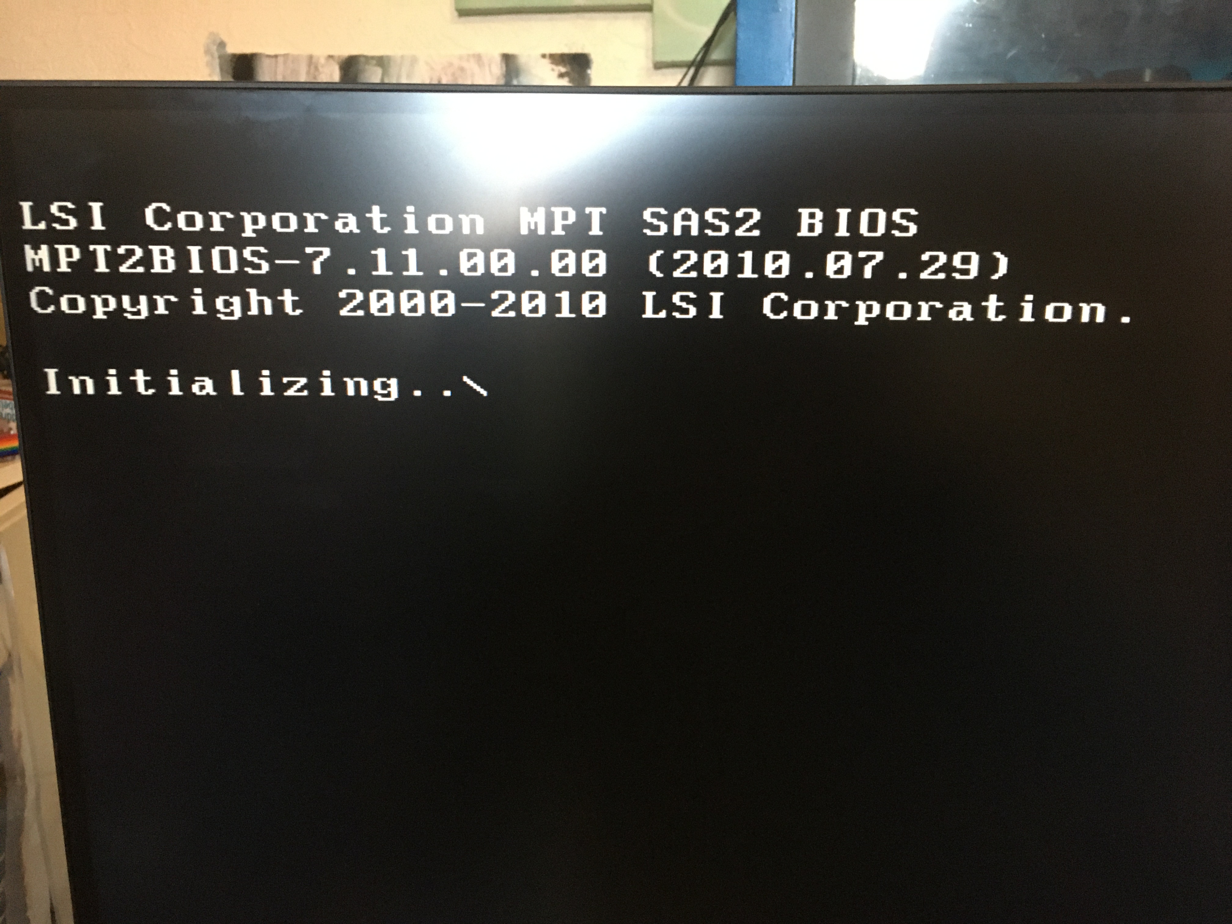

Please Help!!!
I have spent the day switching over the motherboard, CPU, Ram and connecting the HBA and just booted up the sever to find found two data disks. the parity drives and 4 more data disks are gone, but it is all wired up/connected.
Why is nothing going right, it was working fine with the test sever so why when put into the case and hooked up to a bigger power supply with two more sata drives and the m.2.
Please, Please any help is great here.

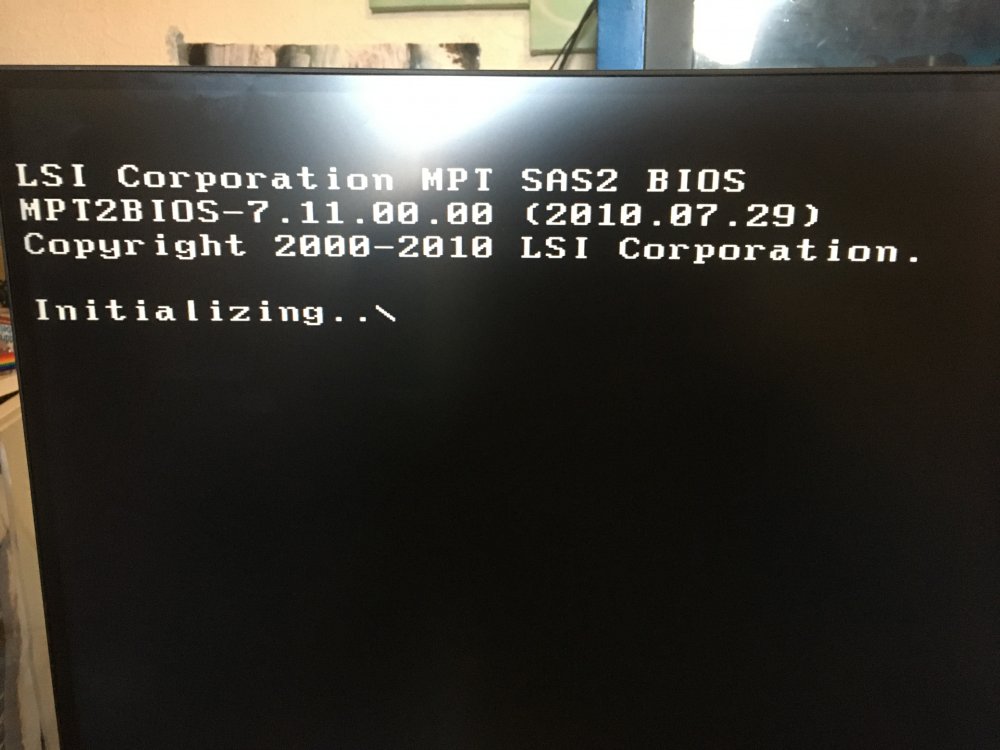

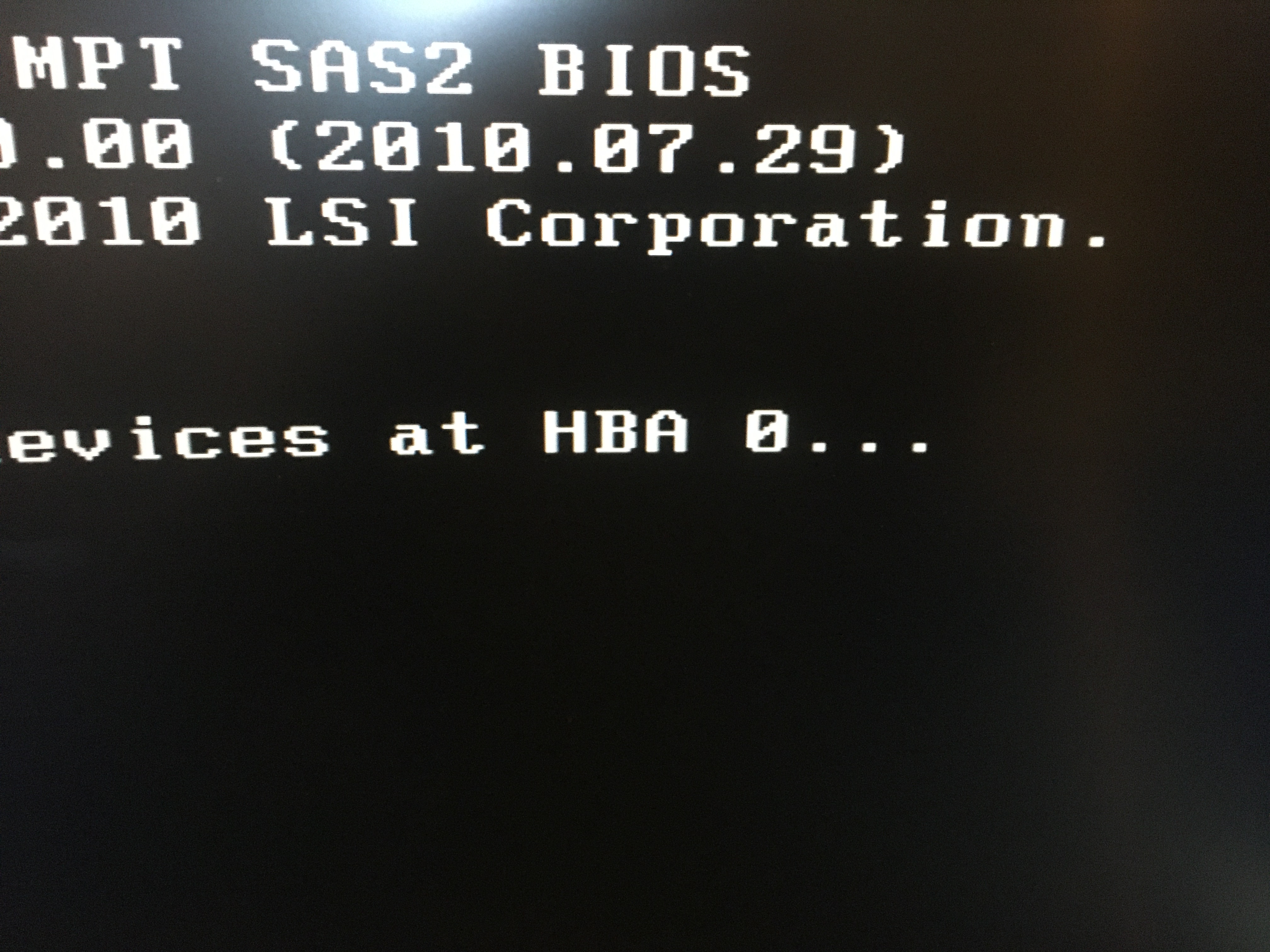

So installed the i7 7700k into the Asus Z170 Deluxe and placed into case with HBA fail to boot... ?!
So Installed the i7 9700k and the Asus Prime Z390-A

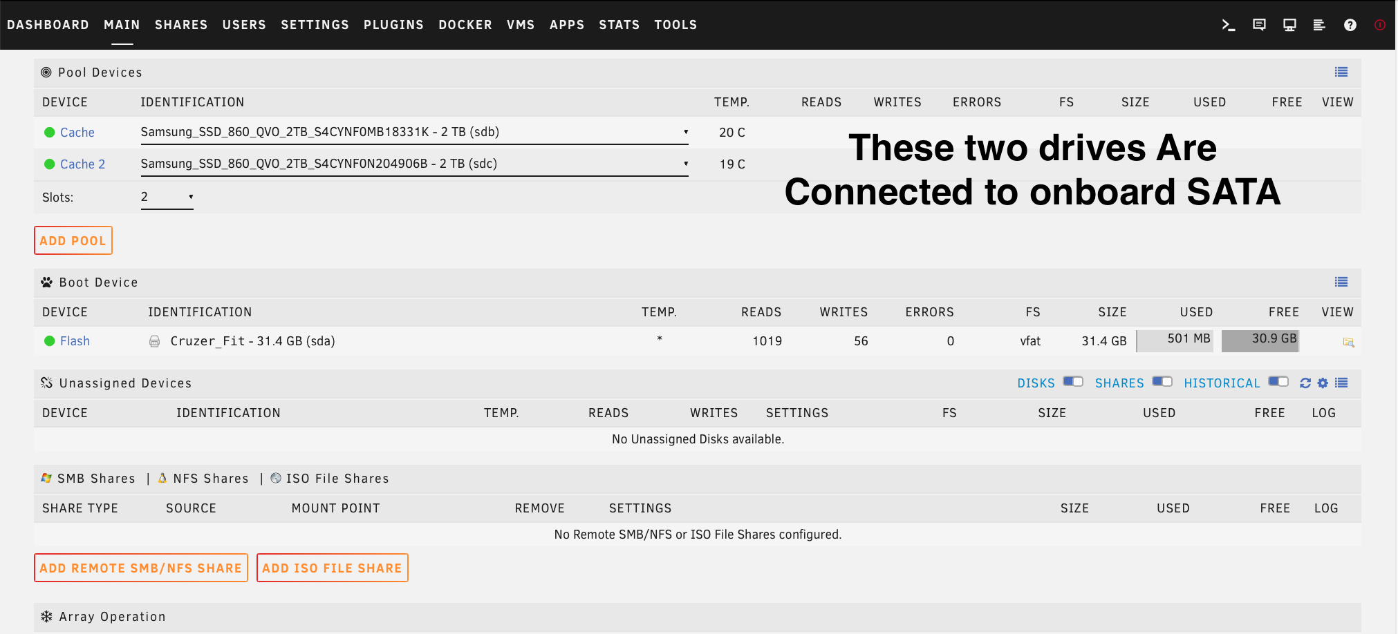

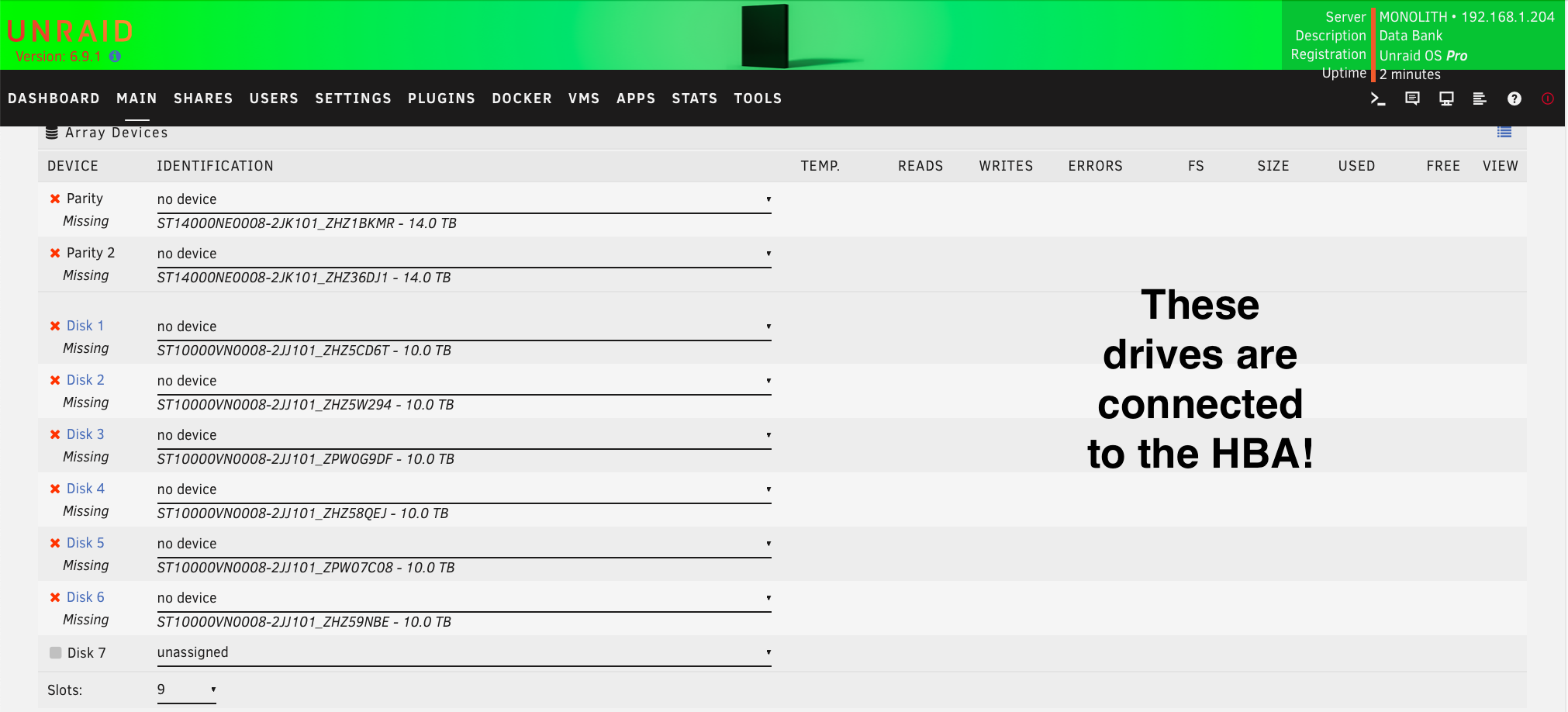

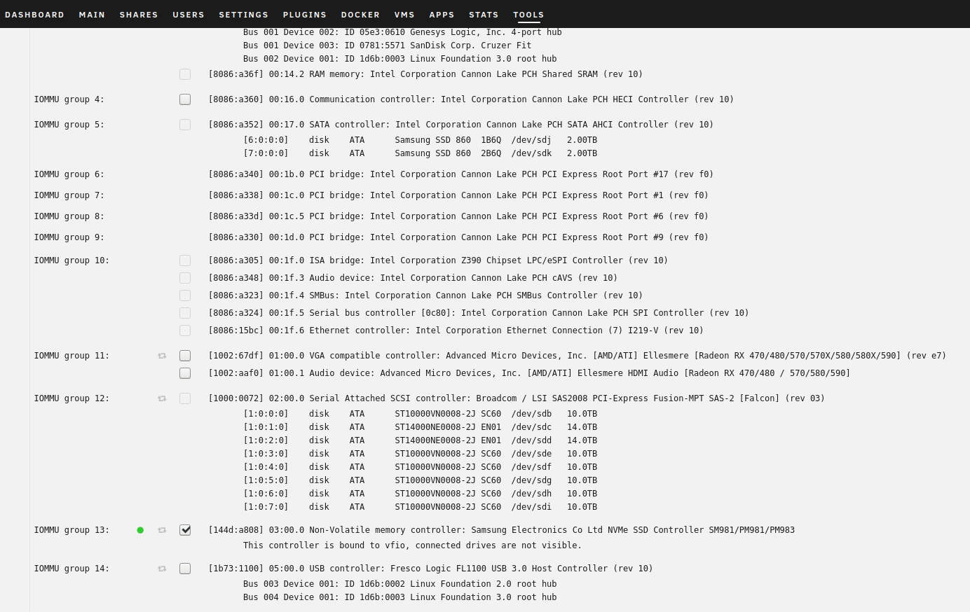

Outcome: Parity & Data drives not showing unraid says missing!
cache drives and USB show due to onboard Sata and USB ports used.
VM's unable to test.

 running NAS but no VM Problems still present.
I cannot work out why the HBA and the new motherboard worked with the test configuration and the test USB but put into the a PC case and hook up the x2 14TB x6 10Tb and two 2Tb SSDs and no array.
so unable to access data on the drives and unable to run a VM!!
It was just a straight swap and it was working on the test setup and looked like issue solved, but now not even the NAS side is not working.
I have got a replacement HBA on the way. To see if this a way forward.
But I am really, really stuck!!!! Please, Please Help!
Hi again,
Seems like you're just destined for problems with this setup!  Whenever you make a hardware change like this and need support though, you always need to attach a new copy of your system diagnostics.  The issue you are experiencing now is different than what you originally experienced, so you need to get us new diagnostics so we can analyze.  There are a few things that could be going on here, but without that zip file, we cannot analyze.
Hello
Yes, But I really thought I was going to get some where when the I had it on the test setup it just worked! I guess as it should but installed it into the case, connected the drives to the HBA and two the cache drives on to the onboard SATA and powered on.
Then it booted up fine and then went to the web GUI and no array :(
I have enclosed the zip file you require.
I must be close since the HBA worked with 2 drives connected (WD red 2&4Tb) and I got a working VM with the AMD Card and it booted fine after the drivers installed and passed the milestone of booted back up after a full server shut down and boot up after a good few hours in-between.
monolith-diagnostics-20210322-2233.zip
Hi again,
Looking at your diagnostics, I see the following HBA's installed on your system:
00:17.0 SATA controller [0106]: Intel Corporation Cannon Lake PCH SATA AHCI Controller [8086:a352] (rev 10)
    DeviceName: Onboard - SATA
    Subsystem: ASUSTeK Computer Inc. Device [1043:8694]
    Kernel driver in use: ahci
    Kernel modules: ahci
02:00.0 Serial Attached SCSI controller [0107]: Broadcom / LSI SAS2008 PCI-Express Fusion-MPT SAS-2 [Falcon] [1000:0072] (rev 03)
    Subsystem: Broadcom / LSI SAS2008 PCI-Express Fusion-MPT SAS-2 [Falcon] [1000:0072]
    Kernel driver in use: vfio-pci
    Kernel modules: mpt3sas
The latter of which is being stubbed by the vfio-pci driver.  Navigate to the Tools > System Devices page and uncheck that controller from being stubbed, save the setting, then reboot.
Hello.
:) THANK YOU! THANK YOU!!! :) :) the array is back!!! :) :) THANK YOU! THANK YOU!!! :)
I have just done as you said and yes that is the case. I have not been in there post update to 6.9.
I wonder if the HBA has the iD or path that the USB card had before on the Z270 chipset with the I7 7700K?
because when I was there I had a looked and the USB card that was stubbed in 6.8.3 is currently not?
But the HBA was and in 6.8.3 the m.2 and the USB card where the only two items stubbed in the configuration.
Has this sort of mistaken identity happened before?
I would of never of guess to going and look at the stubbing settings!
Post OS update. The HBA was stubbed makes perfect sense, for what I was seeing, why didn't I think of checking those settings???

The next thing the USB card and the passed through AMD Graphics card are still working since I am able to access the keyboard and mouse and the other USB devices and I am still getting a output from the graphics card.
Since I found the workaround I was able to get the M.2 boot drive through Spacesaver One's adapted clover image. it is now booting off the m.2 and the machine type is Q35 and is running like a standard PC!!!
So, I have gotten to where I wanted with the Desktop PC and NAS storage for the household
in the computer!!! I have finally made it Since all the Issues. I am going report back in here in a few weeks to report in for the reliability of the VM.
But it is finally working, Thanks again for all the help! It has taken sometime, but I have a working Windows10 VM and a Working UNRAID NAS storage :)
WE MADE IT! :)
