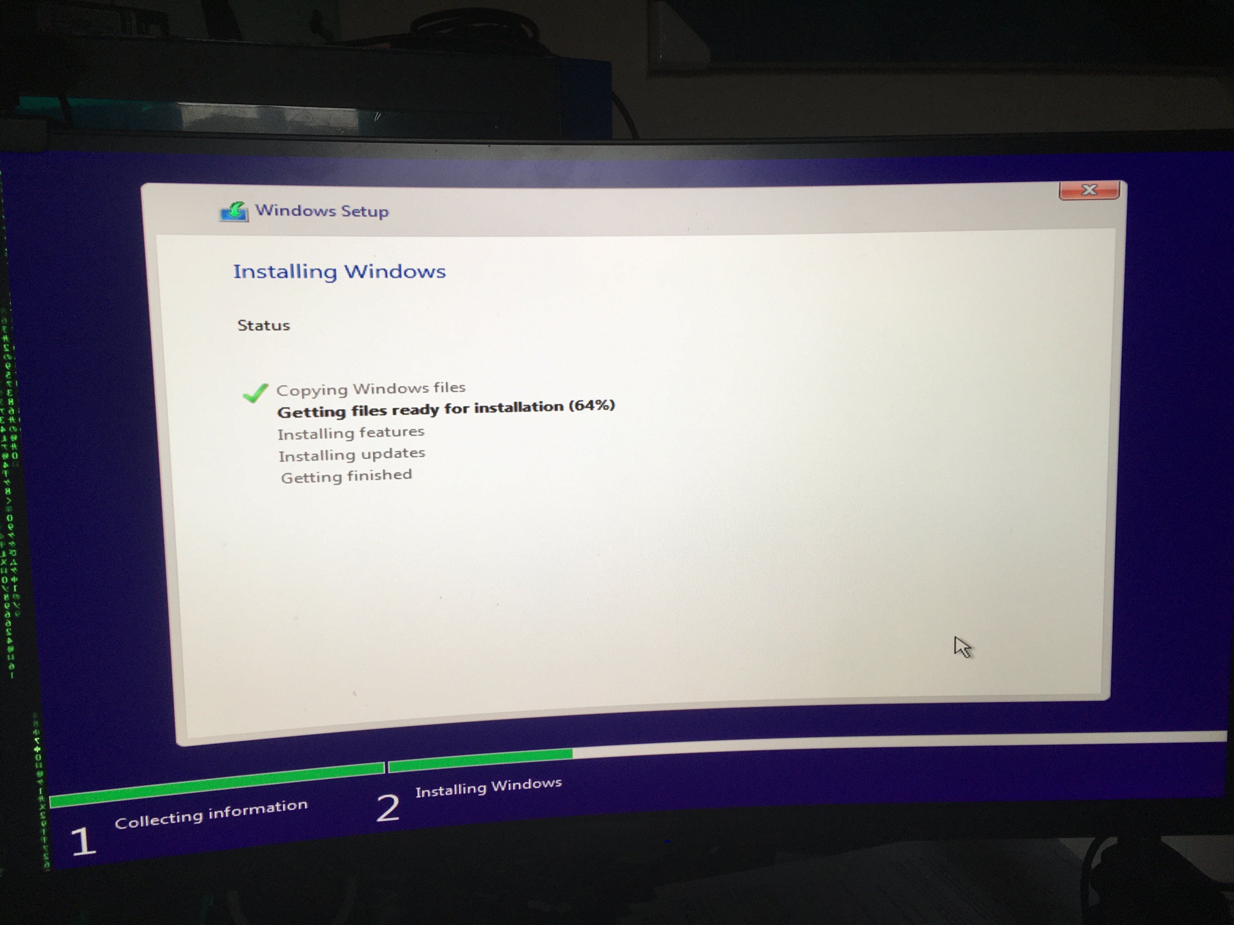

the farthest I got so far is I got to the windows installer choose a C : drive location and entering a licence key then it rebooted a few mins after and then I got to a UEFI shell text screen that doesn't seem to go any where

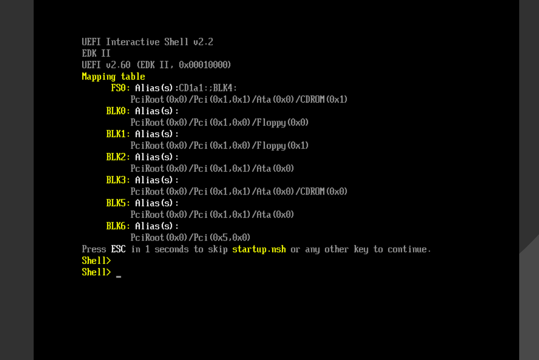

This is when I 1st encountered the UEFI shell text screen after you hit any key to boot from cd
and it responded by putting up a text screen which doesn't seem to respond to the keyboard i tried hitting ESCAPE and typing exit to no luck there?

Sorry about that. I have a bit of an update I had to start with making a virtual drive which the video later copies over to the m.2.
I got passed the windows installer and when I got to the drivers the display driver started updating and then it crashed!

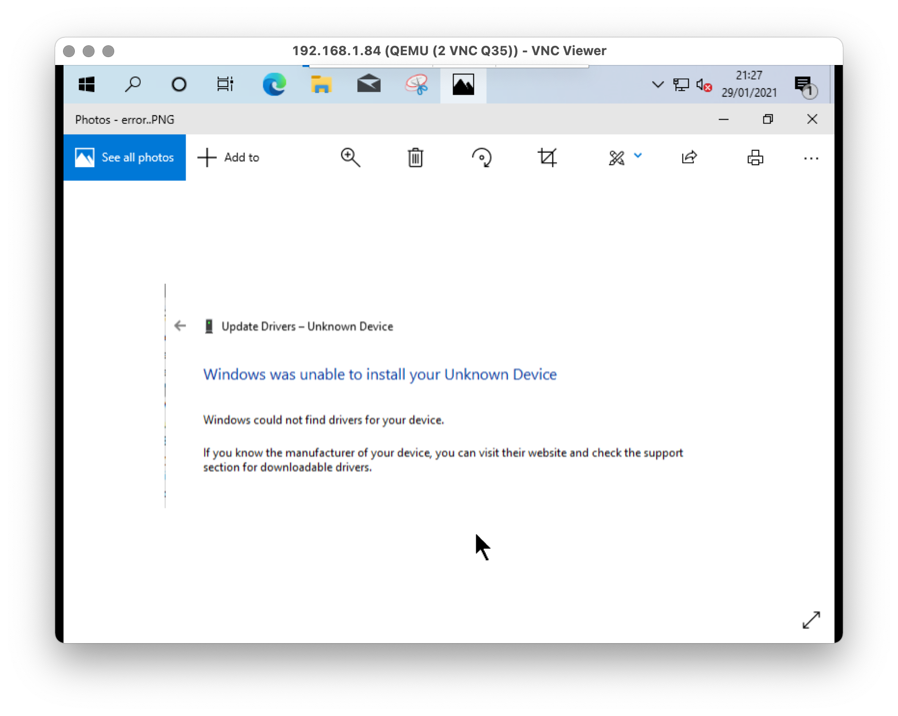

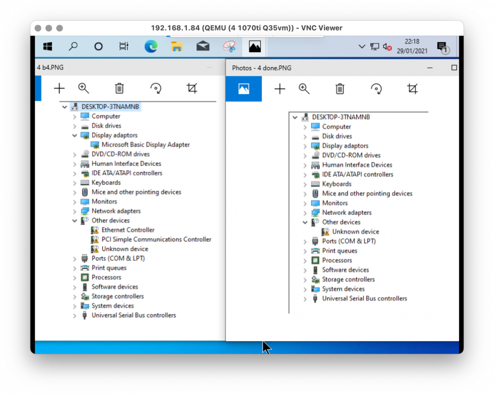

Also, this seems slightly to be different, as I got into a completely fresh installed desktop screen.
but the networking drivers, and a system device where missing
so I installed the drivers from E: virtio-win-0.1.173-2
which looks like there are working fine.
but the display driver is Microsofts own basic display driver.

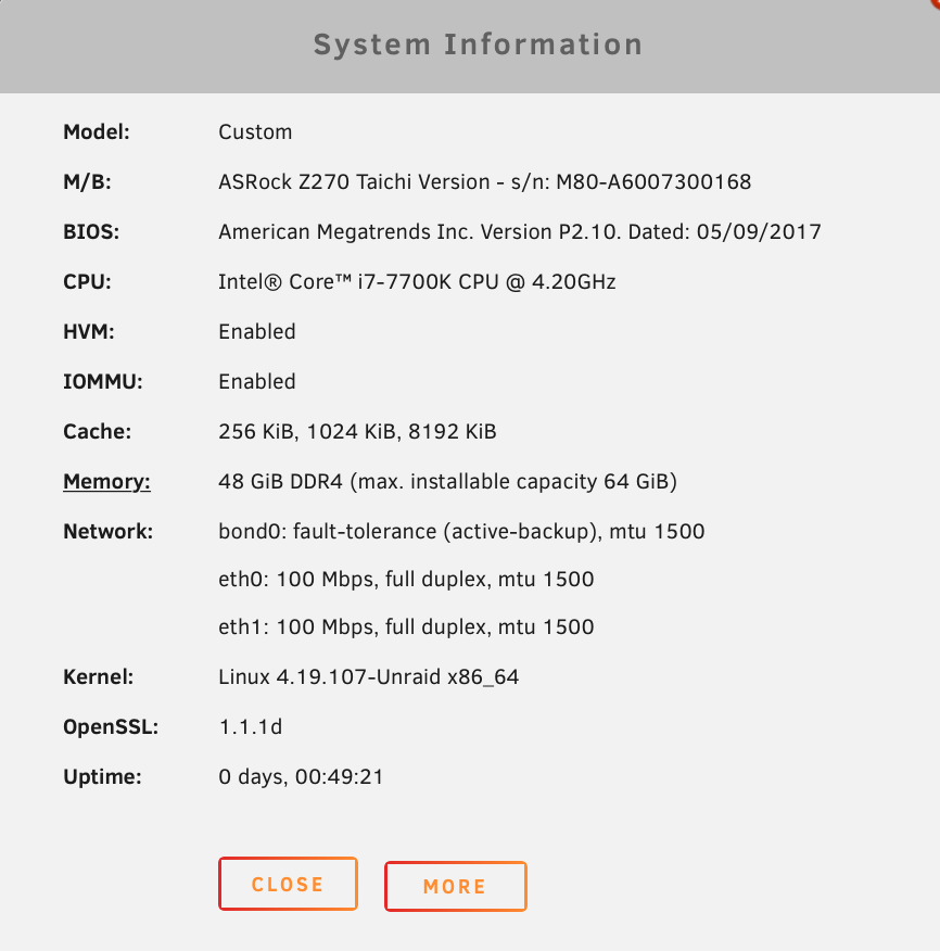

VT-D & VT-X are enabled in bios and is shown in the info
The Primary video device is set to onboard in the bios.
I had to use the PCIe ACS override and this is set for downstream.
to get the USB3 card and the Samsungs SSD's to show in the other PCIe devices box.

I selected the hardware i wanted to pass through and got the UEFI shell mk II screen and couldn't progress so had to force quit the vm.

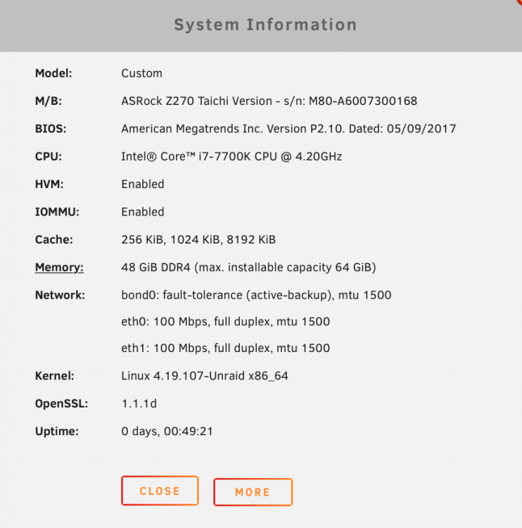

In this I have got into building computers recently. the most resent is the NAS. I have managed to get working a water cooled gaming rig
and the test rig trying without much luck the photo editing and ms office on linux rig with a copy of adapted windows mainly a lot more scaling with the high contrast and speech out put enabled.
to help as a quick way to getting to the unraid web interface via getting the ip address from the router. Also to help me out with the terminal I have just setup a raspberry pi

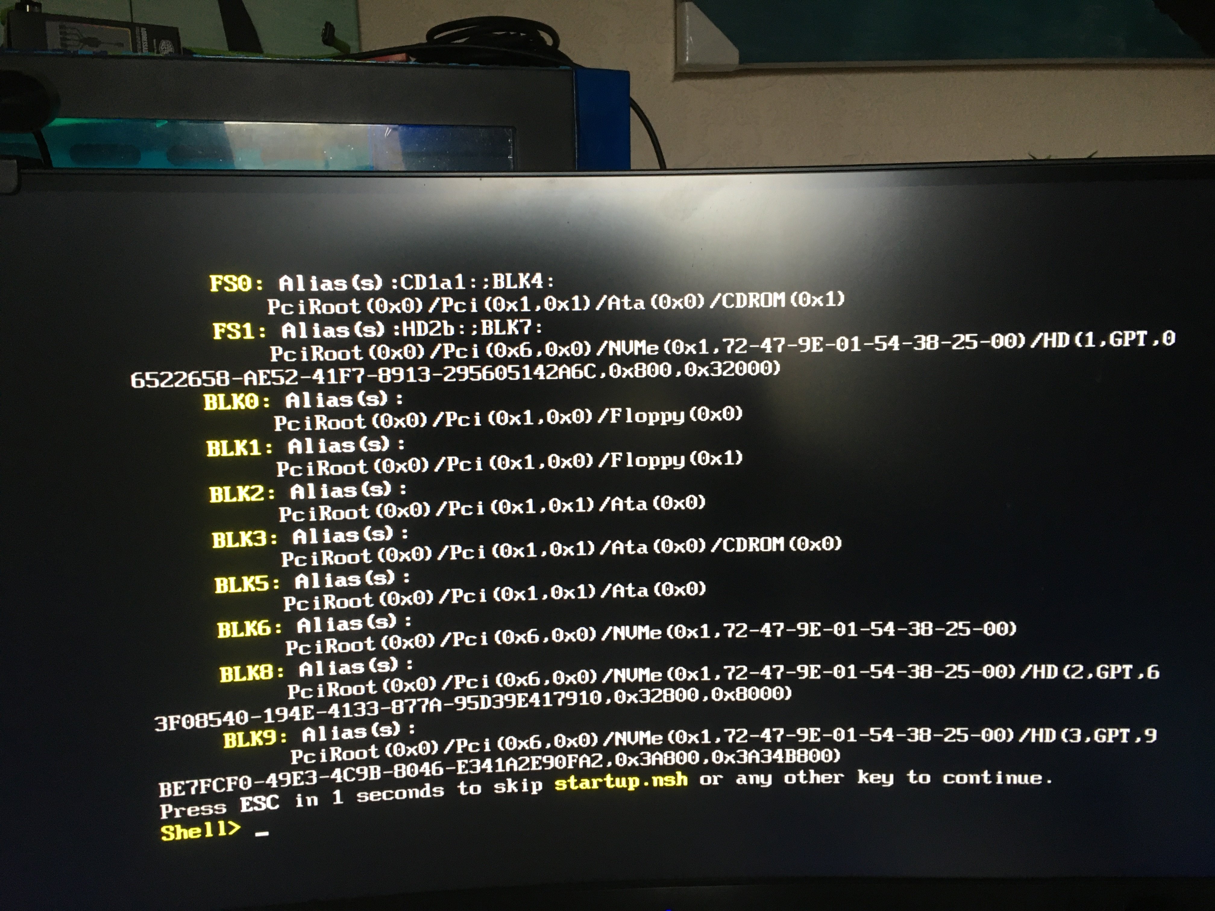

So, sorry I forgot the UEFI Shell MKII screen. This is how most of the vm boot up end. :(

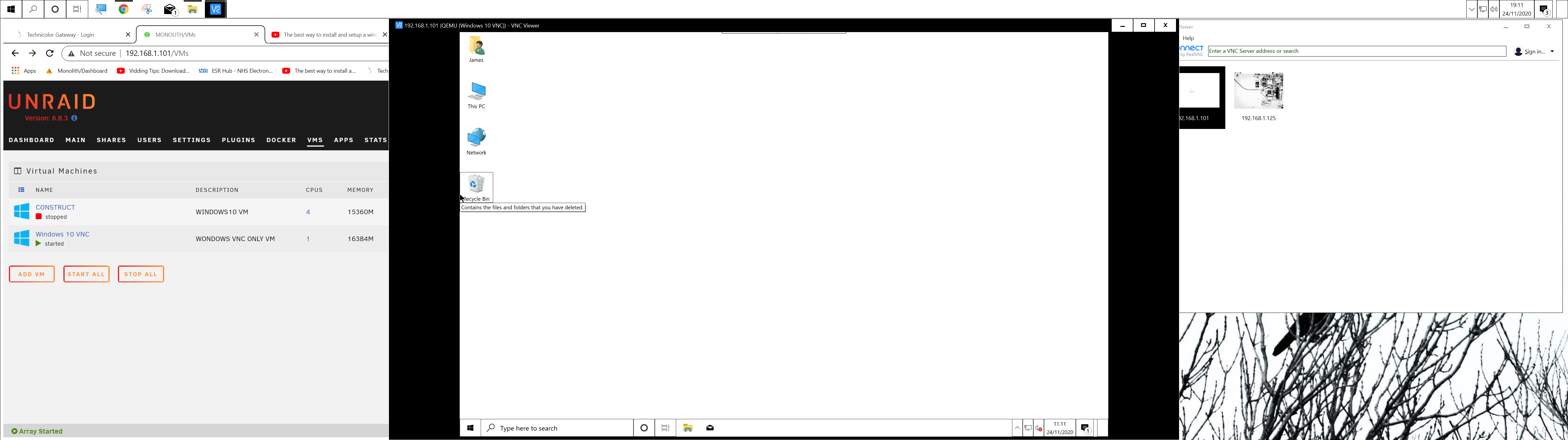

I am going to try to see if The VNC is stable.
but please please help.
I am getting really stuck. :(

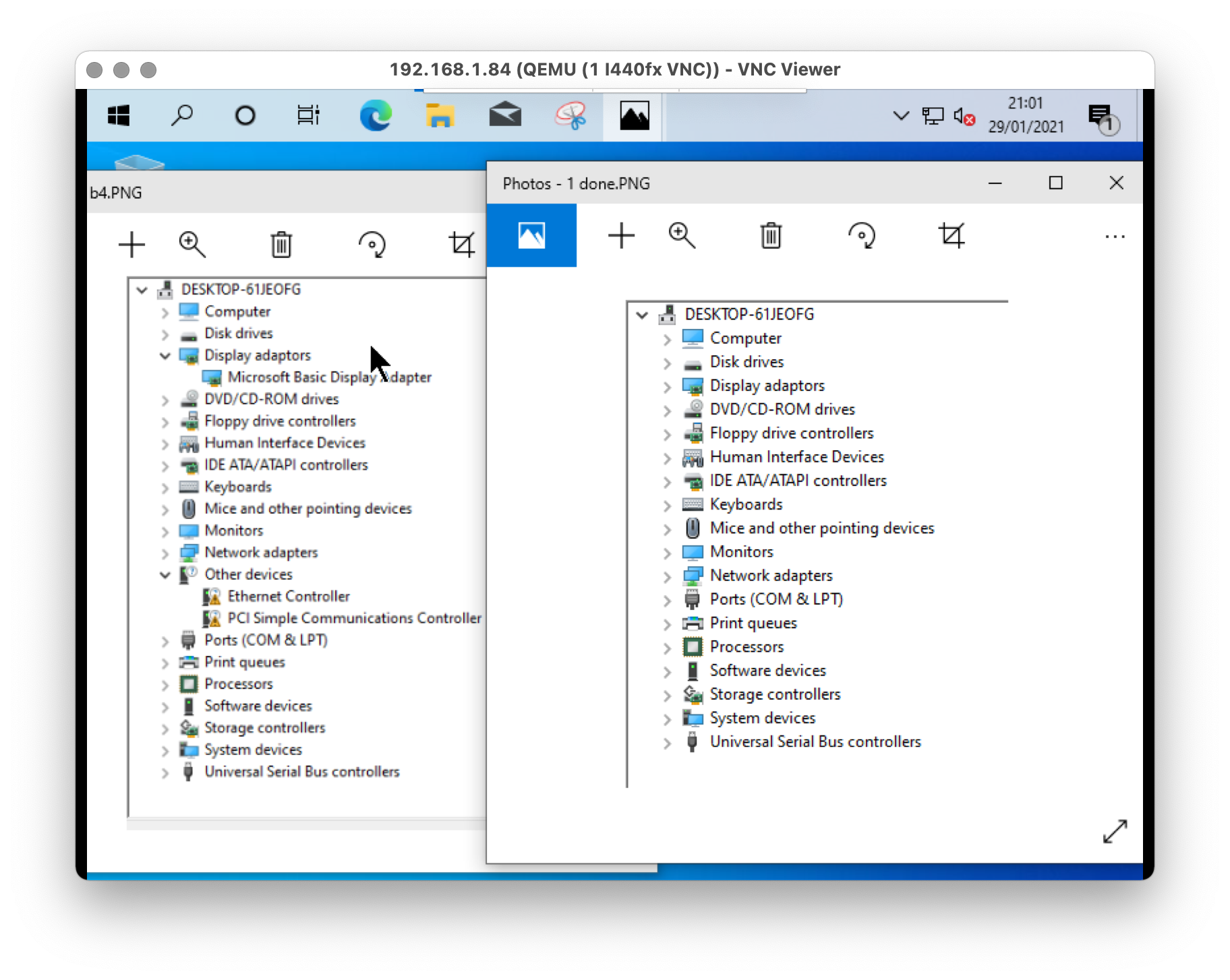

Update I have got a stable Windows 10 NVC vm up and working :) Now to get the hardware to passthrough ?

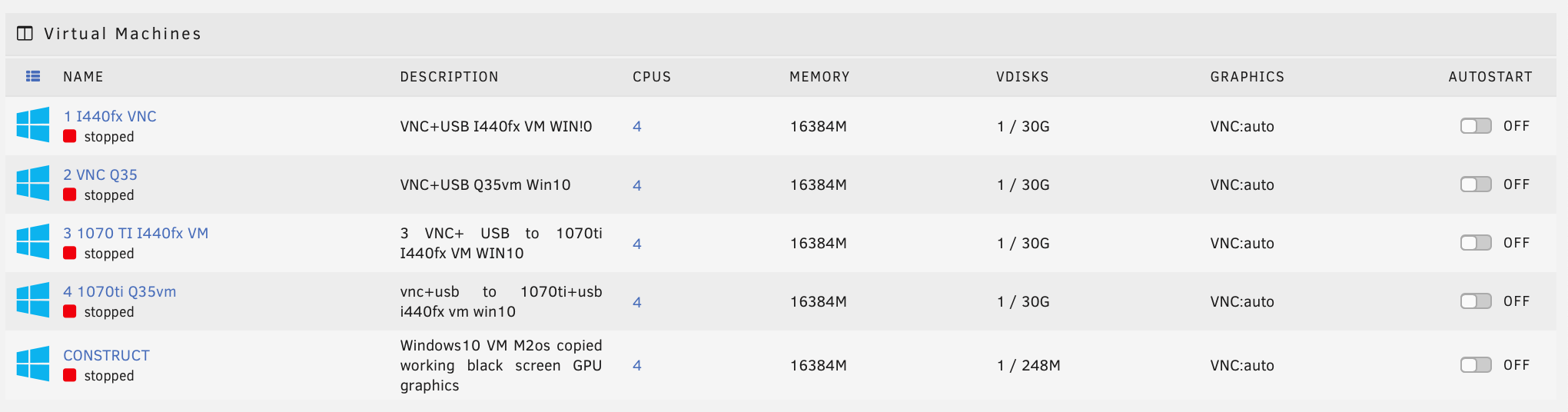

I followed the steps taken to get a VNC vm to work which goes with no problem, even with the additional USB controller and the M.2 SSD (in an unformatted state).
Then, when I passthrough the graphics and sound the I440fx gives up when the new driver is being installed.
thus making the screen go black and the display never returns.
So, as suggested to run the machine as Q35 and the display flickers but returns back to a typical display.

Hi there,
I can almost guarantee you the issue is related to the GPU you are trying to use.  AMD has been notoriously bad for supporting virtualization on their GPUs and the community has gone through great lengths to make quirks and workarounds to accommodate this.  The easiest solution to your problem would be to purchase an EVGA GTX-series (or RTX-series) GPU and use that instead.  I really wish we had a solution for the GPU you're using, but it's a hardware-specific problem that doesn't offer a simple solution for us to implement within Unraid.  All the guides you've tried are the same ones I would normally have suggested, so if you've gone through all those and still don't have a working solution, I think you're going to need to try a different card.
One thing worth noting is if you get stuck on the UEFI BIOS screen, you can navigate into the FS devices:
fs0:
cd boot/efi
bootx64.efi
Those three commands usually work but you can also type 'dir' or 'ls' to list out the directory contents of those FS devices to find that .efi boot file you need to launch the OS.  Not sure why VMs get stuck their at random.

On this note I have even tried putting in another low power graphics card in the 1st PCIe x16 slot to see if that will help things along.
which resulted in the same result blank black screen or uefi interactive shell or no guest agent installed :(
the m.2 drive when I try and move to the clover image after cloning the vdisk to the m.2 I just seem to get a guest agent not installed screen which I know there was on the m.2 or it is back to the UEFI interactive shellv2.2 screen.
which seemed to be frustrating because I couldn't see any guides as how the shell  apart from a post in this site which describes as the fall back interface if the vm is deemed to be empty. Thank you again with the there command lines for me to try when I next come across this screen because since this is new to me when I hit that screen any command I tried from old dos commands or the very, very basic linux terminal commands I know just seemed to add a new blank line what always started as "Shell>".
Which the only option for me at the time was to delete the vm and start again.
So I will try the:
fs0:
cd boot/efi
bootx64.efi
commands thank you again.

System:
intel I7 7700K, ASROCK Z270 Taichi (which I picked out for the ten SATA Ports),  48Gb DDR4 Ram 2666mhz but set 2444mhz. storage x2 14tb ironwolf x2 2tb samsung Qvo Sata SSDs, x6 10tb ironwolf, x1 1tb m.2 samsung 970 (for Windows vm) xi 500gb m.2 same unit (hoping to get a linux mint vm running off here) and a Corsair 1000watts RMI.
Had originally for GPU AMD Raideon Sapphire pulse RX580 8GB.
(thinking here must be simpler to pass through as didn't need to mess with Bios Roms, Plus the 8GB for photo editor plus zoom text and the OS).
But now have installed Nvidia EVGA GTX 1070it SC 8Gb.
( as you mentioned go for EVGA GTX/RTX, I also had to find a card that was 8Gb).

I have set up the 4 vm's they are:
  • 1 an i440fx vm with vnc+usb Win10.
  • 2 an Q35 vm with vnc+usb Win10.
  • 3 an i440fx vm with vnc+usb win10 (when I have a monitor I will passthrough the EVGA 1070ti gpu).
  • 4 an Q35 vm with vnc+usb win10 (when I have a monitor I will passthrough the EVGA 1070ti gpu).
  • CONSTRUCT is the attempt to move the disk to the 1tb m.2 which booted with the VNC graphics when I added the GPU to the Vm after the code error. (multifunction= 'on' /> so found and corrected to 'on'/> ). Then when i booted the VM with the EVGA 1070ti gpu the outcome was a blank black screen. The GPU rom file was the one I edited via a hex editor to remove a refreshing header from the rom that I  download from tech powerup site that spacesaver's one video guided the viewer to.

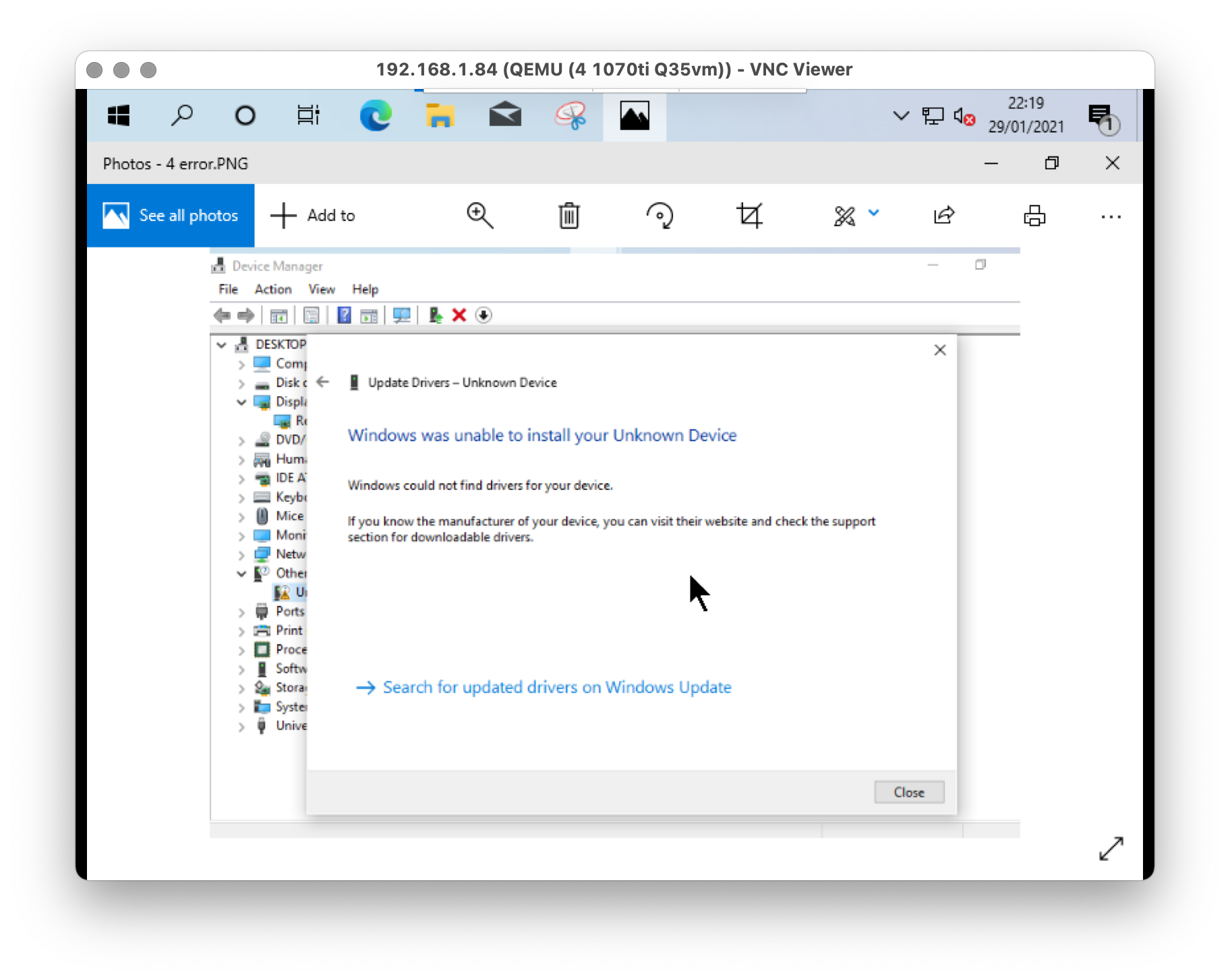

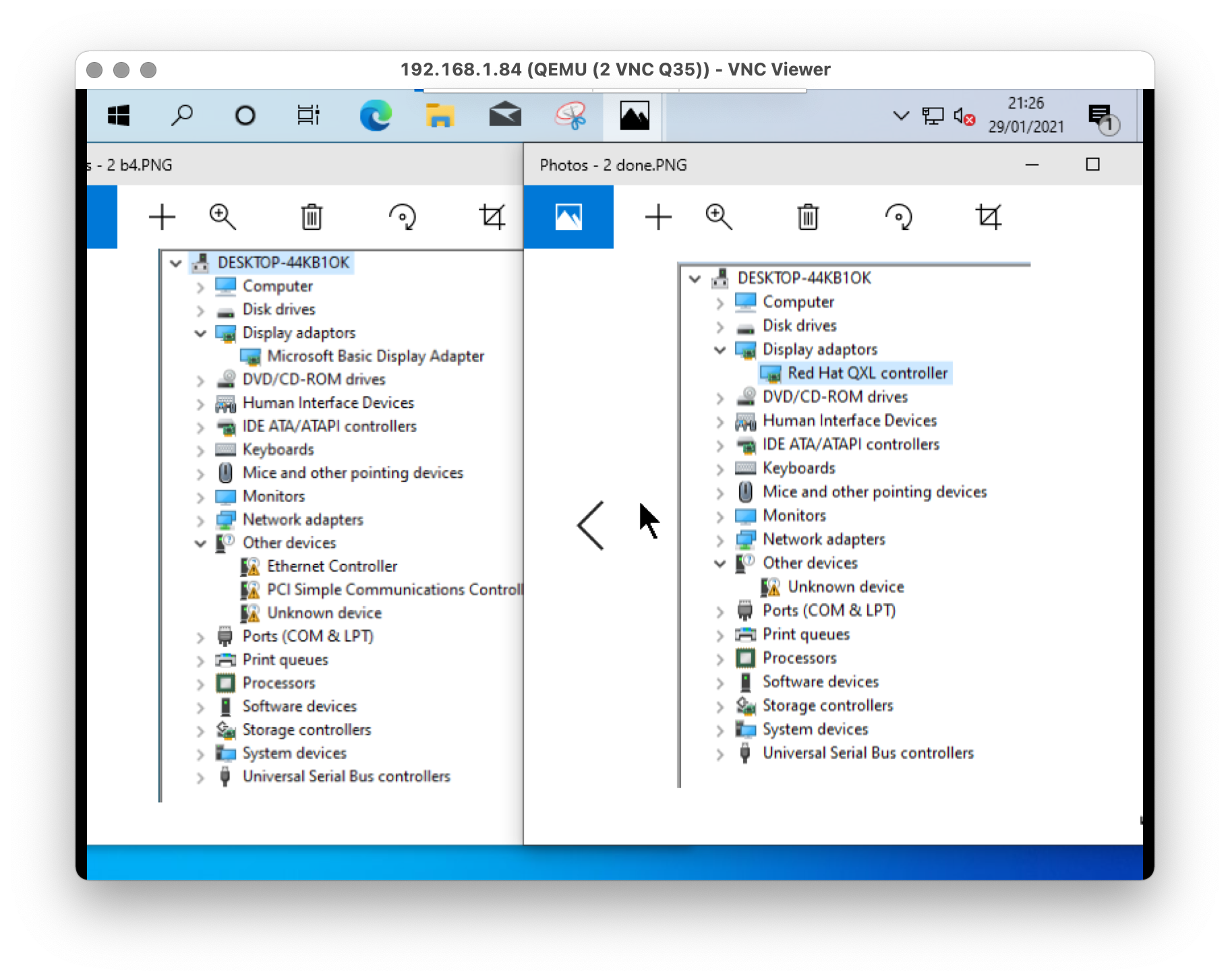

The Q35 vm's had an unknown device that windows could not ID and nor is there a driver on the virtio iso for it either, (Please see attached images)???
  • All the VM's were set with cores 2 and 3 (0 and 1 left for unraid).
  • Ram is set to 16GB.
  • Machine type 1&3 = i440fx 4.2, 2&4 = Q35 4.2.
  • All VM's used the same Windows 10 Iso and virtio iso.
  • All set to VNC graphics and no audio (3&4 will have the EVGA 1070ti GPU passed through).
  • VNC keyboard set UK.
  • Vdisk location set to auto and the auto Vdisk size also the defult value of 30Gb.
  • All had the USB card Passed through via PCFIO plugin creating that profile,
  • Which, the profile is also added the m.2s to list within  the passthrough box but as requested these remain unselected.
  • Also I did not select the auto start.

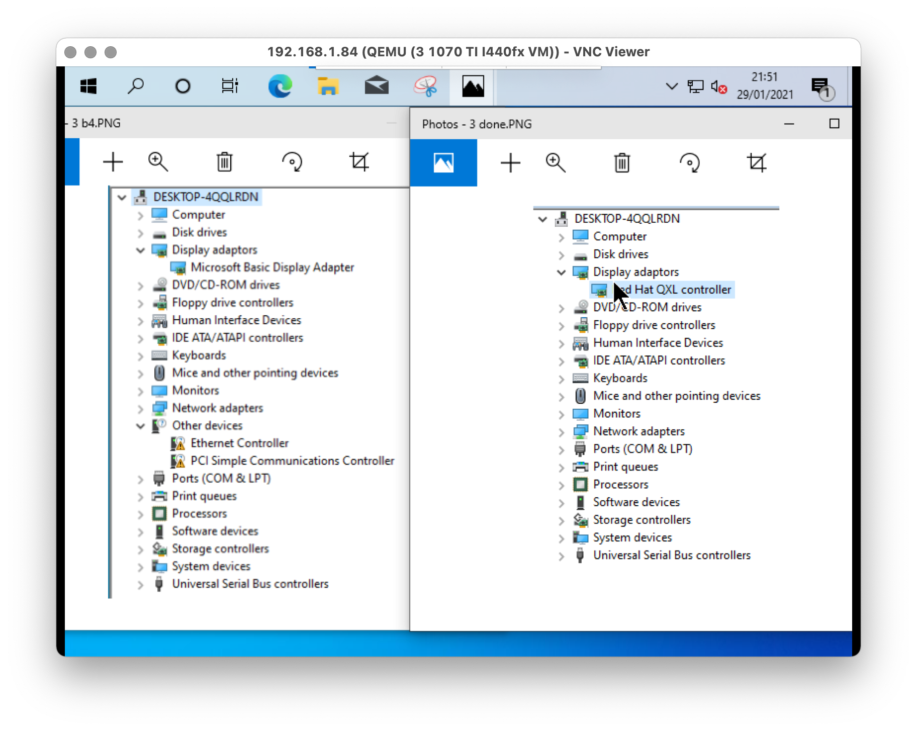

When the OS was installed.
I installed the Qmu agent (v AMD64x83).
Then made the mouse easier to work with for my self (extra large pointer, short mouse trail, ctrl key locator and untick hide mouse whilst typing).
I would also set the high contrast setting (black on white) but left it out this time,  and opted to use the Accessing PC  magnifier to enlarge the text and increased contrast and a colour filter to remove colour (mainly reds) from the display image on screen thankfully it doesn't affect the screen grabs.
Then I moved through the device manger on the VM (networking device, system devices, display driver in that order).
I also reset the basic 600x800 screen resolution, to ease the work load on the system and keeps the text larger too.

Now I am playing a waiting game for the monitor to arrive over the pending weekend, to enable the GPU passthrough on VM's 3 and 4.
I will ensure that the GPU video and audio are assigned to the same slot (know I know how and the problem it causes) in both of the GPU passed through VM's, which I yet to add to the VM check list (enclosed). I have enclosed a screen grab of the device manager in each vm and the Q35 unknown device error.
I have also attached the list on current vm's on the unraid server.
I also have rewatched the spacesaver one video on advanced gpu passthourghs and I did not catch before is there a real difference having the the server boot in Legacy over EUFI? and if so how do you go about applying that switch, as the video guide only highlighted this but has not really covered how???
I created the four VM's, so, we can see which is more problematic or the more fixable and stable in the long term. because I intend to have the VM become my PC in the long term. The pervious update I tried to hopefully put down the previous experiences with the AMD card i hope in way that is more streamlined.
