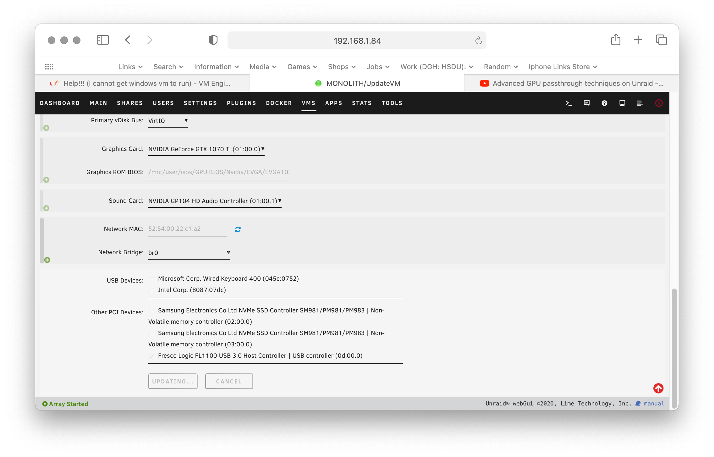

Now I am facing another issue when I come to passthrough the nvidia gpu the web interface seems to freeze and the changes I am implementing are being disregarded. I get stuck with this screen, any advice?
The browser is firefox for mac.

Update. I still do not know why the webgui frozen when I tried to apply the gpu passthrough.
Please I took a screen shot of the frozen webgui.

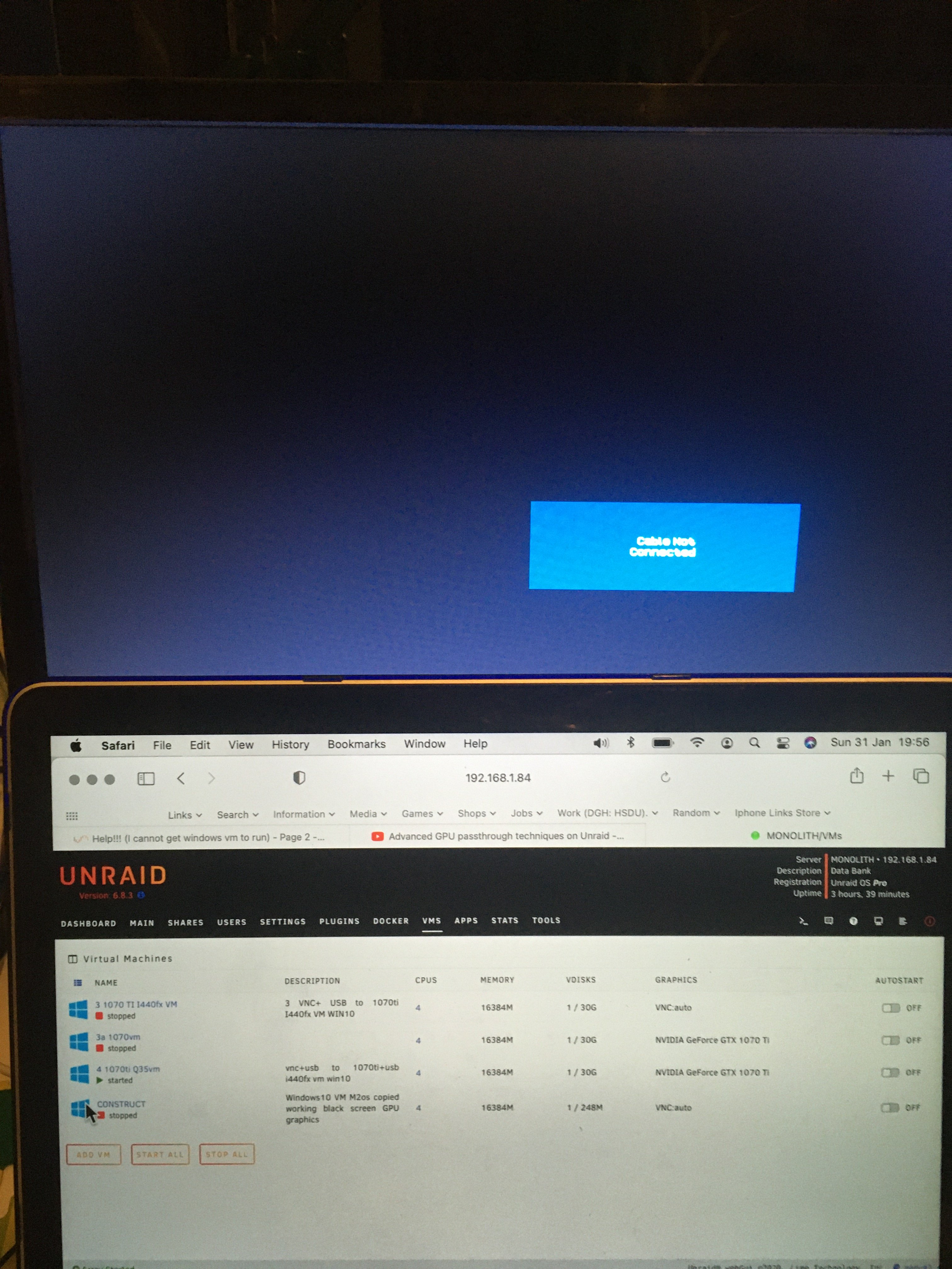

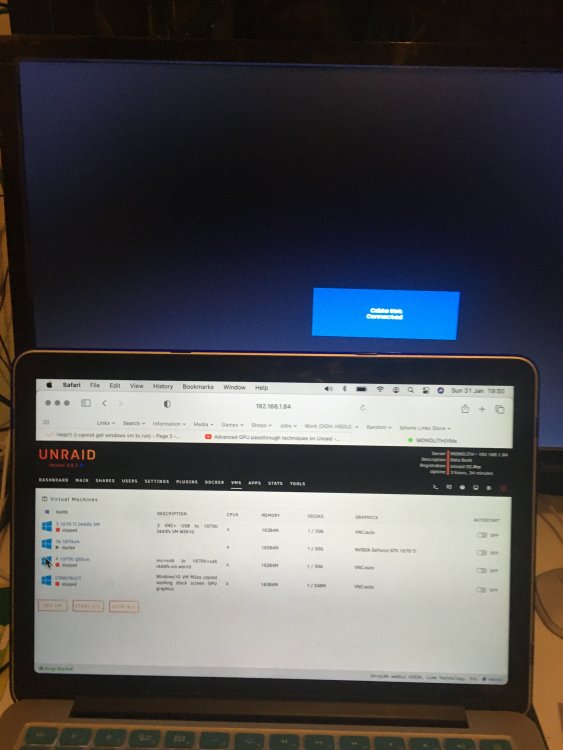

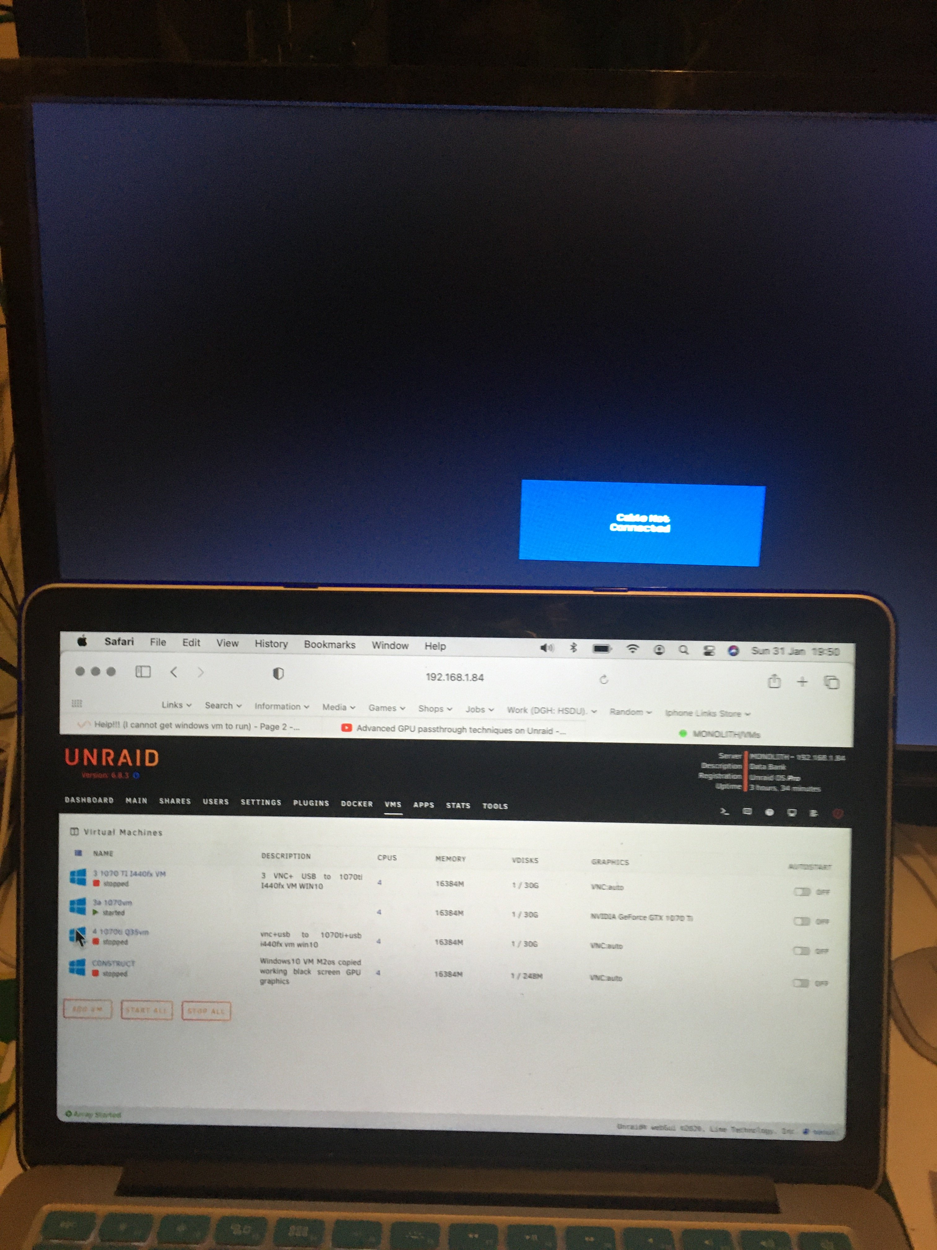

VM 3 still froze the webgui when I tried to enter the gpu, (after a restart and an hour and half break)  and so trying to boot the vm with VNC worked but with the gpu it was a none starter. I had to set up a new Windows 10 i440fx vm with the gpu added in from the get go, but the screen didn't see a signal and it is plugged and working correctly, so the gpu didn't generate a signal and so I didn't get a chance to see the windows installer and the keyboard and mouse where powered on which are connected to the usb card.
VM 4 responded and applied the GPU to the vm. This is after a server restart and leaving it at 6pm and returning to it at 7:30pm.
but the same thing occurred as vm3a the gpu was passed through but the video was not detected by the screen.
for VM's 3 3a and 4 the screen popped up the cable might be unplugged message when the vm was booting into windows oddly the keyboard and mouse that where plugged into the usb card did not power on ether? which it did when on VNC??? So the GPU VM's failed.
the changes I made to the vm's to passthrough the gpu was select the video form the dropdown menu the same with the sound.
I added the card bios edited rom via a hex editor deleted the flashing header from the file and resaved it under a different name and it is stored in the iso share.

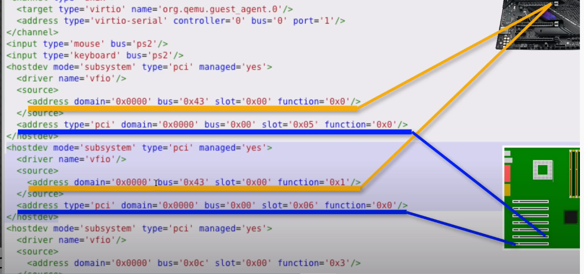

I also made sure that the sound and graphic parts of the gpu where on the same slot and was set to multifunction (multifunction='0n'/>)
and the function was set to graphics as 0 and audio was 1. and then clicked on update and proceeded to boot the VM.

And the check and slight edit of the vm's code to make sure both are using the same slot in the virtual pc.

Hello
1st Hello.
to answer this point. yes I did do with the amd card when I was trying to put all three passthrough hardware I tried an all VNC vm.
What about with the NVIDIA card?
what I was trying to here this is way, way back around the time that I started out working on the VM part of the PC.
I had to vm's on the go one had the AMD card, the m.2 and the usb card. The other vm was all VNC with no passed through hardware
the hardware no surprise now failed, but the  all VNC did.
Now to answer your question. Yes I have when I when I got the card I started with an i440fx win10 vm with USB pass through.
then I added the m.2 cloned the vdisk drive to the m.2 and put the clover image in the location of the original vdisk, this is when I recently reported in that I have managed to get the M.2 disk working for the 1st time ever! Then when I added the new Nvidia 1070it to the mix, this is when I got a none booting black screen even tho the Bios rom (that i edited to remove nvidia's header )was passed through. which was a blow due to I was so close yet so far.
Now to further add:
out of the four VM's that I tried most recently, since I did not know which machine type to use.
I had an VNC ((1) being i440fx v4.2) (2) being an Q35 v4.2) with only the USB card passed through and these where the Vm's that booted even after a few server restarts.
I7 was the highest class of intel's cpu's in the consumer side at the time, as I am not familiar with the server/enterprise side.
and the 7700K was new at the time I started putting the plan into action.
Totally fine!  7700k isn't the issue here.  The CPU works for virtualization and pass through as I have one in one of my test systems at home.
the other Vm's (3) being the i440fx v4.2 with the USB and the Nvidia card, this VM was fine to setup the VNC part the day later when I added the Nvidia card the webgui froze mid change and he screen(web interface) was stuck and when refreshed the nvidia card was not applied. so scarped that vm and tried again same settings but name 3a. VM 4 didn't remained frozen and the card was passed through but this VM type was Q35 v4.2. the outcome was still the same the black blank screen. Agreed.
as you the hardware pass through vm, didn't work but the all VNC did. then I passed the USB card through and it works like it has on any vm since.
So passing through the USB card works on any VM you try it with, correct?  No issues after reboots of the VM or the host?
Yes the USB card didn't seem to be an issue with the VNC but the Passed through GPU VM's where not booting with the Nvidia card.
but the USB still worked when I had the AMD GPU installed and with Q35 VM's i was able to move the mouse and interact with the keyboard that was connected to the USB card..
it just seemed odd that there seemed to be a time limit before the VM locked up (when a GPU was passed through) or when I was installing the GPU driver the moment it started to install the GPU driver the screen blinked then went black.

Unfortunately when it comes to hardware recommendations, we only can tell you what we've personally tested and used, which I have.  Anything outside of that and you're relying on the community to help you.  I would consider posting in the Hardware forum and instead of talking about this issue you've been having, simply describe, in as few words as possible, what you want and ask for some hardware suggestions.

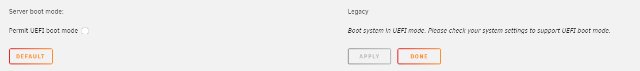

Did anything progress after you got switched to booting in Legacy mode?
Okay, I get that. It is just trying to get a couple of fall back sugeestions.
Due to the only gigabyte board identical to yours, that I could find is a refurbish one over in africa selling on ebay but as a combo deal as it is being sold with an I5 7400, which is not required here, since i have the i7 already. it is being sold for £250 plus an additional £50 for P&P.
I also had a quick look on you tube as well which didn't return to many hits for 7700K and unraid, the main hit was an old linus video where they where doing someething simualler to me but with half the drives. the thing that got me they talked through a simple array setup and a simple Vm setup but they didn't show the screen they where more intend shoewing the tow working on the sytem which blocked the cameras view of the screen, which makes me thionk what aren't they showing to get the vm to work?
the board the they used was an Asus Z170 deluxe, and I recall you saying that you and others had issue with Asus boards around the time, so I am not to sure if this is anopther possibility? but they where a few of these boards oon ebay around the £150 mark and one a for a lot more on amazon currently.
I also had a look at the others vendors that feautred the Z170/270 and with 8th gen Z370 and the same H chipset in your board. I know you said same chipset but differing vendorss, different implermentations. I was hoping if any rang a bell either good or to stay well clear.
and if you could pass a link to the hardware forum, please?
I have tried the same vms that where created when the system was in EUFI boot, and yet the same outcome VNC graphics still work, but the passthrough graphics was still resulting in black blank screens and on this montior triggered the cable is not detected screen, which it was just that there was no signal.
but, I also found that over setting you orginally mentioned that I have not even heard of before, the above 4G encodeing, I had to goolge what is function was and i have now have that enabled too. but i havew not had chance to see if it has any impact on the passthrougfh GPU. My honest gut feeling is that it will still be VNC graphics yes, 10170ti no.
but I hope i am wrong here, I we llet you know as soon as I test it out.
Thank  you for getting back to me
Just a quick note, have you tried ALL the different video outputs on the card you are trying to pass through? Sometimes the video card only activates one specific output.
As jonathanm stated, trying all the various inputs is another way to go.
Another thing you can try is to get the VM fully set up with VNC graphics.  Then install some type of remote desktop client in the VM.  Then switch the VM from VNC graphics to your NVIDIA card and start the VM.  Even if the monitor is still black, you should be able to connect in to the VM using a remote desktop client (either teamviewer, realvnc, or any other platform you're comfortable with).  From there, you can see if there is an issue with the driver loading or not.  If the card shows present in device manager and driver loaded, but the screen is still black, again, try what jonathanm suggested by utilizing the different inputs.
If none of that works, I really don't know what to tell you from here.  Clearly we have an insane amount of users that are utilizing GPU pass through in VMs.  There are countless youtube videos of folks having great success with this.  I really don't know what's unique or wrong with your setup to prevent you from making further progress.  I feel like you're problem missing something somewhere.  Did you try enabling the VFIO allow unsafe interrupts option on the VM Manager page (turn on Advanced View in the top right to discover that)?  I doubt that's the issue, but if it is, you'll need to turn that on, reboot, and try again.
UEFI booting the base OS has been known to cause issues with VMs and GPU pass through, but now that you are in legacy boot mode (which btw, you need to configure in your BIOS as well), everything should be working.

I see what you mean about outputs, on the old monitor that I did have developed a cracked screen. So I having to make do with a borrowed screen until the end of the month when the replacement should turn up. but I am a little stuck as the screen is VGA, DVI and HMDI.
the graphics card is three display ports and 1 HMDI. So I only have the HMDI to work with at the moment.
I would of thought that output would work as the others are not in use.
all i have is VNC viewer on the laptop to view the VNC graphics but soon as I change to the 1070 that VNC function ends.
I have used team viewer the free version and I would be stuck since the program changes the alphanumeric code after each boot I would do see the new code to connect to it via the remote connection.
The unraid server says it is booting up in legacy mode, I remember going into the legacy option and giving priority to the USB key in that menu.
with the unraid os saying it is booted in legacy mode. I think i must of done something right.

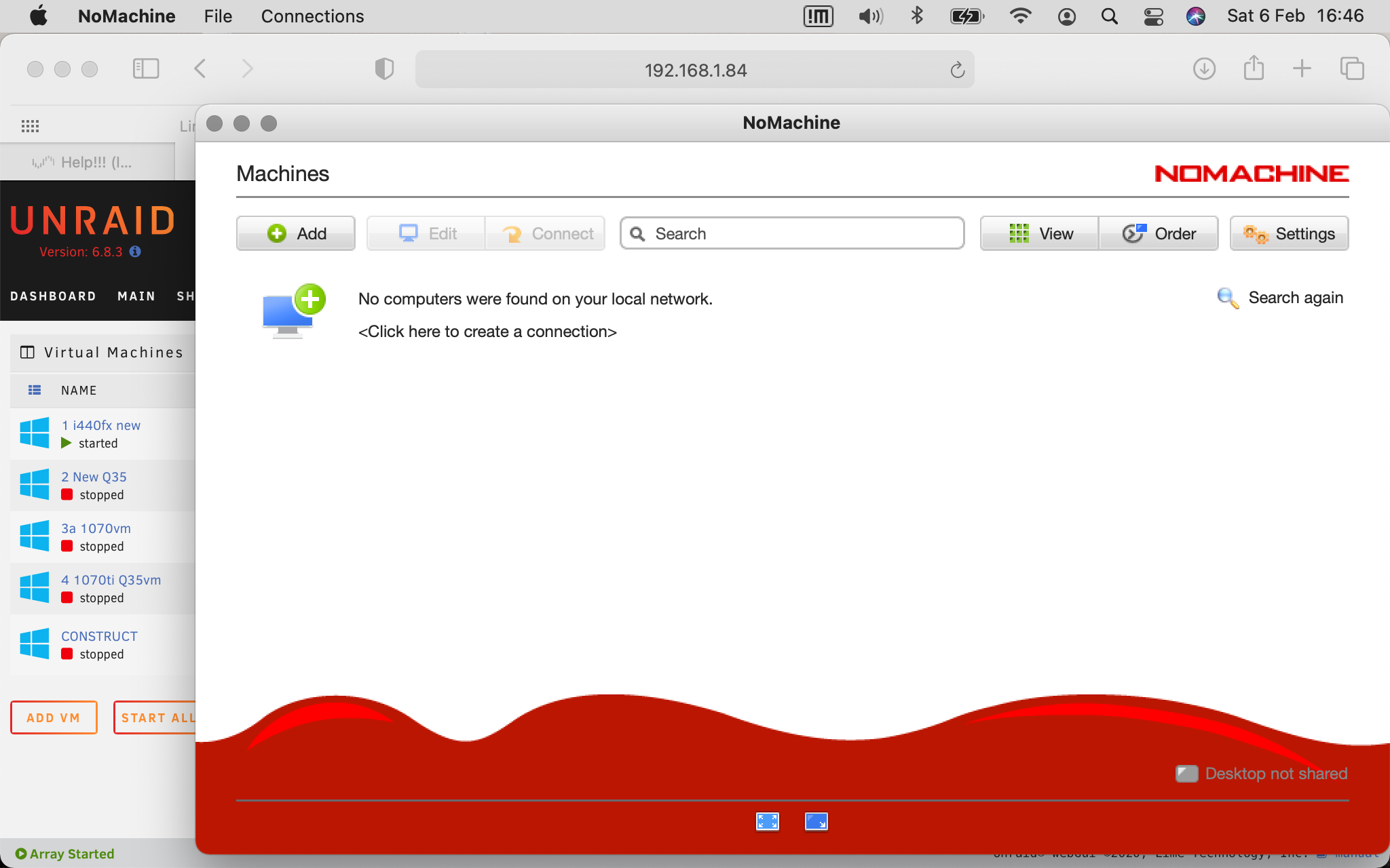

just made the new i440fx and q35 vm and just installed no machine on both.
now it is time to and the 1070it to see if that works.
Hello.
I have added the video card to the vms and the machines both started so the web gui is showing but they are not appearing in no machine and nothing through the HDMI cable ether. just like before but they should display on the nomachine? if this is the case what can be causing the unraid to think to s working but the machine itself is not booting?
this is now what i see
Did you verify that nomachine was working properly when the VM's were running with VNC?
Hello.
Yes I did that i installed on vnc using vnc veiwer shutr the vm down and started it up again and logged in with nomachine.
and it worked. So, power down and added the 1070ti ande powered on the vm unraid webgui said it was running but not video and no machine in the nomachine's main window. :(
I have done this for both the new vm's the i440frx and the q35 both v4.2 and the only other thing added to the vms was the usb card, (vm's are labelled 1 & 2 on the above pics).

I have got it booting in Legacy now rather than the EUFI
Because the VM's work with VNC Graphics accesed by real VNC and nomachine, but soon as I added the 1070ti to the either VM. The outcome being, there is no video signal. When I try to acess the VM by starting up the nomachine program, the VM's are not displaying in the main widow of the program. So the VM's are not acessable or veiwableb through the passed through hardware or remote access, when a GPU is passed through???
