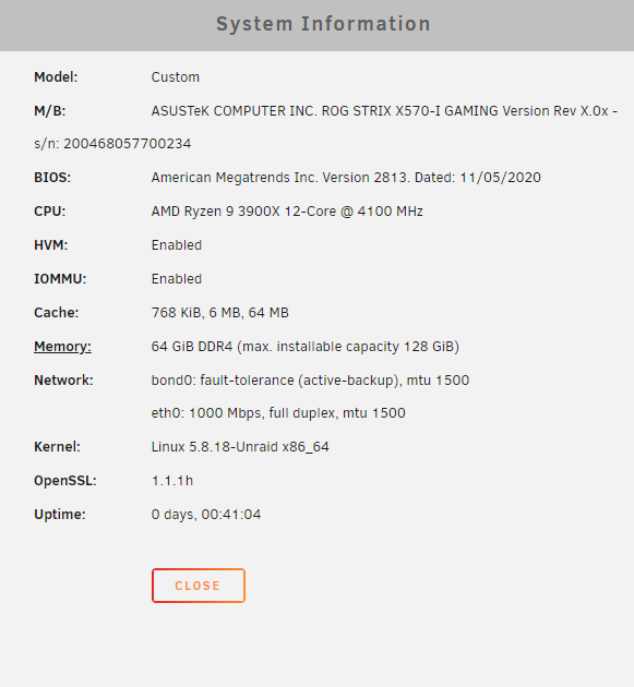

Specs:
Motherboard: Asus rog strix x570i
CPU: 3900x
GPU: PNY XLR8 RTX 3090 UPRISING EPIC-X Triple Fan
RAM: G.SKILL TridentZ RGB Series 64GB (2 x 32GB) 288-Pin DDR4 SDRAM DDR4 3600 (PC4 28800) Intel XMP 2.0 Desktop Memory Model F4-3600C18D-64GTZR

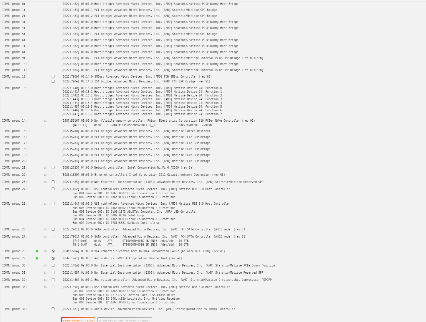

I've followed SpaceInvader One's videos to get the vm started. The card is outputting to a monitor but I am receiving error 43. I tried to follow this guide but this method seems dated. [GUIDE] Fix Nvidia Code 43 Issue on Nvidia GPU - VMs - Unraid
The kvm patcher is no longer being maintained and is not compatible with newer nvidia drivers, this is a problem with the new set of cards.
I tried booting for UEFI but it stopped my card from outputting completely.

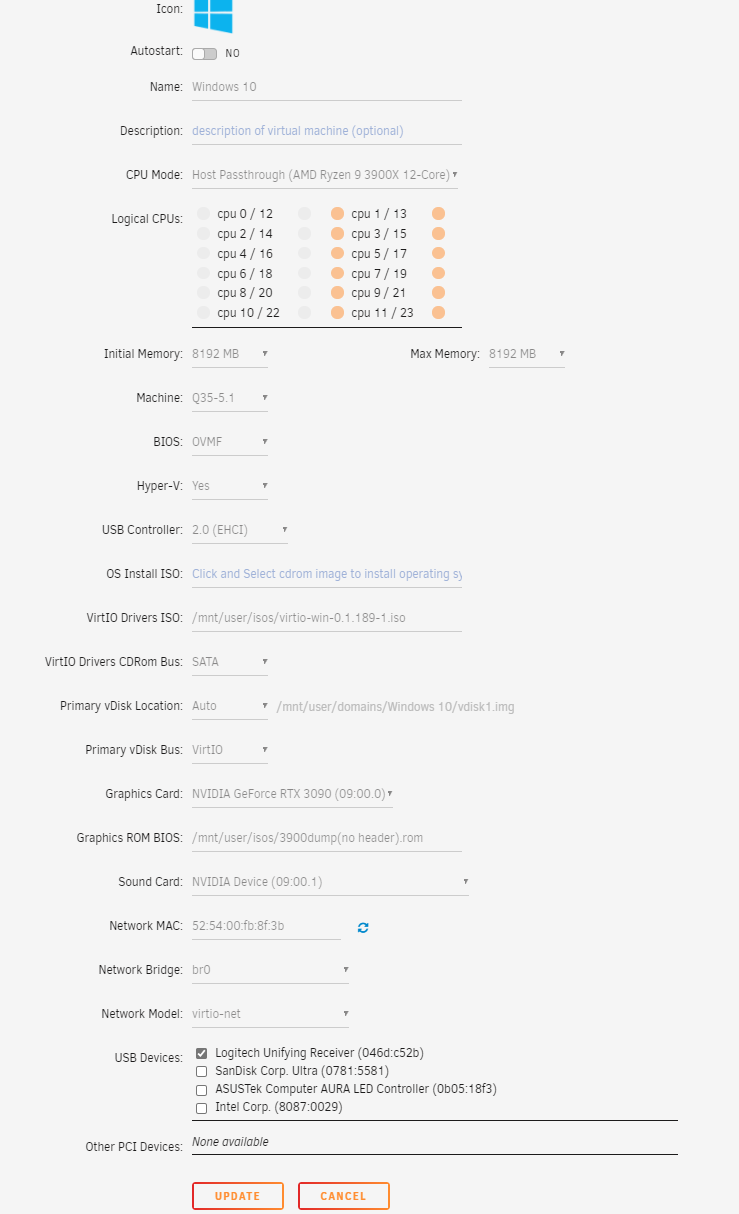

I've tried turning hyper-v on and off. This is my config
I've been battling with this for a while and could really use some help!

Have you got all parts of the 3090 card selected in iommu/vfio sound any usb etc...
I've selected the sound and video controllers. The new cards don't seem to have usb.

Can you post your VM xml so i can look at it.
 @Juxsta
Yeah here it is. Let me know what your thoughts are
windows-vm.xml
You checked both the videos, followed all the instructions and made sure to pass through the sound devices exactly as advised also?
Yeah.I’ve dumped the v-bios using a different computer and passed in the rom file via the GUI. (Looks like the translated XML is the same as in the video). I setup the virtual machine using the most up to date options posted on your guide. I passed in both the Audio and video devices and made the respective changes to the xml as noted in the second spaceinvader video and your guide. I then continued to install all the drivers using virtio, but once the gpu installs its drivers, it immediately registers error 43.
I could definitely be missing something so please let me know if there’s anything you can think of that I missed.
Is slot='0x00 being used more than once? Virtio-net, virtio-serial and gpu looking at it.
@Juxsta can you post your full XML in a code block?
I think your USB is not being passed through.
Edit: Nevermind, saw that you did already.
Edited by KptnKMan
Ahh I didn’t realize that virtio devices also need a slot. Would I move it to 0x01?
Looks like you can't modify the slot number of a pci address past 0x00
Edited by Juxsta
Just try putting the 3090 on 0x05 or something not in use, make sure not to change the part that is physical slot, first part i think it is. only change the virtual slot. check video space invader explains the difference.
Try this one. I think it's correct.
windows-vm.xml
I get this error when Trying to use that file.
Looks like it wants the GPU to stay on slot 0. I'm getting similar errors when changing the slots for the virtio devices
Edited by Juxsta
Hmm ok. getting thin on idea's now. Have you tried working config without a vbios rom and see if the drivers install/load without error.
Edit: I say that can't remember if you even got windows setup or not?
Edited by turnipisum
There is no video output when loading up the gpu without a V-bios. And my windows VM is working, it's just throwing error 43. Saying the device was turned off because it wasn't working properly.
Yeah, I've been working on this for a while now. I've also messaged limetech support directly but they were unable to help me as they have been unable to get any 3090's on hand. The rep did say that it could also be a brand specific problem. If all else fails I do have an rtx 2080 evga card in my other rig, but i'd really rather not swap them.
Edited by Juxsta
