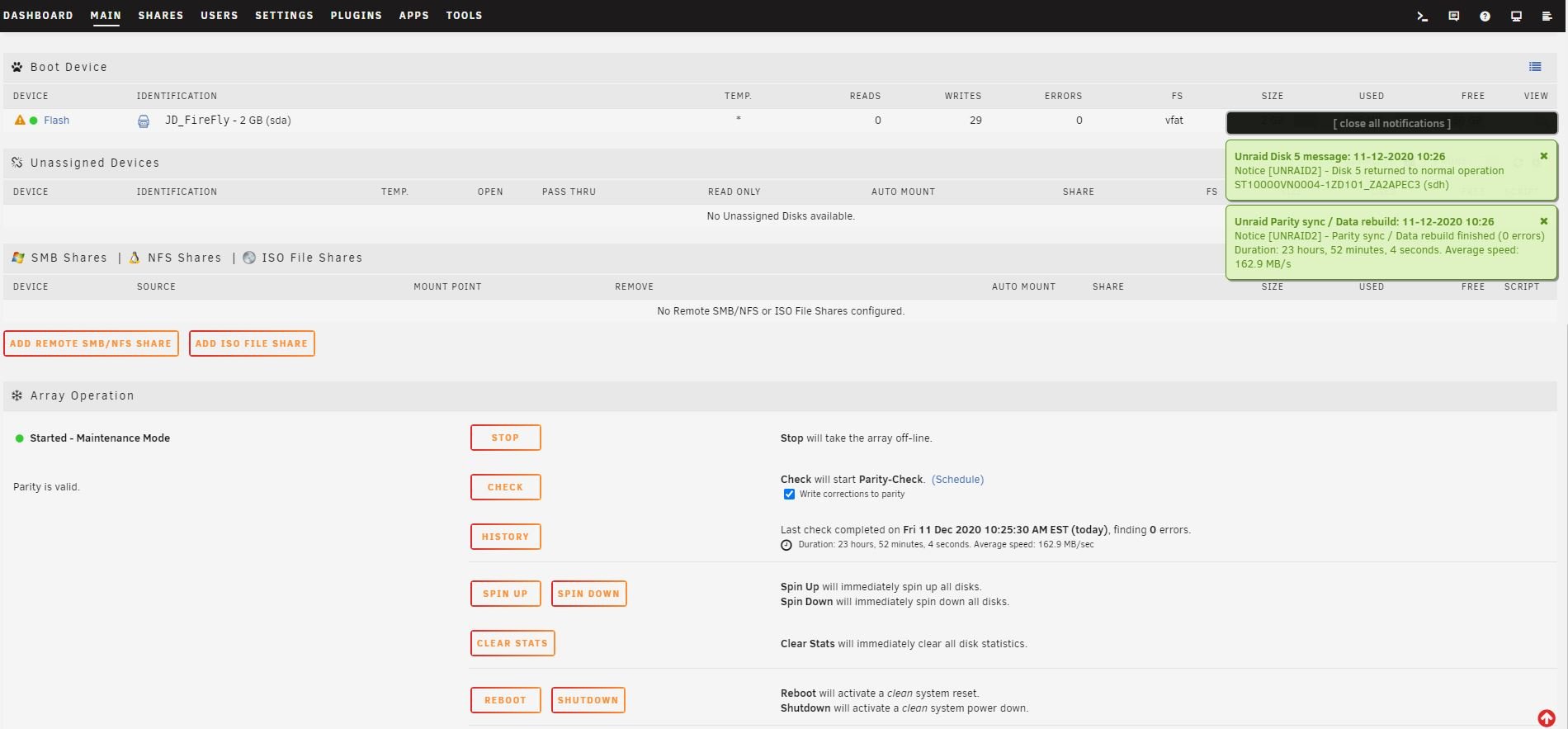

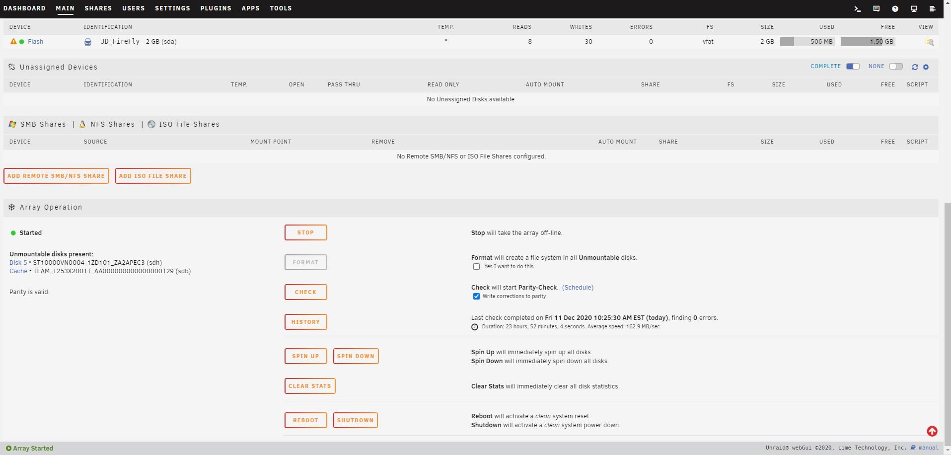

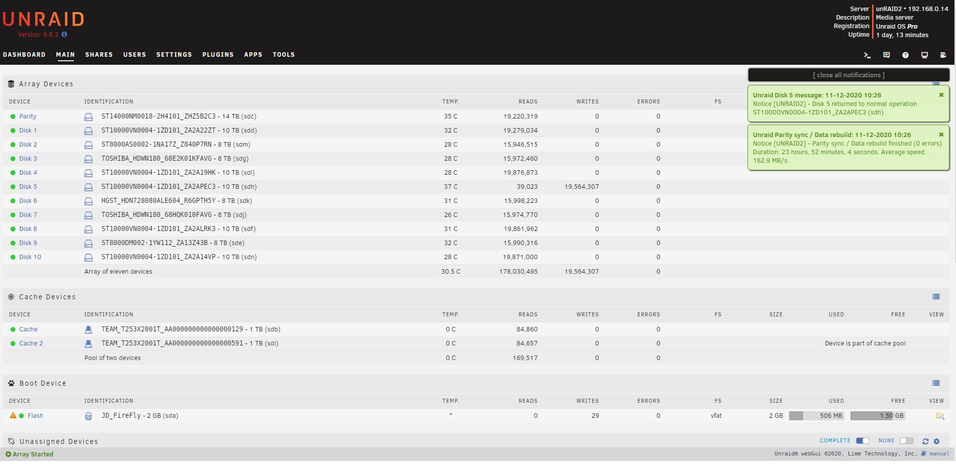

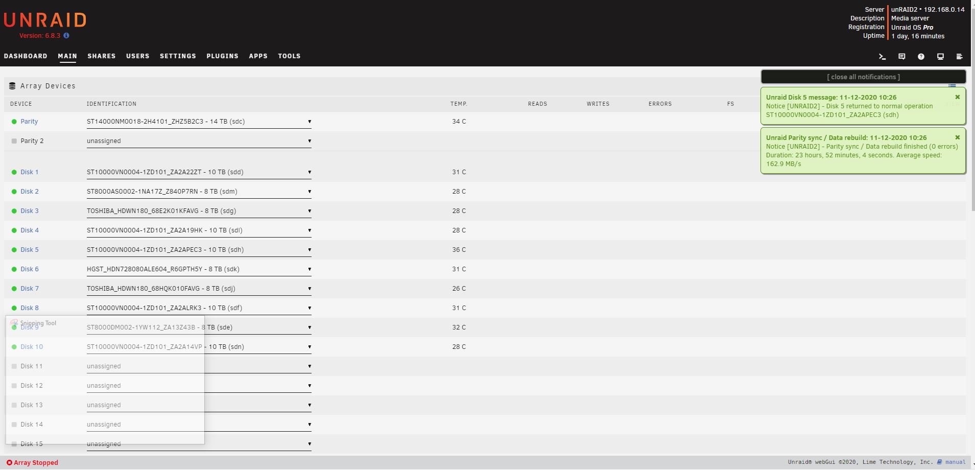

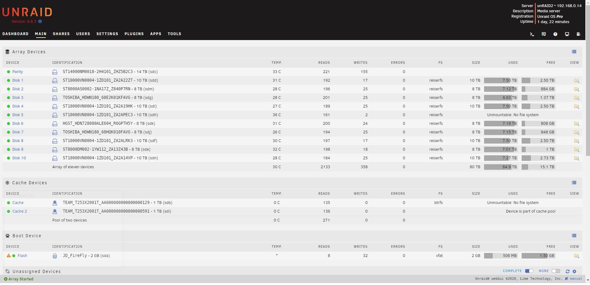

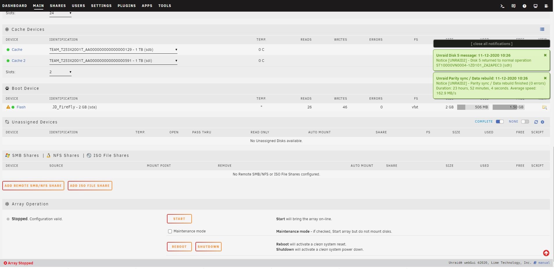

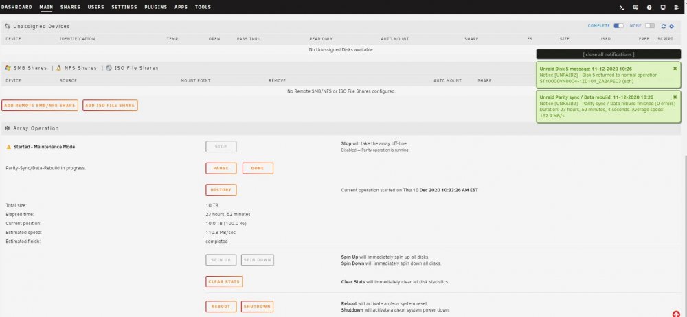

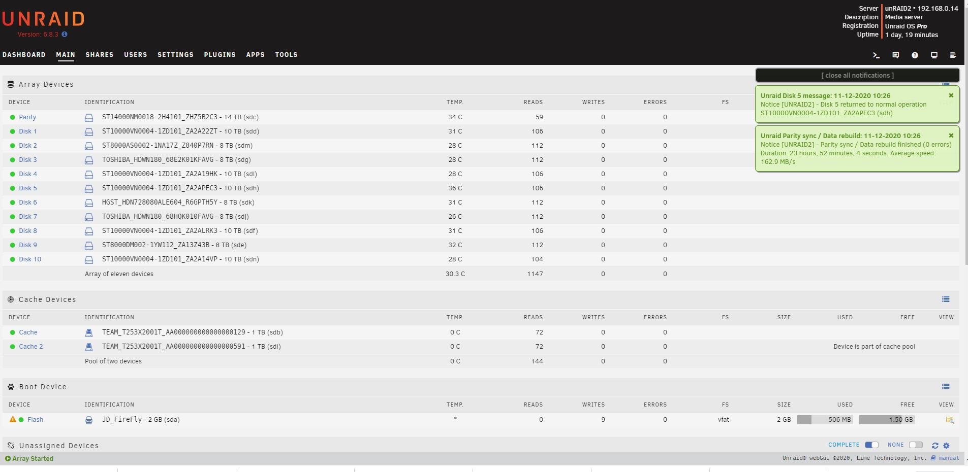

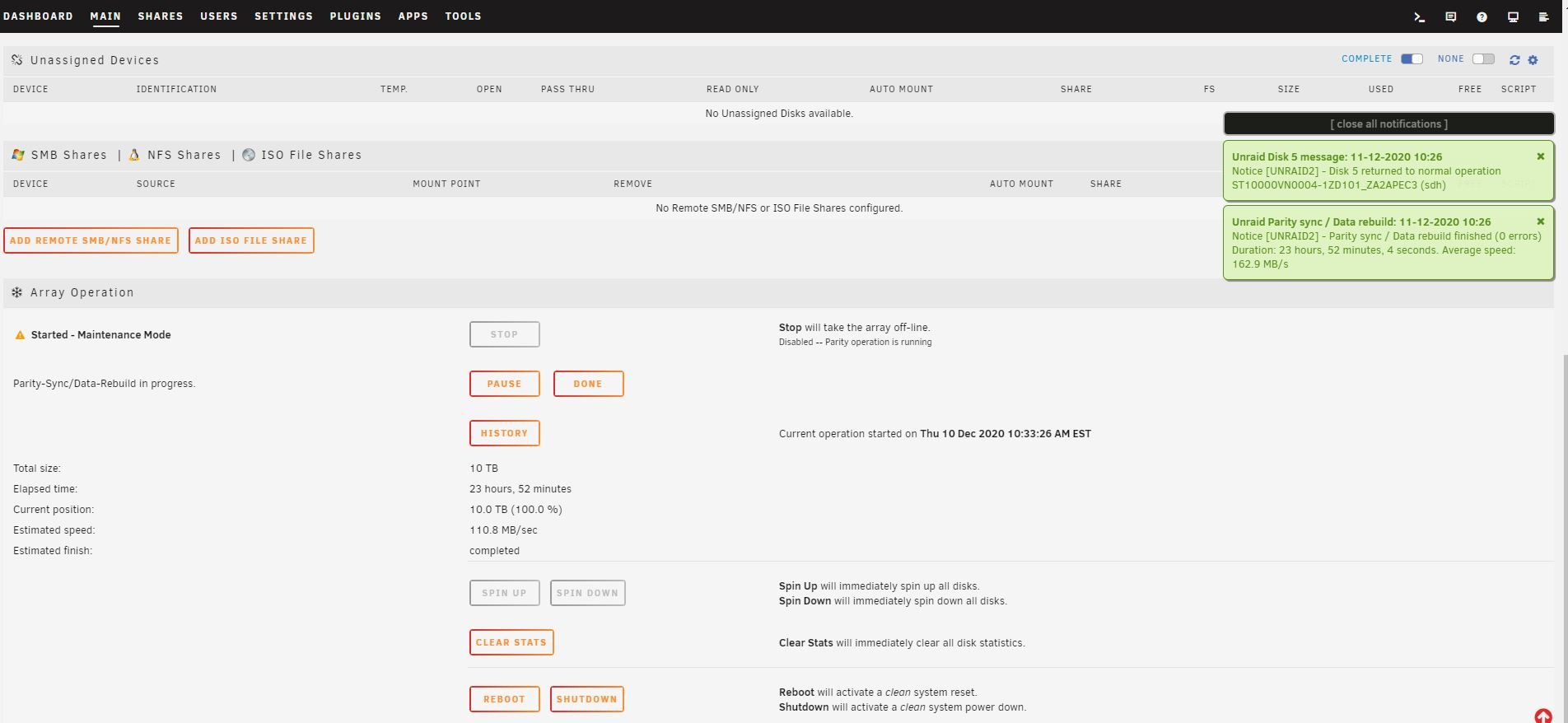

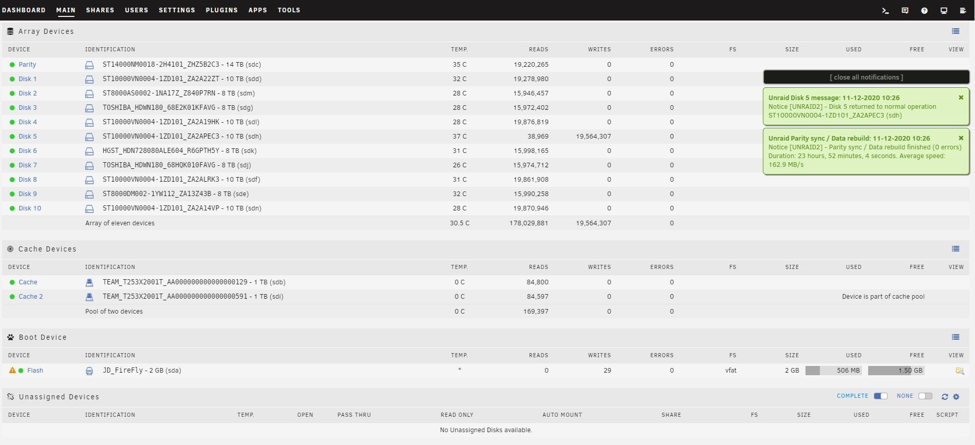

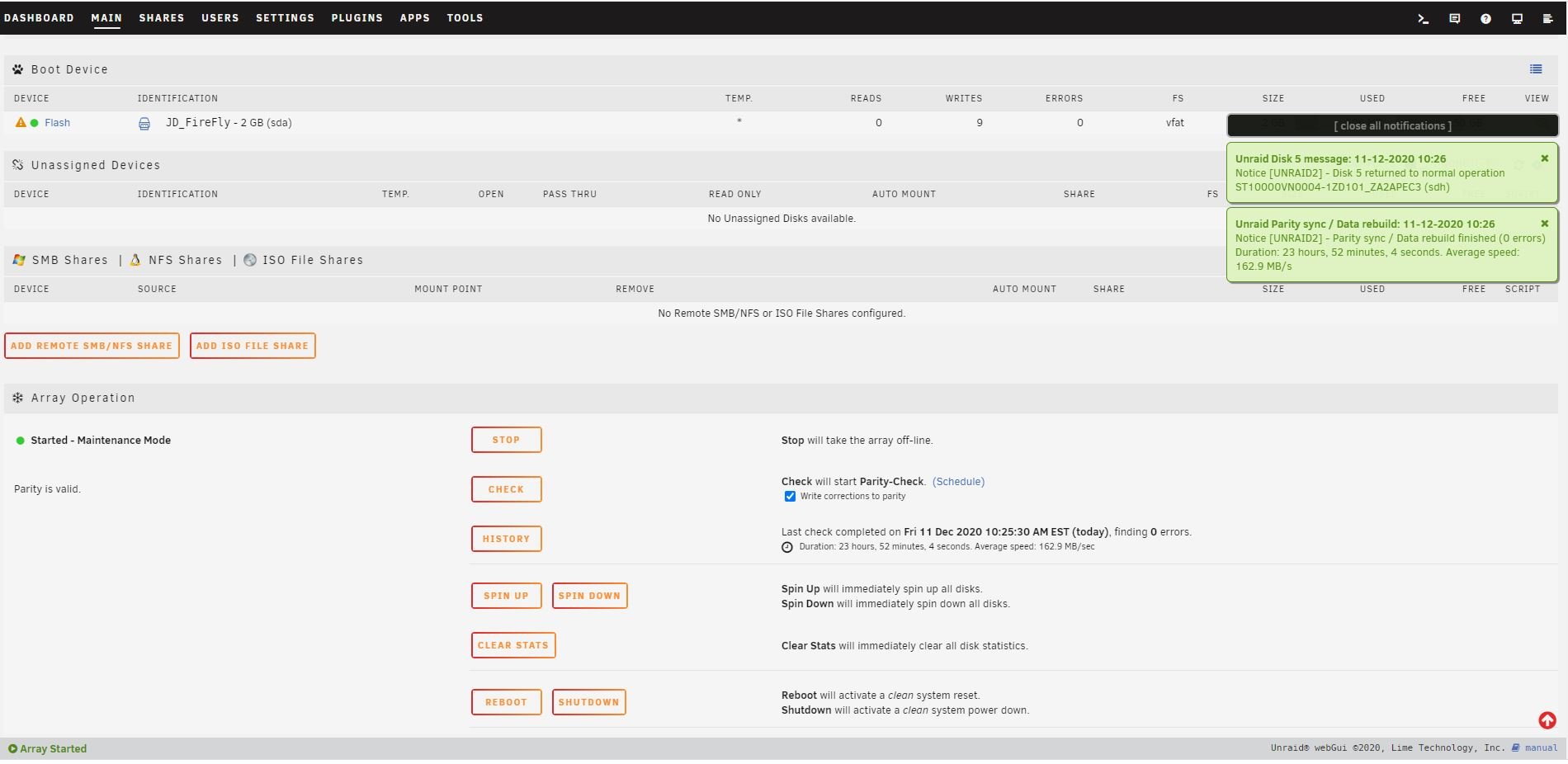

I have replaced / rebuilt a data disk three times now and after each parity sync which appears to run successfully I end up with a message after starting the array that the disk is unmountable with no file system.
This all started with data disk5 showing a lot of read errors. It was an older 8TB HGST drive so I swapped in a newer Segate 8TB and synched parity. That rebuild worked fine but the new drive also experienced read errors.
Having planned to increase this server's capacity anyway, I purchased a pair of Segate 14TB drives and replaced the 10TB parity drive with a 14TB drive and rebuilt parity. That appeared to run without issues so I swapped out the Seagate 8TB disk5 for the previous parity 10TB drive and rebuilt data. That resulted in my first unmountable disk.
I stopped the array, unassigned the 10TB disk and moved it to a previously unused SATA port. Restart the server, assign the 10TB disk to disk5 and rebuild data. Again, after appearing to rebuild successfully I end up with an unmountable drive.
So I swap the SATA port & cable between disk5 and a cache pool drive and rebuild a third time. Same result with disk5 (unmountable) but now the cache drive is also unmountable.
I downloaded diagnostics after each step and am attaching those .zip files.  I also took screen captures of the Main page after each step in the parity sync / restart process and will attach those .jpg files.
I realize now I should have probably saved the original 10TB parity drive intact and rebuilt disk5 on the other new 14TB. I am concerned that the unmountable disk issue is due to something happening with the 14TB parity drive swap. So I am tempted to rebuild parity with the original 8TB drive but need to know if I can trust the original 8TB disk5's data.
Is there a way I can check that drive to see if it's data is intact? I have the Unassigned Devices plugin but don't know if / how it can be used to do this.
Many thanks for any advice or assistance.
