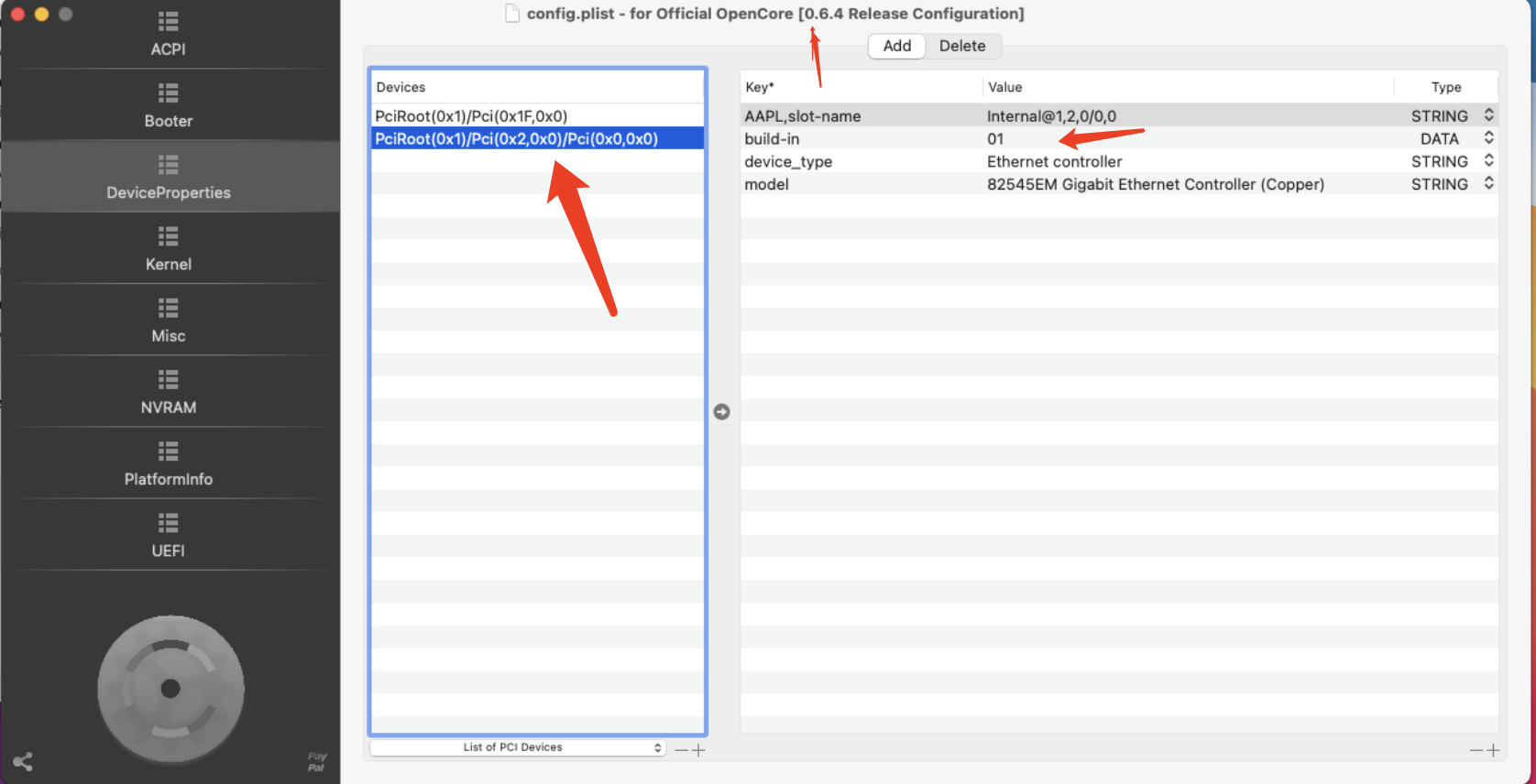

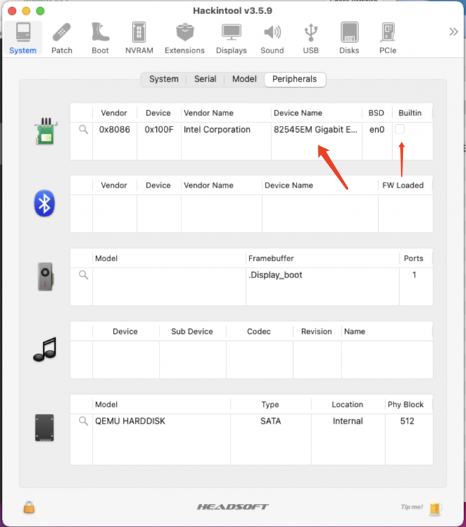

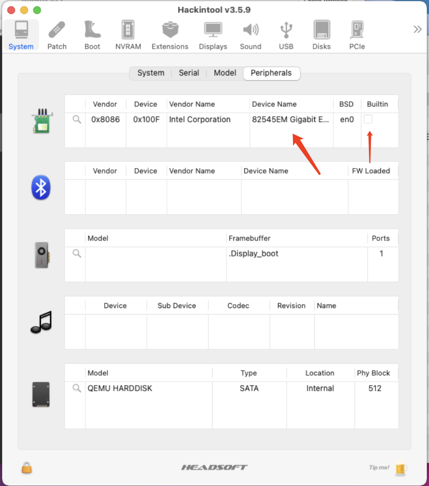

  25. @SpaceInvaderOne I followsed your youtube videos and some github tickets and comments and it lead me here I have sucessfully setup the Mac Big Sur on Unraid, however I just cannot setup the Apple iMessage. it said cannot contact the server when I tried my apple ID. I noticed that even my ent0 was set to build-in = 01, after a few times reboot, the "tick box" still grey out, and leaving "build-in" unchecked. Is there something wrong? Please see the attached screeshots. thanks so much!
