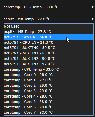

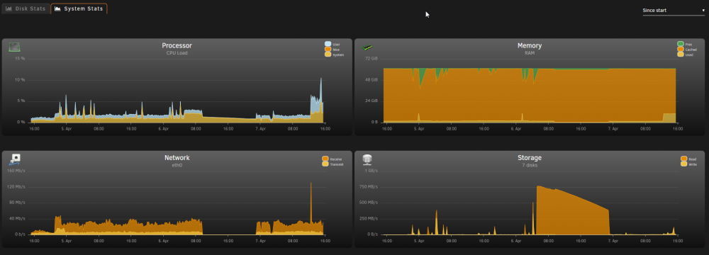

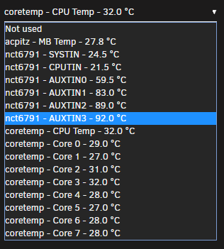

Yeah, I provided IPMI logs, which show it coming directly from the board/BMC, so really nothing to do with the OS/plugin/application side that I am using. I can show my system stats (i.e. how much CPU or memory I am using) via the Dynamix System Statistics plugin, but that is just showing that my system is not under any sort of load that would cause the temp increase. I am thinking the Linux/System temp is just pulling from a different sensor that is not part of the IPMI list. My MB says 27.8C in the Dashboard, but I don't see any sensor in IPMI with that reading. I am not sure where the unRAID Dashboard is pulling the readings from.

Yeah, I would say that is the sensor that is showing the incorrect reading. I see the same temp in unRAID and IPMI. After a couple back and forth emails with William yesterday, he said this "Please bear with me for a few moment. I have escalated this issue to our BMC engineering team along with your log file. Once I have any update, I will let you know." So will see if they come back with anything today.

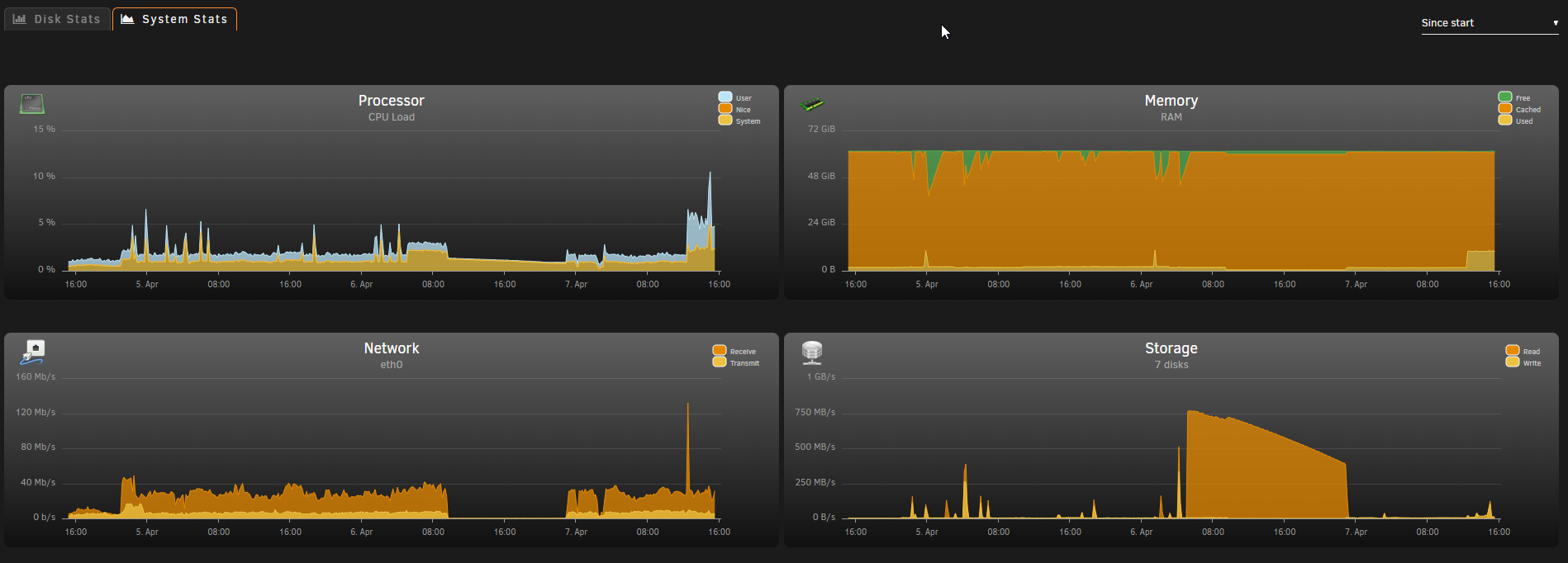

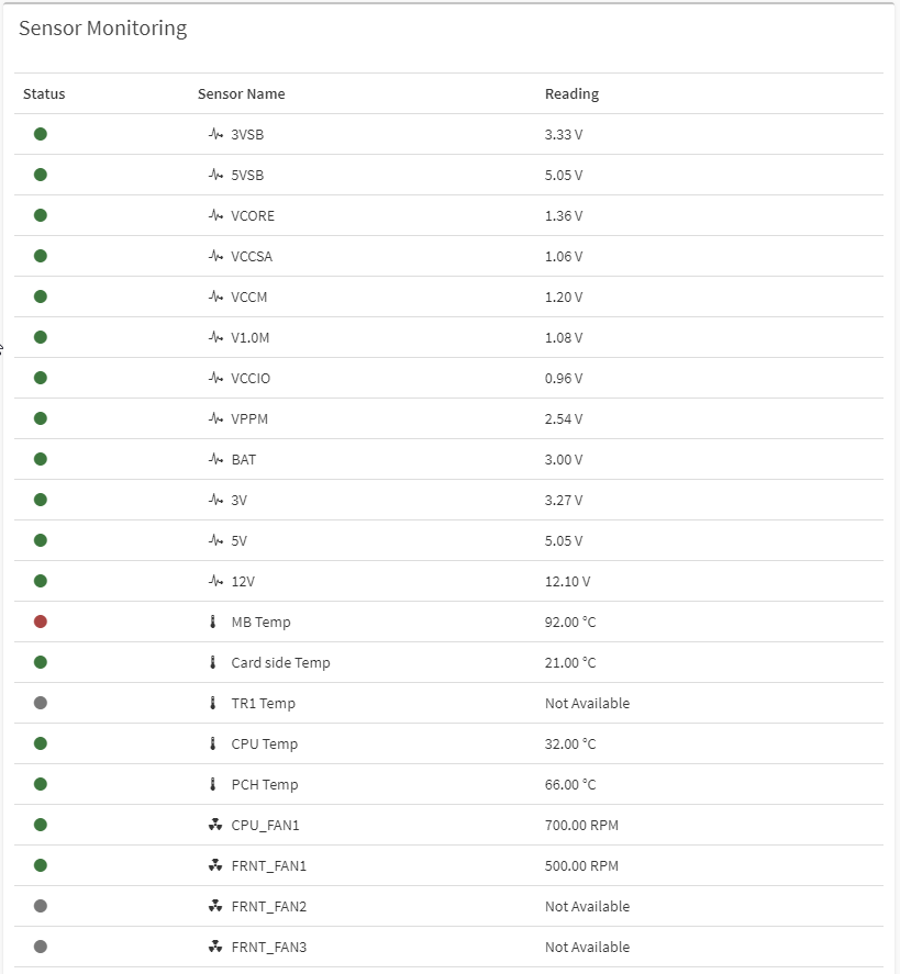

I would say I don't have heavy sustained loads on my server. My CPU typically is lower than 5%. MB temp still says 91C via IPMI plugin and 27.8C on unRAID dashboard.

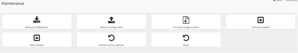

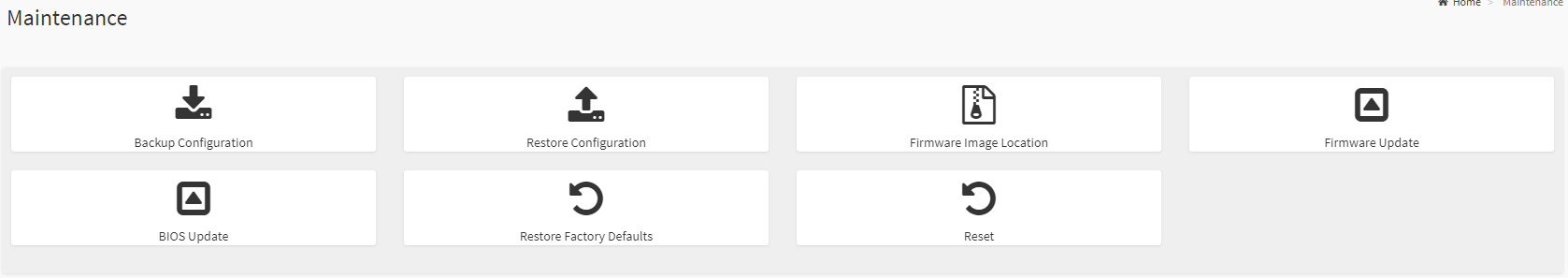

Looks like I am on 1.20, so that may be the issue if Hoopster is on the higher version. Is the update for that in the setup/config/BIOS settings when you boot? I only see this in IPMI maintenance section:

Yeah, I did a reboot of the server and the temp was still high. I took off the side of the case (Fractal Design Define XL R2) and the inside was not warm at all. I know that is no indication of the chip temps. I may add a fan to the side panel. It would blow a bit on the PCH and NVMe I think, and at least help circulate the air a bit more. I may contact ASRock as well if my 'adding a fan' method does not help. Right now I am not too worried about it, but it definitely bugs my OCD seeing the red temp warning. 😄

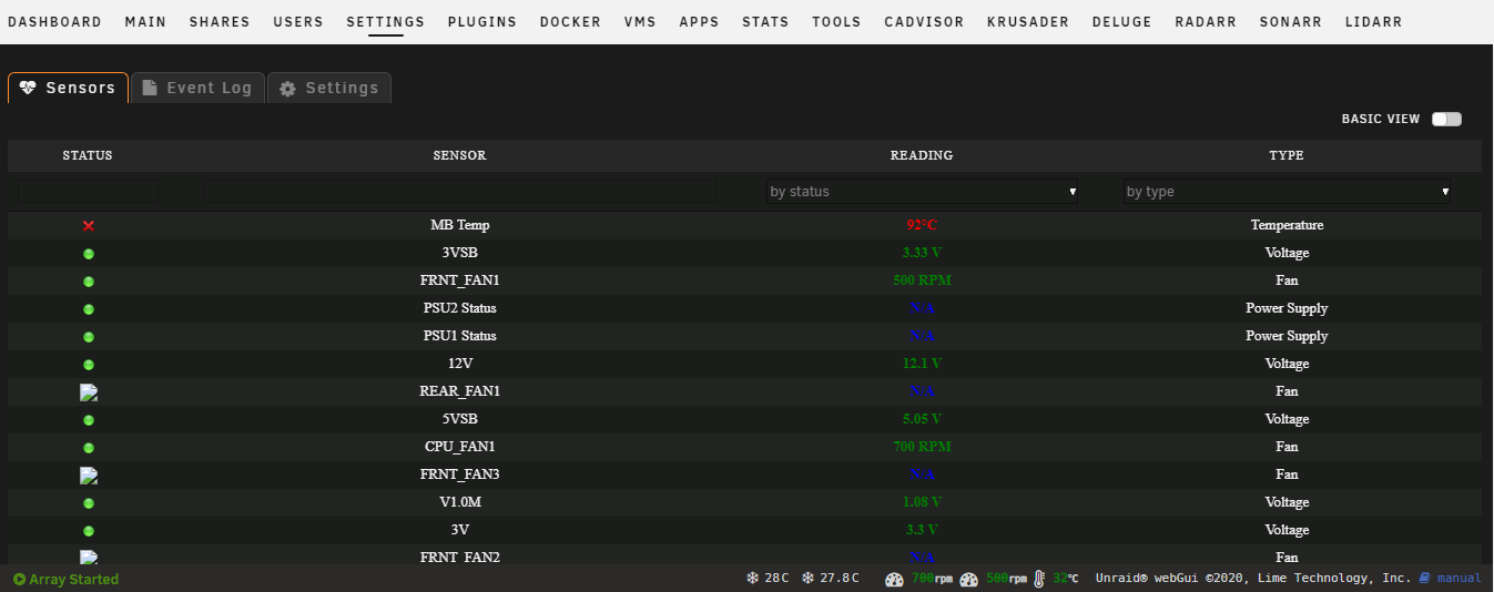

So today I received an IPMI notification that my MB temp reading is 92C. I checked the Dashboard and the MB reading is only 27.8C, which is about where it normally hovers. Has anyone else experienced a difference between the MB temp IPMI states and the Dashboard? I typically go by the temps on the dashboard. Wondering if I have a bad sensor. It has been running fine all day like this, but I haven't seen the IPMI MB temp fluctuate at all.

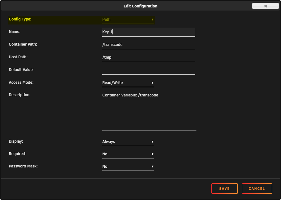

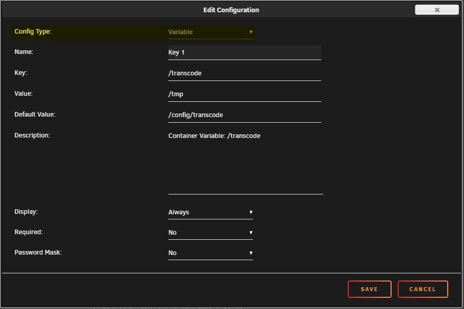

I know it's not the subject of this thread, but I figured out my issue with RAM transcoding. I am using the binhex-plex docker and the transcode directory variable in the default setup was set as a 'variable' and not a 'path' config type. I deleted the one that was there and recreated as a 'path'. Then I started seeing the files in /tmp/Transcode/Sessions. If you notice the 'variable' doesn't have the 'Access Mode' option which might have been the reason. Not sure, but it is working now.
